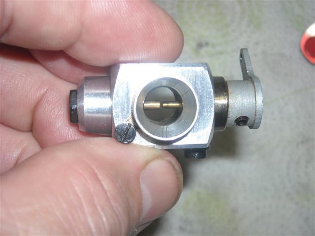

Old 11-30-2010, 09:19 PM
rdubord
Join Date: Nov 2010
Location: North Bend, OR
Posts: 6
Default MDS 48 mid-range issue
I can get the top end tuned in nicely, and then the idle tuned nicely as well. The thing will run both wide open and idle, for as long as the fuel remains in the tank. However, the mid-range is extremely rich. I tried running both the high and low ends on the lean side to compensate, but it wasn't near enough. I found that one of my K & B 40 carbs was close to the same size and installed it. Only got one run in (being neighbor friendly at 8:45pm) and the carb loosened some. During the short run, it was much, much better. I now have the carb mounted better and tight and will run it tomorrow.
Background, I bought this engine back in 2002 brand new and was told that it was the 'newest' MDS 48 with the 'improved' carburetor. Does anyone know of a third 'generation' carb for the 48? Is there any easy mod to lean the mid-range.

Many, many carburettors on model engines, do not meter the fuel properly...
Among them are the older MVVS, many from OS, older Rossi and others.
The top-end and the idle can be set perfectly; and the transition from idle will be nearly perfect.
But if after you set the high-end and the idle perfectly, you try to run the engine in any part-throttle position; the mixture will be way too rich.
And after running at that setting; even for just a few seconds, transition to full-power; as well as down to idle, will be lousy...
It may even cause the engine to conk-out.
Enough fuel would have accumulated in the crankcase, to prevent a smooth pick-up, or drop down.
Trying to 'twiddle' the needles will get you nowhere flat...
A different setting that will make the mid-range leaner/better, will necessarily make the idle mixture too lean...
If this problem is encountered, a master can 'recurve' the low-speed needle's taper, to allow it to be closed further; leaning the mid-range, without causing the engine to lean-out at idle. Some manufacturers (MVVS) sell needle-nozzle sets to get this effect.
For anyone else, a better replacement carburettor is in order.
I can recommend those made by Perry, Super-Tigre, the new MVVS, the new Rossi and Enya.
Some will need to be made to fit the target engine.

Earl, if I could hazard a guess, I'd say that somebody turned the LS needle in too far. The MDS LS needle has a blunt taper and if leaned too far will bellmouth the end of the spraybear. Then you get exactly what has been described here. When set in the ideal position the LS needle will be about 1/32nd" from the end of the spraybar at full throttle.

I am going to look at the carb again later.
I had swapped it out for a old OS 7B carb I happened to have extra. The engine ran really well off the OS carb. So i had put the MDS carb up and didn't bother with it after that.
I'll take a look and see if I can get it apart and see if maybe I can swage the tip back down a little or not. I don't mind messing with something that doesn't work already.
