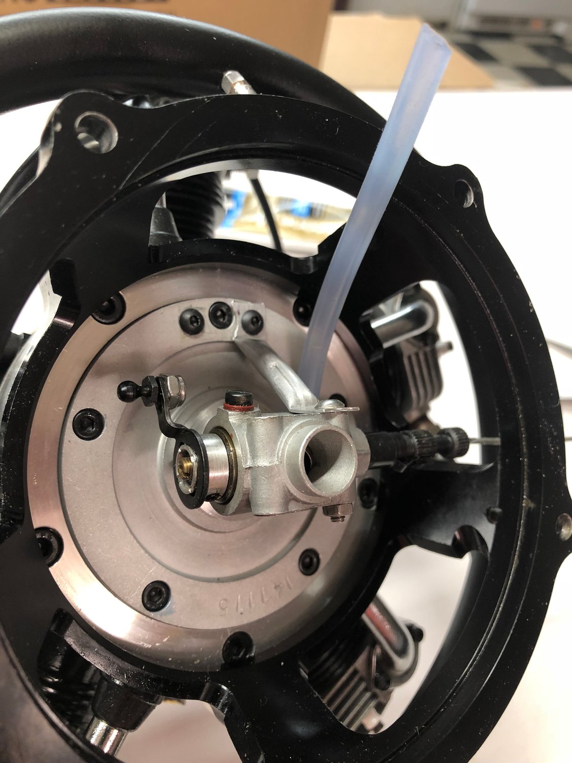

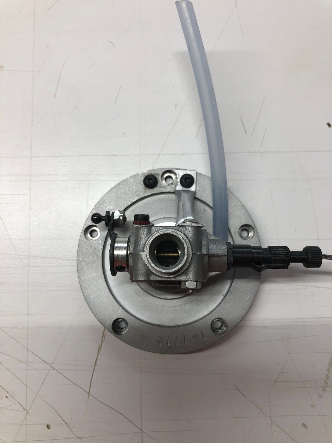

Received 6 Likes on 6 Posts
Yep, read it myself a few years ago on one of these threads :-)
Borrowed the the carb from my os91FS powered vario helicopter 4 stroke engine, and put it on the radial.
It did not run different, but it was easier to tune.
As you can see, it was easy to remove and test on the radial :-)
I purchased a used OS FS-91 carb a while back. I am just now installing it and I noticed a big difference in the low speed mixture screws on the ASP vs OS carbs. Just like in your photo here Sonny. The ASP carb screw on mine is backed out the same, and the slot in the mixture tube is fully exposed. The screw on the OS carb is in quite a bit, as is yours, and it covers up half of the slot in the mixture tube. This is quite interesting to me.
