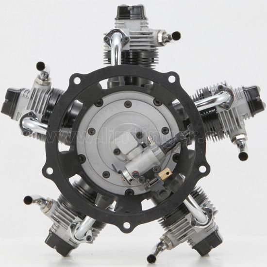

Old 10-15-2019, 07:47 AM

Could someone tell me where the starting settings are for the low speed needle, Thanks

Just fire it up and go from there. Its impossible to set it without the engine running so give it a spin and find yourself a long screwdriver

Yea, the ASP carp is not really a masterpiece in engineering :-)
Set the high speed needle about 2,5 turns out. Open the throttle so the gap in the opening in the throttle body is about 1mm.
Then hook up a piece of silicone onto the fuel inlet. screw in the low speed needle valve completley in. Blow into the slilicone line, and begin to loosen the low speed screw/needle until you can begin to feel air going through the carb. Here it should start and run ok to get it adjusted.

Posts: 30
I was cleaning and screwed the needle valve in until it became un screwed and the o ring showing. I then screwed it out until it stopped and back in about 4.5 turns is that close you think?

Received 5 Likes on 5 Posts
Your carb is all wrong. It is missing the correct mounting section, and probably is sucking air and will be hard if not impossible to tune properly. It should like like this:
