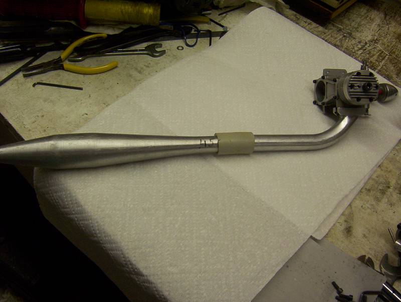

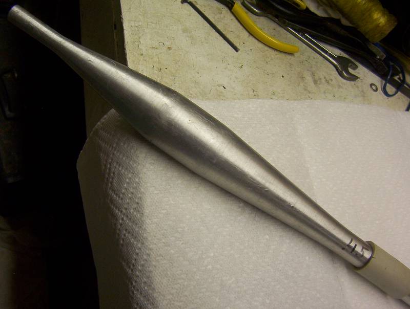

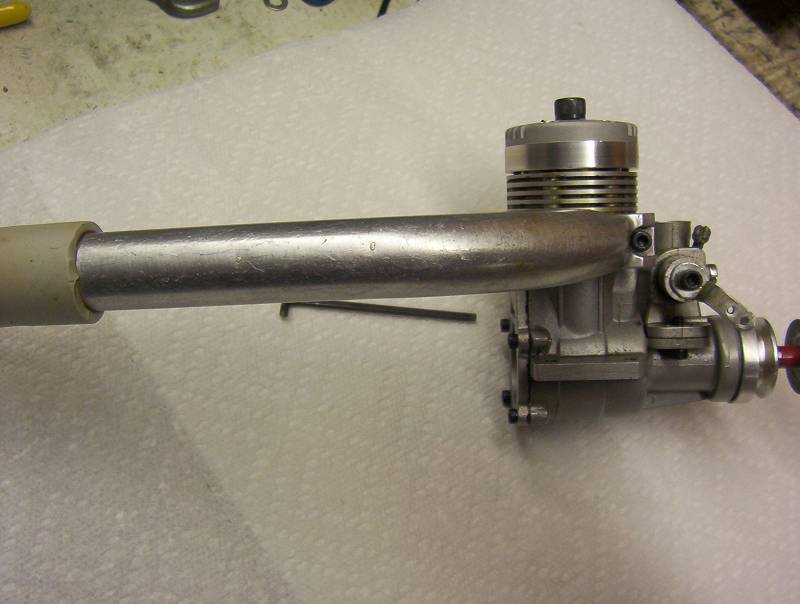

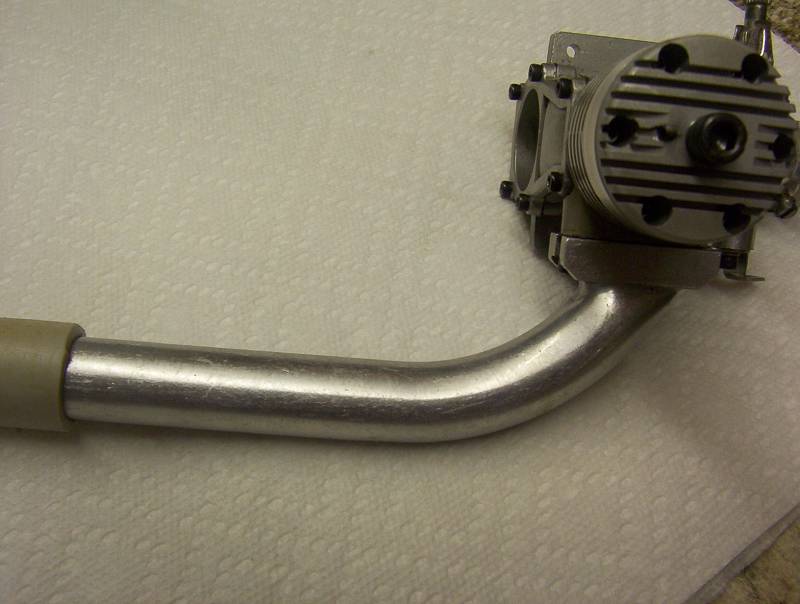

RE: tuned pipe on a fox 46
Timmer, here's what the thing looks like in real life on a Fox .46, I scrounged through my, "I ain't seen it in a long time stuff" and there it was. I even found the Allen wrench I modified to tighten the rear mounting bolt. You screw the rear mounting bolt most of the way in and then slide the header over it then place the front mouning screw.

ORIGINAL: Hobbsy
where did you get that header? and is that a diesel converson? how does it run like that?
I think I bought that header and pipe from Tower years ago. Pipes don't work all that well on Diesels because the exhaust is cool compared to a glow engines exhaust. With a MVVS quiet muffler the .46 conversion turns a Graupner 12x7 in the 9,300 rpm range.

Even old baffle piston two-strokes experience a power gain from a tuned pipe. My friend, Syd Clement, Bridgeton, NJ, put this puppy to rest by dazzling everyone with his Bridi Dirty Birdy 40, which was powered by a tuned pipe equipped K&B .40 (old baffle piston version), running an M&H carburetor. This occurred many years ago, right after Schnuerle ported engines became popular and common.
I shouldn't say this, as I'm bidding on one at the moment, but there are two original Fox tuned pipe setups up for auction on the Bay at this very moment that will fit your engine (I've got plenty of stuff, so if I lose to you, so what?). I've owned and used the Fox tuned pipe before and it worked wonders on my large block Fox .45BB.
Instead of adjusting the length of the Fox pipe or header, just substitute larger or smaller props until it "runs right". Don't forget to readjust the fuel mixture each and every time that you make any kind of change. i.e., prop size or glow plug type. Have fun! Oh, and get ready to go through a glow plug every four or five flights - even when everything is matched perfectly. Rossi glow plugs were the only plugs (and OPS) that I found that would stand up to more flights while running a pipe. Also, keep the nitro to 10% or less, if you're having trouble with preignition.
