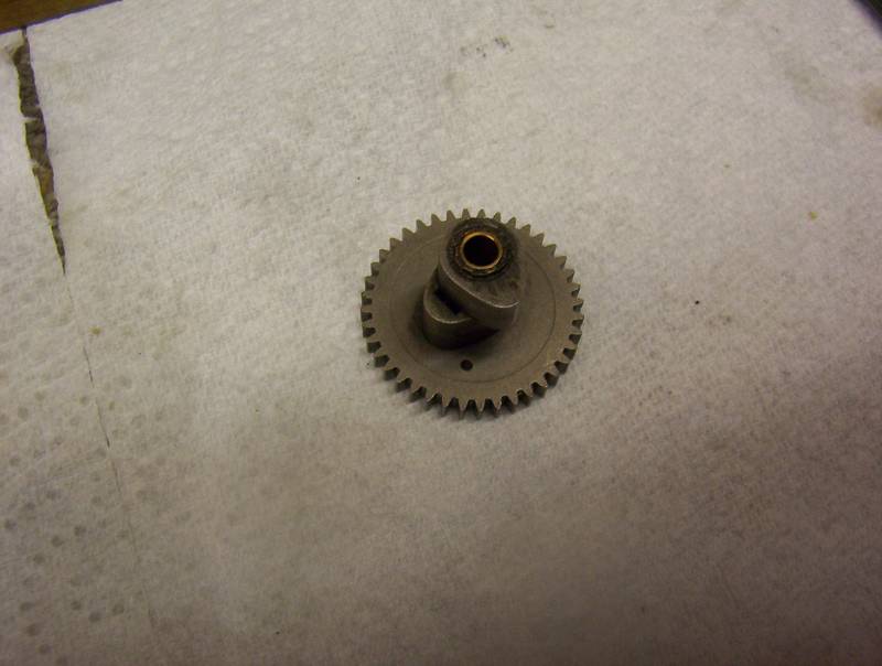

My Saito 115 took a dump today. I opened it up and the camshaft supports had both broken. The cam jamed up and really screwed up the crankshaft, crankcase and of course the cam. The cam and surrounding area seemed quite dry of oil, not completely dry, but not wet with oil either. This engine was only 5 months old and has used about 2 gallons of Coolpower 15% fuel. It appears that the failure was due to a lack of lubrication in the cam bearings, even though the crankcase was literally dripping oil when I removed the back plate. I'm wondering if anyone else has seen this type of failure on this engine. I talked to Horizon Hobby and they said to send it in and they'd look at it. I'm hopeing that this isn't some kind of a design problem as I just got another 115 that hasn't even been started yet. So has anyone seen this before, or do you think it was just a fluke happening?

What prop were you running when this happenned, is it possible it over revved and jammed a valve. I seriously doubt that lack of lube would be the problem, I have about 20 Saitos both rear vent and front vent and no problems ever. Thanks, Dave
PS, also what fuel?

I keep telling people that you should pre-lube the cambox area of those Saitos with a backplate-mounted crankcase breather nipple.
There's simply nothing to push the oil past the rear bearing and into the cambox area beacuse all the excess oil just vents out the back of the engine.
I've outlined the process I use at the start of each flying season before and I've never had an issue but I've heard of quite a few other folks who've ended up with dry camshaft bushes because they perform no manual lubrication or think that oil dripped down the pushrod tubes will make its way into the cambox (which it wont).

XJet, what is the process that you're speaking of? I know that dripping oil down the pushrod tubes won't make it to the cam, but on the other hand one shouldn't have to perform a lubrication ritual to keep the cam lubed. The engine should do that through it's design.
Hobbsy, The prop was a 14x8 which tachs at 9900 at my altitude (4300 ft), so I know it didn't over rev. Besides, this is the same prop I've always used on it. Fuel was Coolpower 15%. I'm quite sure the failure was due to lack of lubrication as the cam housing was quite dry of oil.
We'll see what Horizon Hobby has to say.

Dar, my thinking is that if the failure was due to lack of lube the damage would only be stripped teeth on the cam, the catastrophic breaking of the cam supports had to come from severe down force from the cam pushing against a jammed valve or other.

Get a pump oiler. Fill it with ARO. Attach it to the breather and pump the crankcase FULL of oil. Clamp off the breather. Turn the motor over by hand several times. This will pump the oil past the rear bearing. Unclamp the breather and turn the motor over until the breather quits spitting oil. DONE.

Follow up:
Horizon called me today. They had no explanation for the failure, but said that it shouldn't have happened. They agreed to repair the engine under warranty and return it to me. Fair enough.
In my first post I mentioned that I had a 2nd new, never run 115. Well I took the cam cover off and was shocked. There appeared to be no lube of any kind in there. No grease and no oil, absolutely bone dry. Needless to say, I pre-lubed the thing with Xjet's method. In the future, I'm going to store all my Saito equipped planes in a nose down attitude, the idea being that any residual oil in the engine will drain down to the cam. Any comments?
Paul

Ed, here is the 18 year old cam out of my 1.50, I thought it was worn out but low and behold the new one is identical. I thought it was worn because the exhust cam is kinda pointy, so is the new one. apparently the exhaust valve opens very quickly, the intake is more rounded.

I recently rebuilt a crash damaged Saito 72 with reportedly less than 5 hours running time total. Both cam followers had the outer edges worn on opposing sides giving the appearance of a slightly peaked roof, with the worn areas having a scuffed appearance. The cam lobes showed no appreciable wear. This is obviously a lubrication failure problem. I suspect that the engine had never been treated to an after run oil. This engine has the breather nipple at the bottom of the front case which should ensure proper lubrication to the cam box area. The cam followers in this engine are significantly smaller diameter than those used in OS engines and are therefore more highly loaded.
I have never seen this type of wear before in rebuilding many 4 stroke engines.
