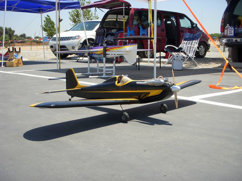

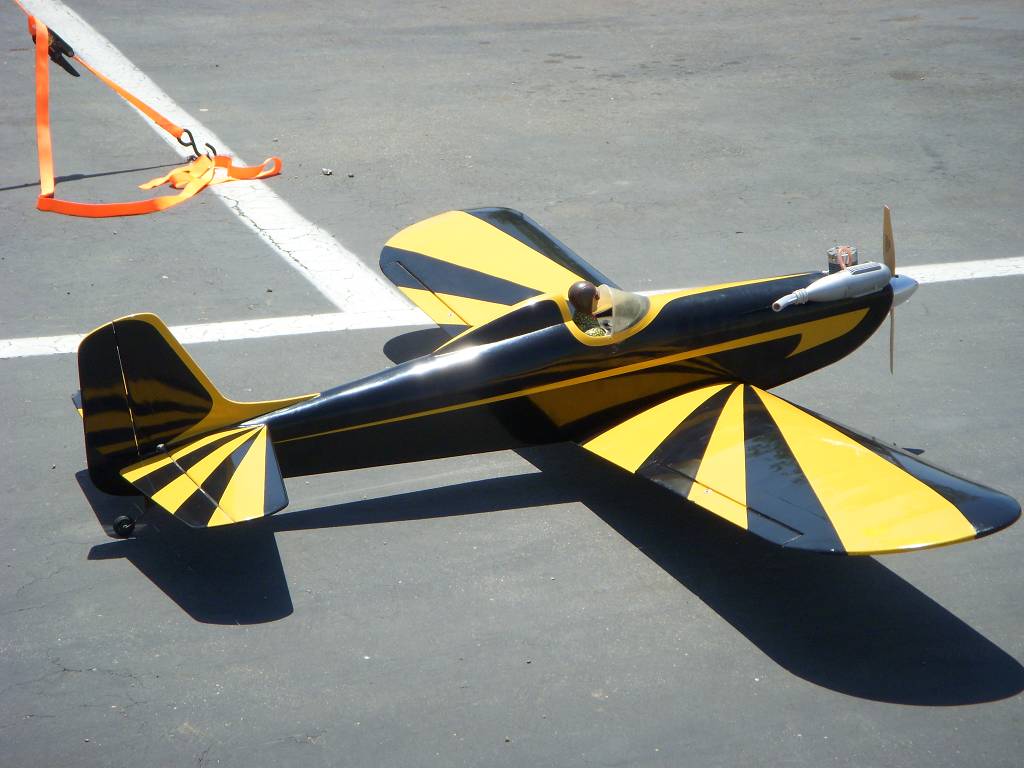

I used the factory side thrust and feel it is about right... I did remove 1/2 of the dihedral and it flies like a dream! the factory dihedral is simply more than we need these days. I am flying mine with an older (but good running) Saito80 and wish I had a 90 sized 4 stroke. I Love my Hog! If I did it again, I would for sure make it a tail dragger.
