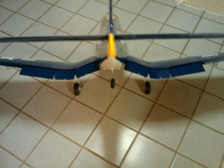

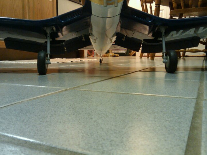

Iused a carpenters chalk line and ran it down the side, and snapped the line and it leaves a colored chalk line. Sinple and easy to do. As you can see on my Corsair the top is blue, and the bottom is white, and it'sa very straight.
