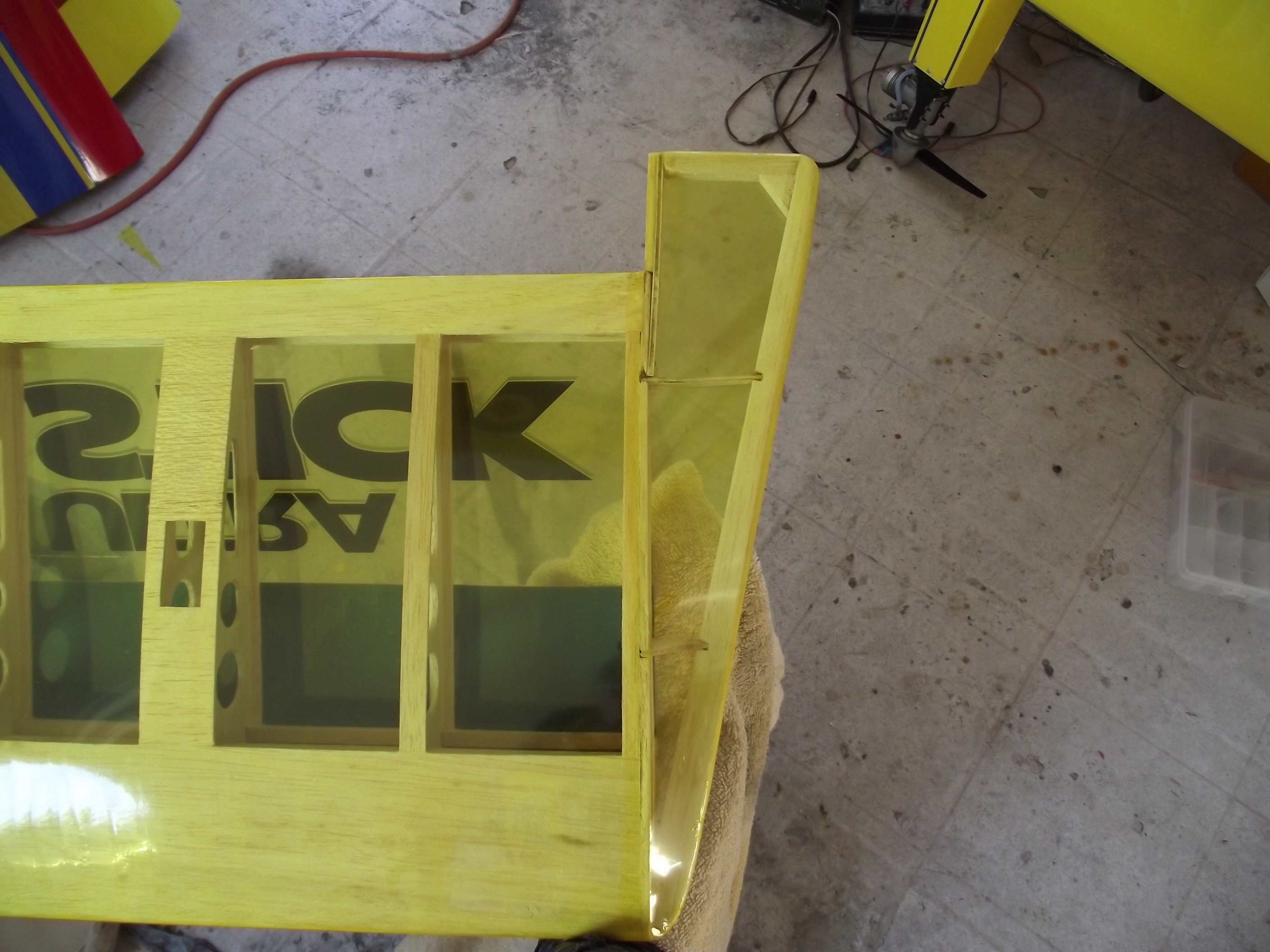

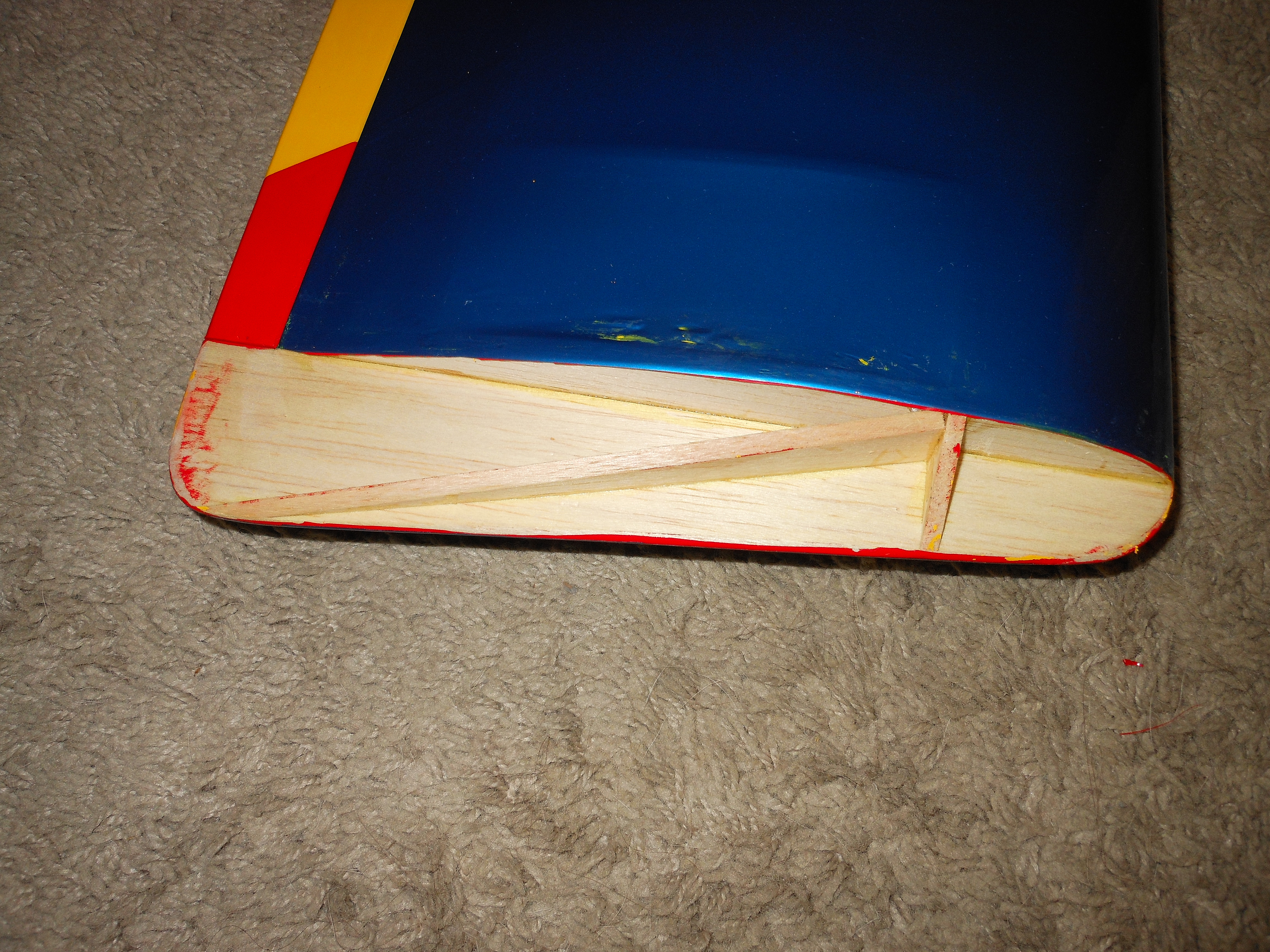

I'm having a heck of a time with this wingtip. Its basically a Sticks tip, and the compound curve is severe. Has anyone done one like this, and can you please explain the technique involved. I've been heating, and stretching the MonoKote, but am always left with too much at the leading edge. Thank you for your help, and suggestions.
My Feedback: (81)
Just iron a piece over lapping the blue part by about a 1/2in. Take your heating gun and stretch and stretch and stretch over the wing tip. Use a glove so you don't get burnt and sometimes you can get help with someone heating while you stretch. If there are still wrinkles after you stretch just heat them out with your heating gun. It might take a few tries but you can do it. Monokote stretches pretty good. Make sure you have plenty of extra monokote to pull on, atleast 2 or 3 inches.

Maybe that's what I've been doing wrong. I leave about an inch an a half. I guess I'm not leaving enough covering. I've pulled, and heated quite a bit. I try to preshrink the covering before attaching it but the taper at the leading edge is so severe I'm always left with extra material.
I guess instead of trying to preshrink I should try to stretch the covering around the tip.
I get close, but just can't get it to be tight. I know if I lock MonoKote down, and try to remove the wrinkles there already locked in making it all, but impossible to remove.
I'll practice. I just hate trying to remove MonoKote as it leaves the residual color behind if I want to do a redo.

What you need to remember is that with stick models, the area being covered is considerably less than what you're trying to cover in this build. Most use the supplied tissue to cover the model with so a little water tightens it right up. Along with the dope needed to hold the tissue to the wood, there's not a lot needed to cover with. I've built several Guillow's planes and, other than not breaking the sticks, putting your finger through the tissue is the hardest part

My past experience with Monokote/UltraKote this kind of tip, should have been done with one piece for the whole bottom of the wing and one whole piece for the whole top of the wing. Starting from the center of the wing. Trying to cover just the tip is extremely difficult, as you are experiencing. Do the bottom of the wing first. Iron down the covering at the center of the wing. Do not attach the leading edge of the wing or the trailing edge of the covering. With a heat glove and gun, pull the whole sheet of covering over the center of the tip. As it attaches, continue to pull the covering working forward and towards the trailing edge of the tip. Once secure, then heat and pull the leading edge of the wing covering until secure. Repeat for the trailing edge of the wing. The one mistake I see, is that you are trying to have very little edge on the blue part of the main wing. There just isn't enough material to stretch. Has to be a whole wing panel. Thus, as you pull it, the heat pulls off of the blue too. Repeat for the top of the wing. You are trying to do it with too small of a piece. Has to be one whole panel.

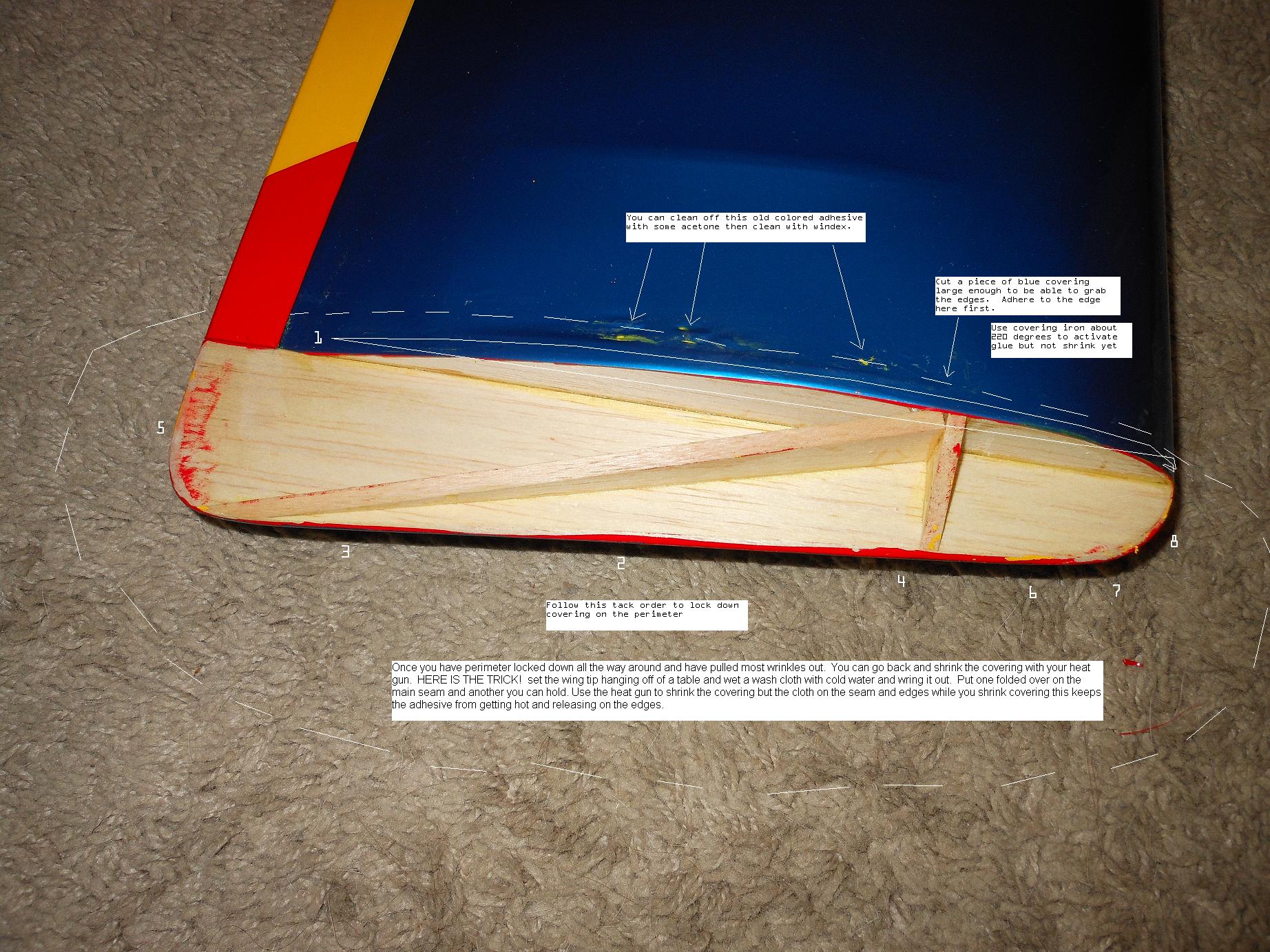

Here is a method I use when covering open structure wingtips. Hope this makes sense. Just let me know if you have any questions. The key is to keep the seam and edges cool when you shrink the open areas with your heat gun. Don't stay in one place to long, keep moving. Good Luck!

Great diagram! I will try it that way, but I have to say using MonoKote at least to me isn't easy. It seems like it doesn't shrink enough to pull tight. I have no experience with Ultra Coat, but have to say I'm more than curious now to try it. This plane holds more sentimental value as its over 20 years old, and my father, and I learned to fly on this model prior to him passing.
I will do whatever it takes to get it right, but these tips aren't making it easy.
I tried preshrinking MonoKote again, and still didn't see really any shrinking. the covering appears to only form heat blisters, and become stiffer, and less pliable after applying heat. I'm only talking about 220-240 degrees with the iron. I'm not sure if its just my technique, or its this difficult to work with.

I prefer Ultracote. I have used both for number of years and switched to Ultracote exclusively unless recovering a plane that already has MonoKote. This is just my opinion as this topic appears to be like Chevy vs. Ford in the threads. All I know is I have actually covered wheel pants with ultracote because I can pull and stretch that stuff like crazy. Also I have found you need to use fairly fresh stuff whichever one you choose. I wrap all my covering rolls in plastic wrap once I am done to keep if fresh longer. There is nothing like the smell of hot Ultracote in the morning... LOL
I am assuming that the exisiting wing covering is Monocote. Monocote is a higher temp covering than Ultrakote. I would use a lower temp covering to patch over the Monocote so that you would not need to get very hot and affect the existing covering. I think UltraKote would be good here because you won't need to get it so hot, plus Ultrakote shrinks quite well. Also, you can use the Topflite Monocote adhesive/dissolver to rub off the coloring smudges that stuck to the existing covering, but make sure the dissolver is removed before you iron on the new covering. But the dissolver usage is optional and does add some complexity that you may not want.
As mentioned already, stick the covering around the perimeter with a lower temp setting just to make stick, but not shrink (the temps will vary based on which covering you are using). After you are 100% sure that the covering is glued down around the whole perimeter completely, then raise the temperature of the iron or heat gun and shrink it.

CModel, try taking a piece of monokote about 2" larger all around compared to the area you are covering, adhere it to the edge of the wing first, keeping at least a quarter of Monokote at the edge, then pull it by hand down to the center edge of the wing and all around the edges, for myself the secret here is to keep the heat off the Monokote that you are putting on, Just enough heat to stick it to the edges. Making sure all the edges are adhered, use a heat gun and keep it fairly far away just enough to start seeing the wrinkles go away, they will continue to go away even after the heat is taken away. Patience is the key here. Try not to shrink the Monokoe with the iron when putting it on, so that when you are ready to use the heat gun, you will have all the shrinkability the monokote has to offer, because you have not used it up until the heat gun is applied, Bob.
Moderator
I've done a repair like this before. It can be done in one piece of covering. The trick is to use your heat gun for application and stretch the covering at the same time you are shrinking it. Iron the covering down without shrinking it on the flat part of the wing, stopping where the curve at the leading edge starts to tighten. Then you can pull on the covering at the front to stretch it as you use the heat gun to activate the adhesive. That will pull most of the wrinkles out of that annoying section between the spar and leading edge on the wingtip. Then use the same pulling technique to adhere the covering to the edge of the wingtip by wrapping the covering around and pulling from the bottom while heating the top. You'll need to aim the heat away from the first seam you made, so you'll need a glove to protect your hand. Once it's stuck all the way around, you can keep using the heat gun to wrap the covering around the radius of the wingtip. The last step, if needed, is to use the iron at shrinking temperature to shrink out any looseness that remains over the open structure.
