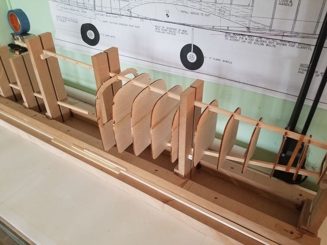

Hi,
I will be billing a very complex airplane very shortly. I know that used to make several building Jake does anybody know about building jigs that are available now for wing and fuselage construction? I know they don't make the adjuster jig anymore and it seems pretty hard to find something. I would appreciate any ideas or links to current available products.

Flat board across the bottom (old bed board in my case) Three vertical boards mounted squarely to it. (angle brackets checked with square) make your support rods all the same height off the bottom board . Then its just a matter of making the opening on your bulkheads all on dead center.. Slide the parts on ...

I have to agree with Foodstick about there being too many formers. I went over to Outerzone and had a look at the plans and construction article. One option would be to source an "Adjusto-Jig". They are scarce but there are apparently a few out there. Failing that, you could recreate the function of an adjusto-jig without the adjusto by cutting a series of plywood slotted tongues and gluing them to a base along a straight datum line. The slots would have to be narrow enough to hold the "fuselage crutch" stringers in place while the formers and eventually the sheeting were glued in place. It would be necessary to be really accurate in locating and marking the position of the formers on the crutches and in locating the crutches in relation to one another. It might be easier to add a set of stingers at about the level of the fuselage floor and use them as a crutch for building the fuselage.

Heliman, it wouldn't be that hard to add feet ala Alan Flowers. Draw a datum through the length of the plan. Transfer that datum line to each of the formers according to their position in the model.Draw a parallel line on the plans underneath the model. Use the distance between the two lines to determine how long the legs should be. Note how Alan stabilizes his feet. Once you have added enough stringers/sheeting to locate and stabilize all of the formers then you can trim away the feet and proceed as usual.

Okay here's the completed jig. This should not warp. There are quarter inch slots for me to slide down my 1/4 by 3/8 basswood strip. Also there's a few pictures I started putting in some former's just to see how things line up what you guys think? The plans are on the wall.

Looks like that dog'll hunt.

I know I mentioned that there were more than enough formers in there.. But don't get to far along in your build without opening some routes for your pushrods.. Unless you are mounting the servos in back.. (you will still need to run wires somehow...)
