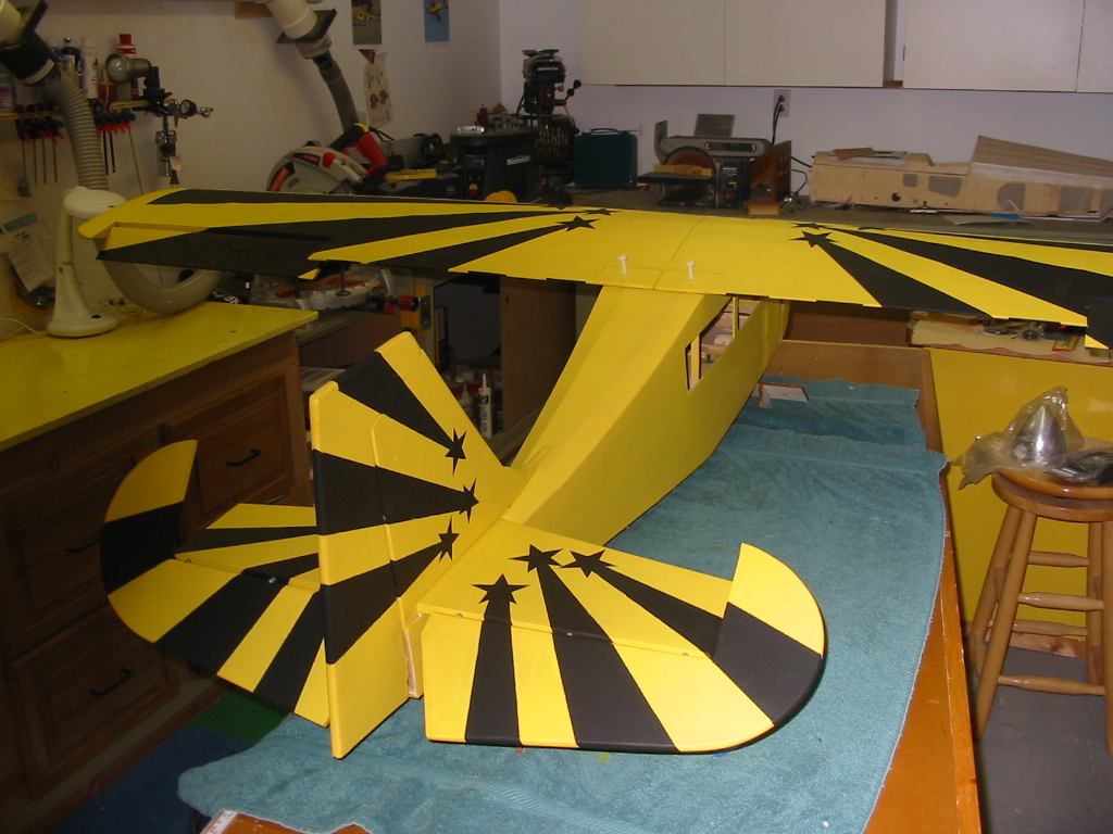

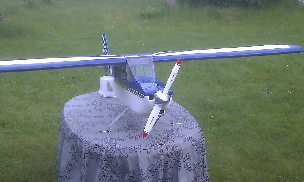

Hi,

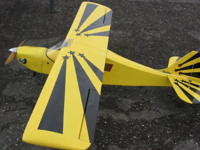

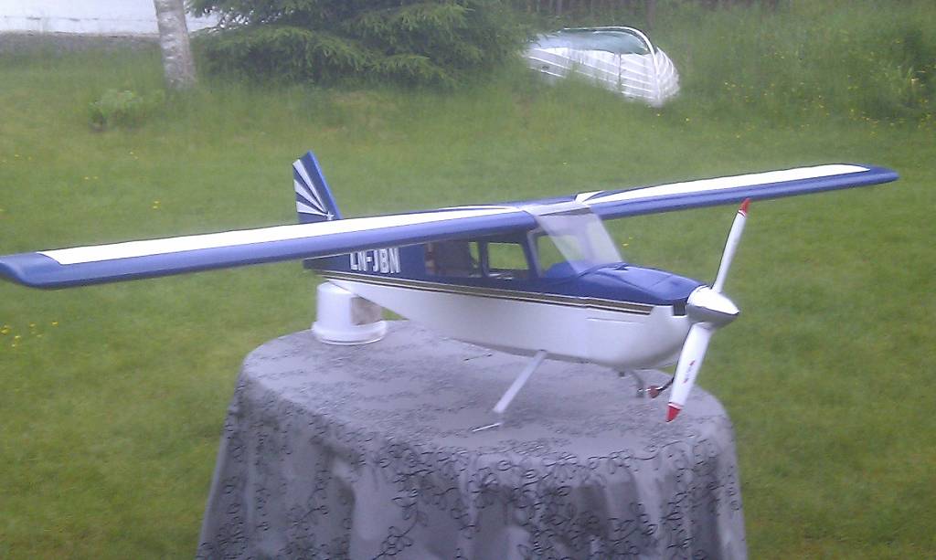

Here is some update from my project:
Covered with Solartex , then Cellulose dope and paint.
I used thestandard paint scheme "Sun star"(I couldn't imagine mee mask and paint 18 stars....)
I try to do some work every day now, and hopefully i amready to fly in the end of June this summer.
Borresen
Borresen
#1609
RE: Building a Dynaflite Super Decathlon
Kolbboer,
Your plane looks great. I may have to leave the stars off also. I'm useing Monocoat and Ultracoat so I may attempt cutting out some stars.

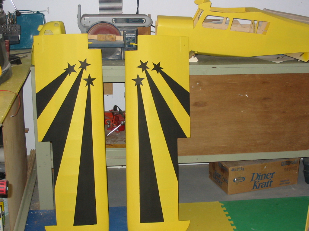

Hi Borresen,
Your Super Decathlon looks beautiful. Congratulations!!
Making stars is not difficult. I was at first very intimidated until I figured out how to do it the easy way.
My SD is covered with Super Coverite fabric, spray painted with yellow latex, The black stripes were sprayed on with black acrylic.
The stars were printed with a laser printer on to a sheet of clear labels from Avery No. 15665. The stars were first formatted in MS Word,
Insert, Shapes, Stars and Banners. Pick a star, adjust the size, copy and paste a whole page of the various sizes that you need, then print it on the Avery sheet in the color that you want. Cut out the stars with a sharp blade, peel off the back and stick them on.
I sprayed clear coat over everything when I finished.
I hope that this helps,

Hi, Wildchrashwilly,Orthobird and mikem99
Thank for the comments of my dyecathlon paint sheeme,
It's havebeen 2 days off the project now. had some nice weather that i spentspent flying with my Sig Rascale 40, (covered with solartex) a very good flyer.
now i am back,and struts isready. Rudder and elevator iscovered and ready for paint.
Tomrrow ican addsome more pictures of the progress.
RGS
Jan Børresen
RGS
Jan Børresen

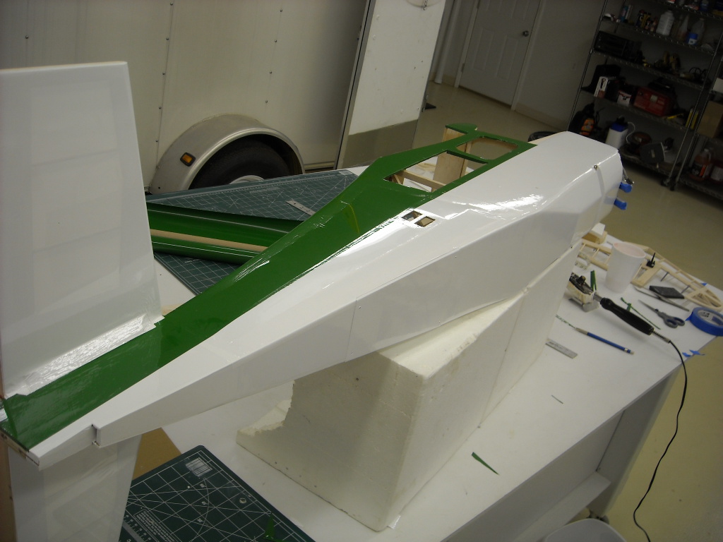

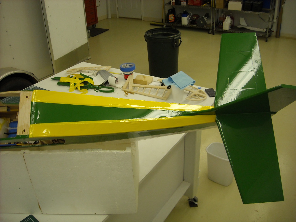

Guys,

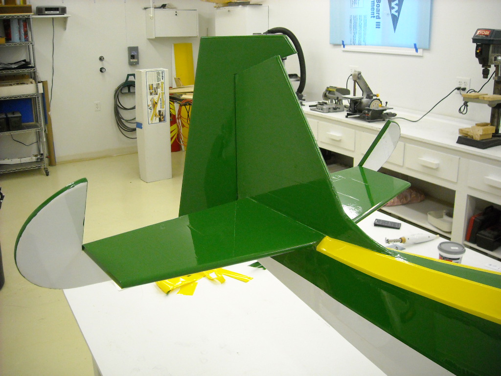

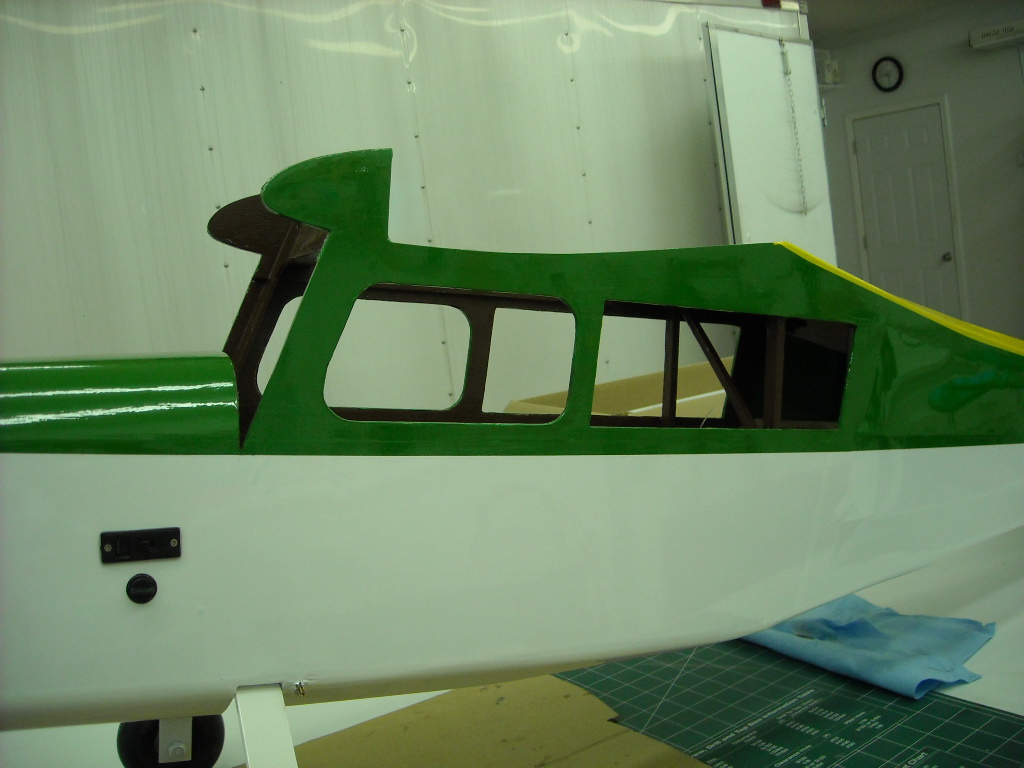

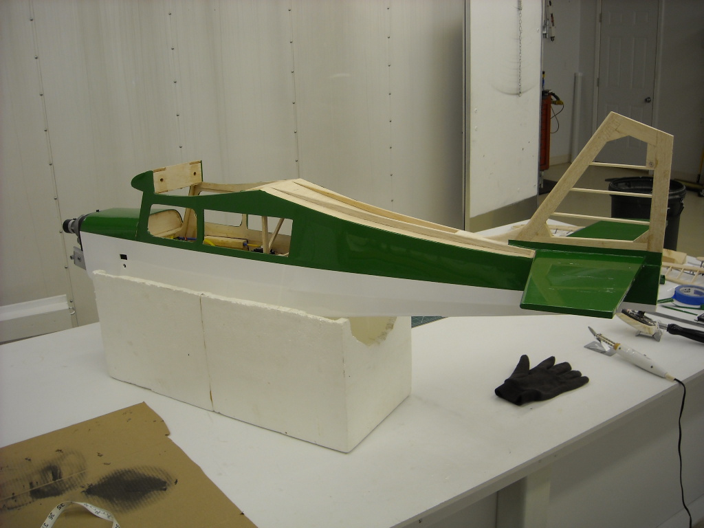

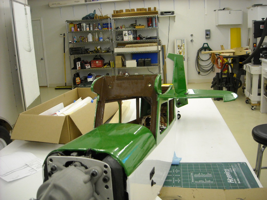

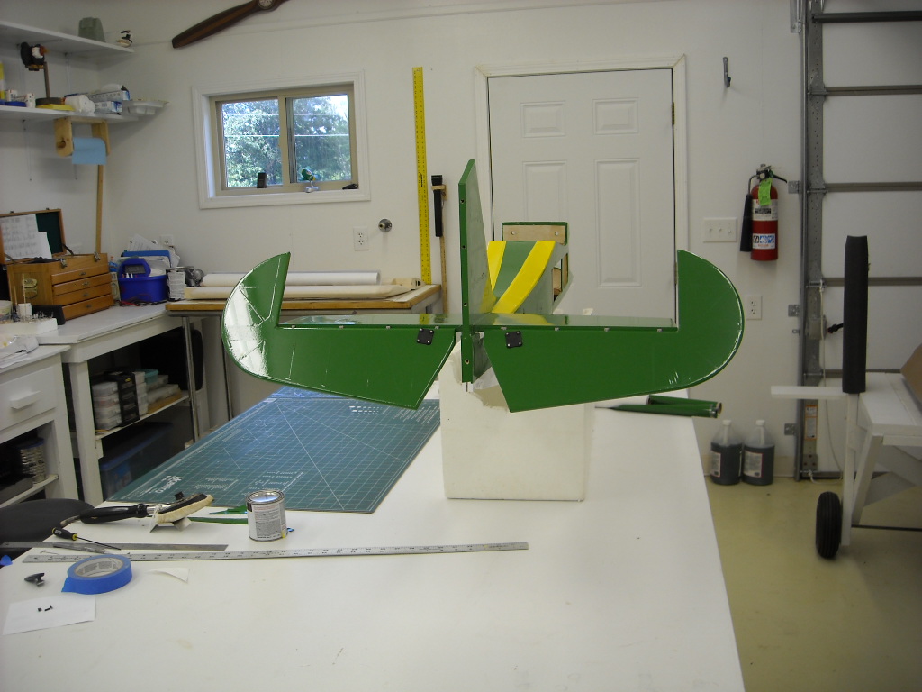

Worked on the decath some more this week. Started covering today. I have a few more pictures but I'm on a kindel fire tonight and can't upload pictures through it. I'll be back on a computer tomorrow where I can update the pics. I know a lot of you purists wanted me to cover with cloth. Sorry, I took the easy way out and have been using film. Mainly because I've never used cloth and don't feel comfortable with it. I have a Topflight SR9 kit that I may start in the fall. Maybe that one would be a good one to learn cloth covering on. I'll do a build thread on that one and get you guys to coach me on the cloth covering if that's okay.
Have a good evening.

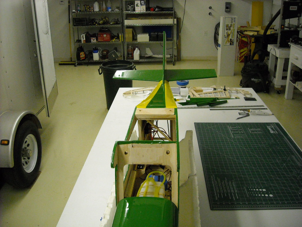

#1619

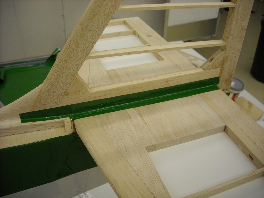

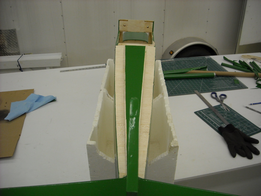

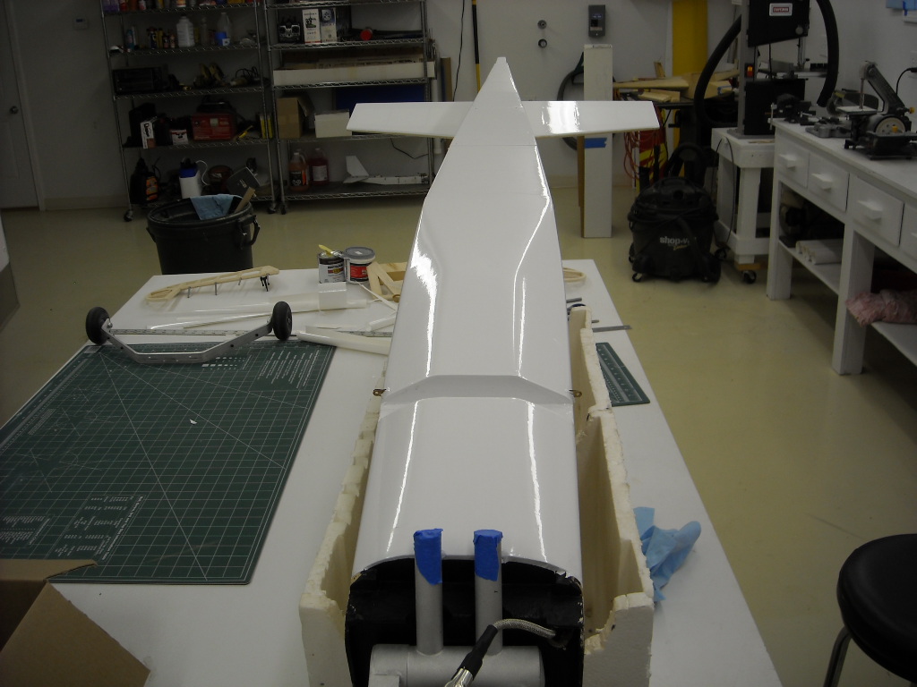

Here are a few more pics as I work on the Decath. The first one if I have the order correct, is the dual radio switches, the second one is where the ig. switch and fuel dot will be located. the third one is the bottom covering and the last one is the side covering.
