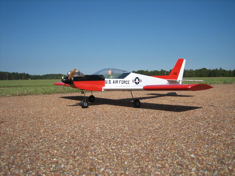

I just maidened my T2 (tail-dragger and dual aileron servos) 2 weeks ago. (Pics in my gallery / avatar). This is one terrific flying plane - you can't help but love flying it. I had never flown a low wing or a tail-dragger and did the maiden myself. It tracked straight and just floated off the ground. The only trim adjustment was t clicks of down elevator. I've found that the recommended control throws were pretty conservative. I now have my elevator low rates set to the factory hi throws and increased the high rates another 3/8" total. And I will probably increase the aileron throw as well. You probably won't need the flaperons. It slows down nicely and floats right in. I hadn't thought about wheel pants - might be a nice touch. I'll be looking for the pics...

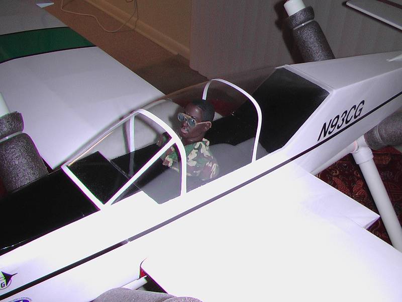

Just took a peek at your tiger. The toy pilots were a nice touch. Now I think I'm going to the toy store and decapitating some action figures for mine. Thx for the reply

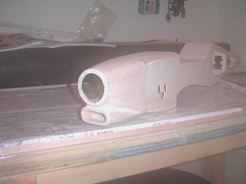

Thx for all of your reply's. I'm done with rough work for the cowl. It didn't turn out as "great" as I expected. It might be passable when I monokote it.

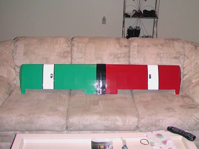

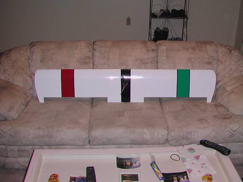

I finally have the tail feathers sanded and ready for covering. I got the covering scheme from a guy off rc universe. It will look very similar. I liked the simplistic blend of colors.
I'm still contemplating what to put in the green area of the rudder (decal, tail number, etc.). Any suggestions?

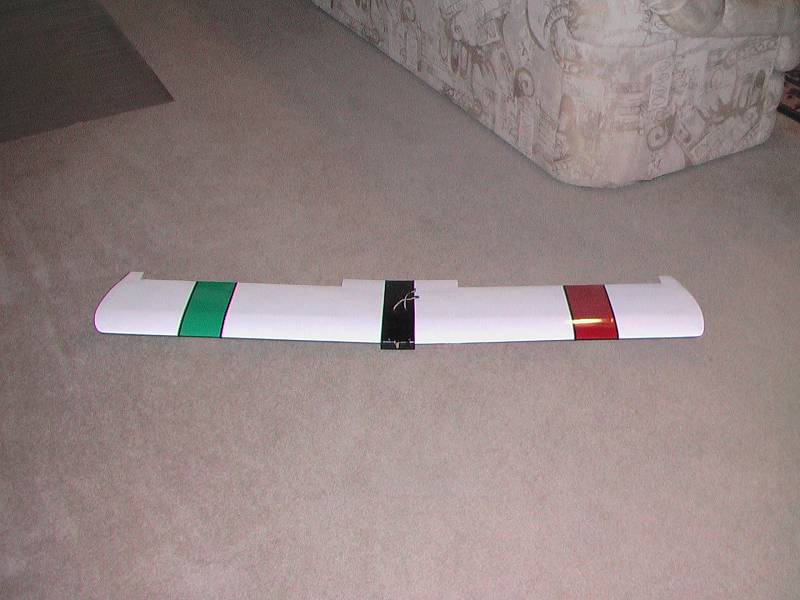

Pulled an all-nighter and got the wing covered. I've been working on my plane for 18 hours straight. It's 0430 here and I'm not tired at all. I go to work and I'm reaching for the coffee pot after 2 hours. This proves it. Time flys when you're having fun! Here's a few pics. The white is the top and the multi-colored will be the bottom. I was going for something simple yet unique. Reminds me of Mexico for some reason.....

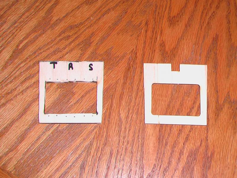

This is why I love kit building. I am now installing the servo tray for my tiger. As you can see the ply servo tray included in the kit is sub-par. So much so, that when I wanted to dry fit it into the fuse it snapped in two (see pics). I don't have to wait long for an excuse to Mod something. I took into account that I'm using high torque servos, with pull-pull control surfaces and came to the conclusion that the servo tray will be a stressed area. The solution (1/4" thick super strong ply) will add a little weight but at least when the tiger takes off I know that is one part that will not break (thats the T-R-S piece on the left). Check out the pics and you'll see what I'm talking about.
On a similar topic, this is a great looking and great flying aircraft (popular opinion), but the wood included in the kit is of horrid quality. I have decieded at the end of this build so submit a complete list (with pictures) of Mods and areas that I strenthened (I think I'm up to 22 now). The reason is, I'm hearing too many stories from guys who assembled the kits following the plans and had a rudder come off in a snap roll or some wood component failing. At least this way all the popular Mods will be cataloged in one place. Be on the look out!

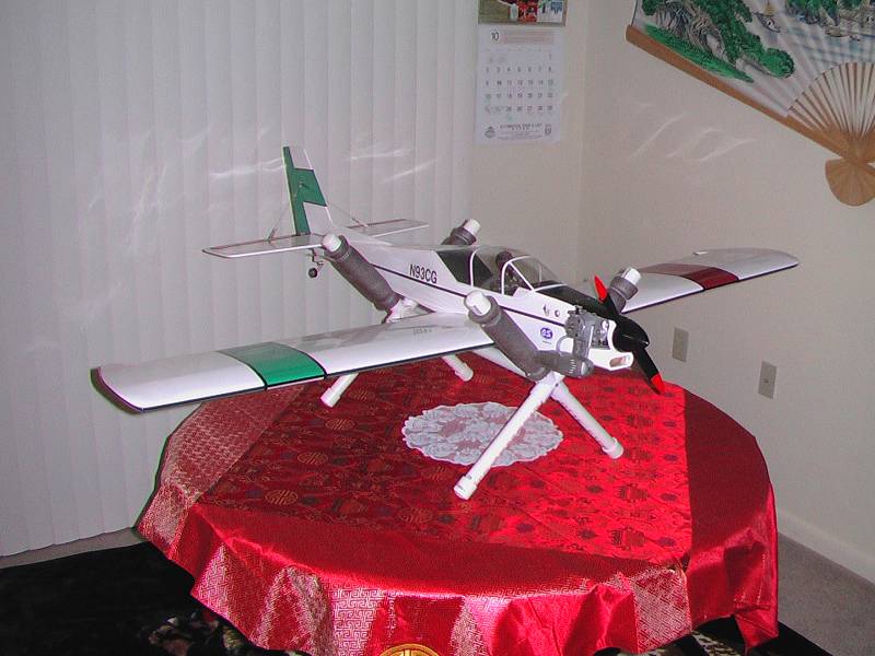

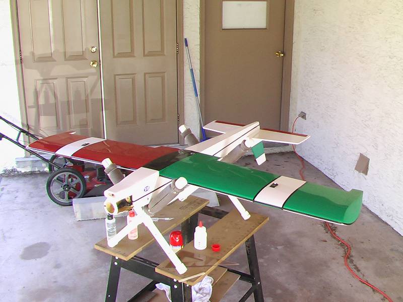

Have most of the covering done. The balsa cowl didn't come out too bad for my 1st time. Next time, I'll paint the inside BEFORE fuel proofing it. Oh well, building is a constant learning process.

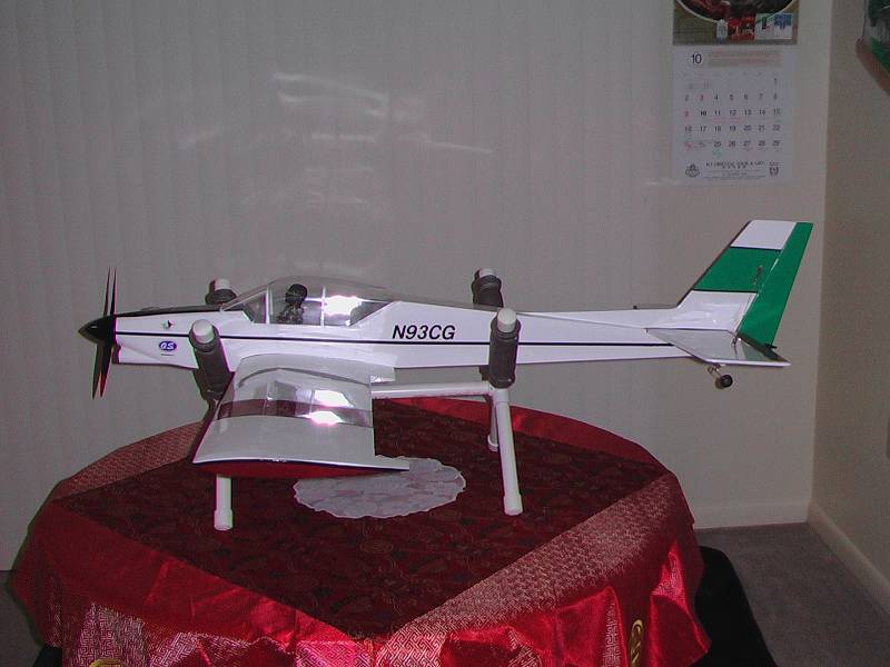

Thank you all for the complements. I'm getting a little closer to a finished product with the installation of the pilot/canopy, flight control surfaces, and painting the landing main gear. I kept getting outbid for the speedy gonzales and was 2 seconds away from paying tower hobbies $25.00 for a pilot when I went patroling in the BX's toy section and found this guy. Few modifications later, WHAM! I've got a prepainted/finished pilot for only $4.88!
Not much to do now except the wheel pants. Wheel pants are my personal trademark. I usually cover them with the same color ultrakote in the plane. I then pick a color pattern/design that will tie the entire look of the plane together. I'll post pics in a few days.
If I keep on the same schedule, I expect to maiden Saturday. I'll post videos when I do.

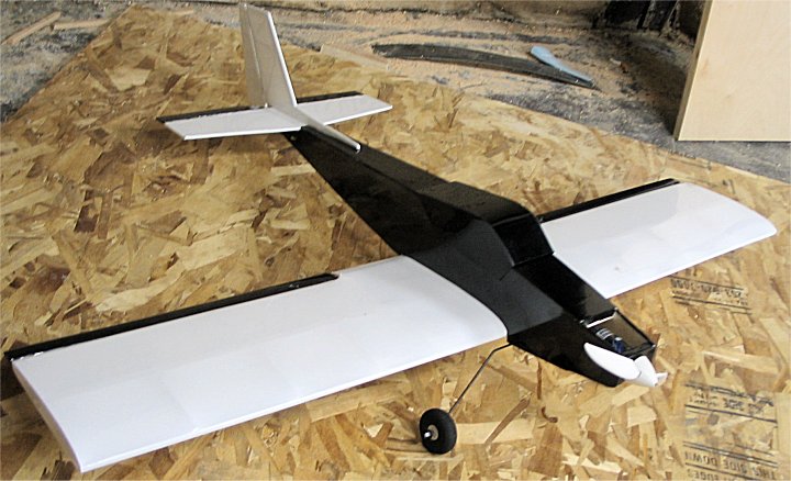

Good job guys, I know this is an old thread, so keeping it short, here is a photo of my Tiger 2 I built free hand from scratch, I had the original on my bench to take some measurments from, but as you can see, it's a whole new bird.
