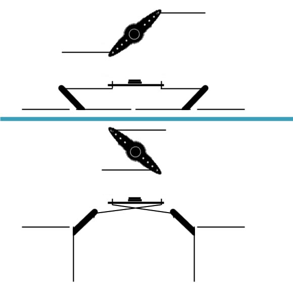

Hello To all,
I performed a search in this forum for some already listed topics in regards to bomb bay doors. No such luck!
I need help in makeing the release mechanism for it. I have no idea as to where to start and everything I have thought of sounds good and looks even better on paper but when it is applied it doesn't work.
Any help in this area will be a great help and apreciation.
Thank you and lets keep them flying.....

How's this?

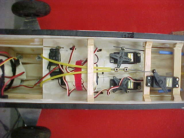

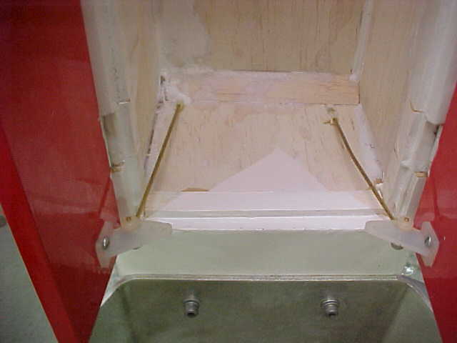

Here's how I did mine. Everything I kept coming up with was complicated. I finally settled on this. I used a flexible throttle cable to each door using a standard control horn, and routed to a common connection on the servo. It works well. I sealed the bomb bay from the rest of the plane.

Picture of cable routing to servo
