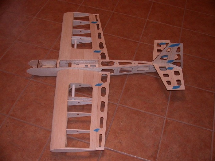

I finally finished setting up my new workshop last night and immediately dug into my SE kit. I built the control surfaces and tail first since I was looking for some instant gratification. Next, I started on the right wing.
My overall impressions of the kit are quite good. It's the third Sig kit I've built and is a marked improvement from the Kadet Mk II and Komander I built 15 years ago. The parts fit was about 99% compared to about 50% on the other two kits. Some of the parts in the tail in control surfaces could have fit better since there were a couple of parts where the half moon alignment dot was larger than the adjoining dimple. And, as it seems everyone else has mentioned, the holes in the plywood ribs for the wing tube socket were just a tad on the tight side But, the slots in the ribs for the spars and leading edge were perfect. If there's one thing I complain about, it's ribs that don't fit the spars but this kit didn't disappoint me. But, if there's one gripe I have, it's that the shear webs were not precut and the rib spacings are not consistent. With all of the work Sig put into this kit, they could have at least equally spaced the ribs and precut the shear webs.

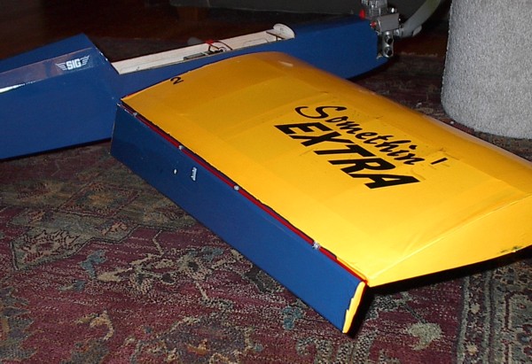

I always hated kits until I built my SE. I'm the worst builder in the world, but Sig kits make you look good. My planes always come out heavy, but I was impressed on how light my SE ended up.
If you follow their suggestion, you can truly build it as fast as you can put pieces together. I went from a box of sticks to the first flight in 26 hours, spread over 3 days. I was impressed.
By the way, if you hinge the ailerons so you have 180* of movement, you can do some wicked manuevers.

180* movement?
180 huh? I'd sure love to see control surfaces fold completely back on to the fixed surface
JK, I know what you mean. I've considered double beveling the surfaces, but I'm so far from that point I haven't made up my mind.
John
John

That's the beauty of Hinge Points. Just make sure you cover the gap and all is good.
In all seriousness, I almost always use the low rates. The plane is way too twitchy otherwise.

toucano we know what you mean,90 degrees,the plane looks so good I almost hit the wrong key also,to do justice the SE needs double beveling,also 85% expo on high rates,will help control it in the 3D mode,minus to soften with hitec and futaba plus for the rest of brands,and if you don't have expo, then talk to Santa.

Down 90* + up 90*.
Terrel,
I'll have to try the 85% expo on high rates. I'm a Futaba man, so that would be -85% for me. Thanks for the suggestion.

12 hours into the project.
There isn't much left in the kit box. Two sheets of laser cut parts, a few sticks, and the hardware.
Overall, I'm very impressed. Sig has come a long way since I built the Kadet Mk II and Kommander 18 years ago.
The tail surfaces are only sitting on the fuse right now. Pretty much all that is left is to build everything that goes on top of the fuse and install stuff such as the landing gear, pants and tail bracing. It will be ready for covering before the end of the week.
John

I just installed the tubes for the elevator and rudder controls last night. I have to admit right up front, it's not as pretty as I would have liked, and I'm sure I added more weight than I needed to. The elevator push rod system I'm using will be Dubro Ny-Steel rods with a separate rod going to each elevator then joined into a single common rod at the servo under the canopy. This is a method I've used many times in the past and it works well for me. The only downside is that it's difficult to get extreme throws out of the elevator due to the rigidity of the rods. I bored a hole through the center of each of the bulkheads to run the tubes through. I also ran full length tubes for the pull-pull cables through this hole. Now that I've been away from the bench for a few hours, I've decided I'm going to open up the top half of the bulkheads much the same as the lower portion of these pieces. It will save just a little bit of weight, but will allow me to get away with just a short section of guide tubing for the pull-pull cables where they exit the fuse. I'll make the mods and take pictures of the setup tonight.
BTW, I'm now 15 1/2 hours into the project and have another 1 1/2 - 2 hours before it's ready to cover.
John
JK, I installed the engine mounts on mine to accommodate either an Irvine .53 or a YS .63. There is only 1mm difference in the case width of the two engines so I installed the beams for the Irvine.
