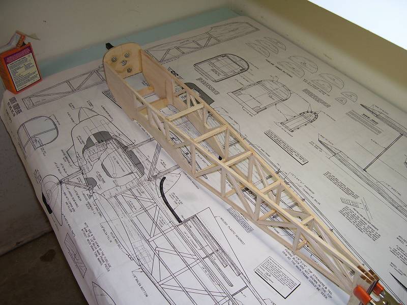

Here is the firewall epoxied to the fuse. Getting the motor mounts into the correct position was a lot easier that I thought it would be. I temporarily attached the mounts to the engine (O.S. 52 Surpass), temporarily attached the firewall to the engine & mounts, then used triangles to position the whole assembly over the plans until the crankshaft was exactly centered on the plans in two dimensions. I marked the mounts' position on the firewall, and drilled and attached them. Sounds more complicated then it was.
Here is the framed-up fuselage...

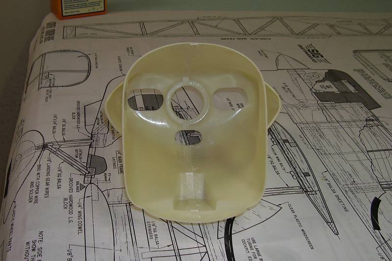

I took a break from woodworking, and assembled the cowl. I was going to fiberglass the inside, but it built sturdy enough without it, so I'll save the weight. Once again, CA was the only adhesive used.
I coarse-sanded the seams with 100 grit paper, progressing to 320 dry, then 400 wet finishing with 600 wet. Wow, its smooooooth! Wheel pants and headrest not shown, but same method used.

Inside of the cowl. There is a plastic reinforcing strip that covers the seam. Plenty strong.

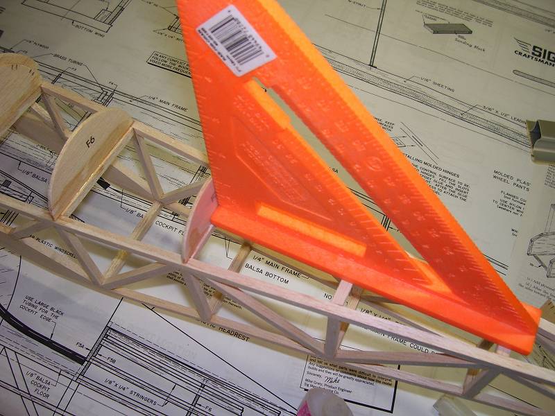

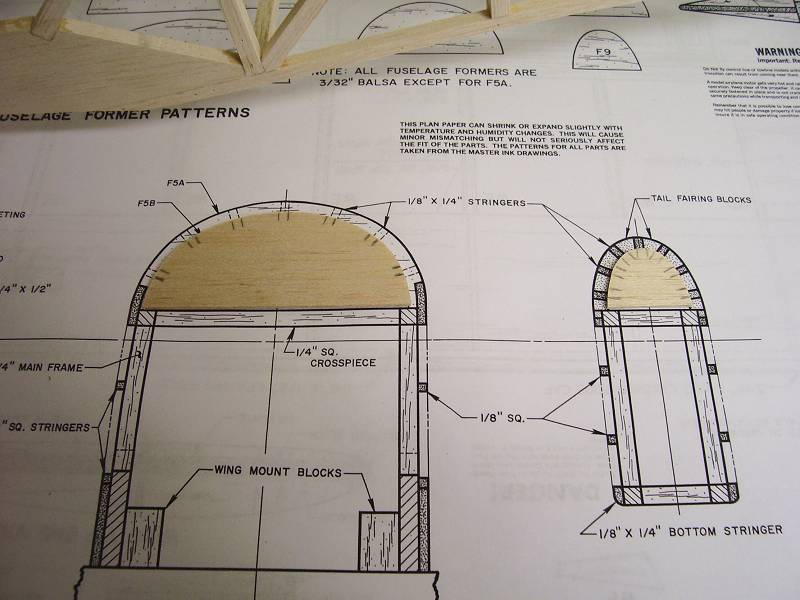

You have to mark the position of the stringers on the front and back formers before you install, by the way.[&:]

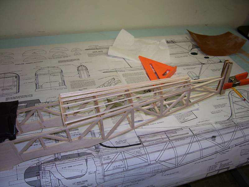

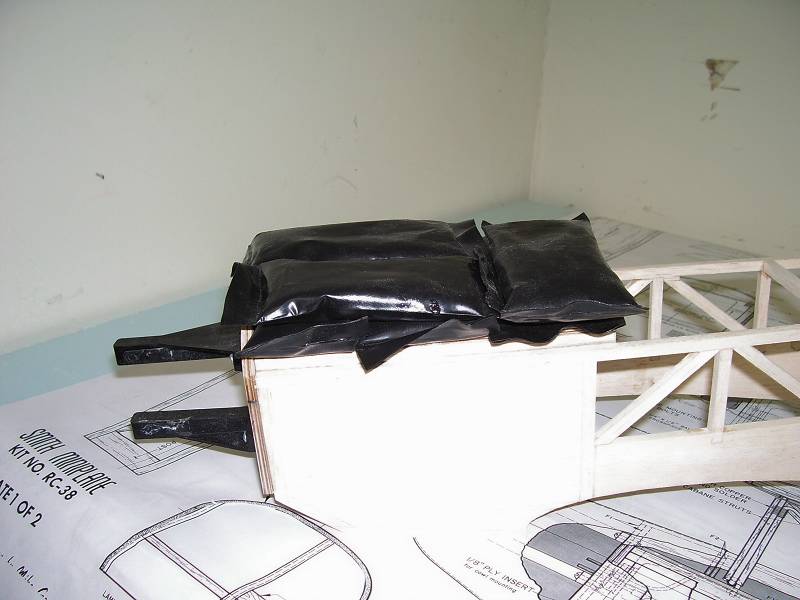

Here she is all strung up...or is that strung out...? I dunno...
Turtledeck stringers attached. On the left side, the black mass is a pile of ankle weights from my wife's old weight set. These are being used to hold down the plywood piece where the cabane struts will eventually be attached.
