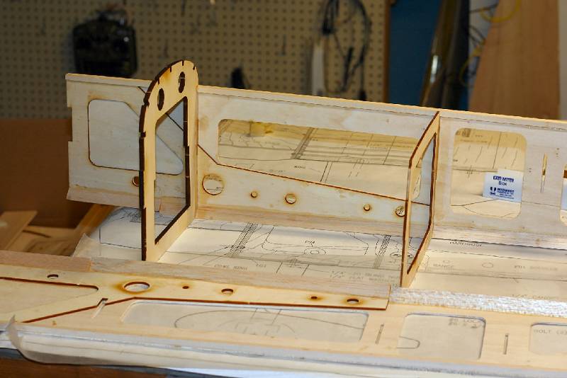

OK here's What ya get..
How UPS lot a box this big baffles me. (this is the 2nd one they shipped)
What's inside? Paper! lots of it..
Under that.. Wing cores and more paper!
Bundles of sticks and sheets..
I weighed the wing sheeting.. 26 sheets of 3/32x3x42.. High was 72g low.. 40g.. average 50-60g pr sheet
Canopy/Hatch.. I'll build a balsa hatch and just keep the canopy section
Laser cut lite ply.. (it's all lite ply.. no luan)
Crappy ABS 2 piece Cowl thing.. I'll get glass
Gear.. Havvy
Fuse side.. 1 piece lite ply.. CNC routed..

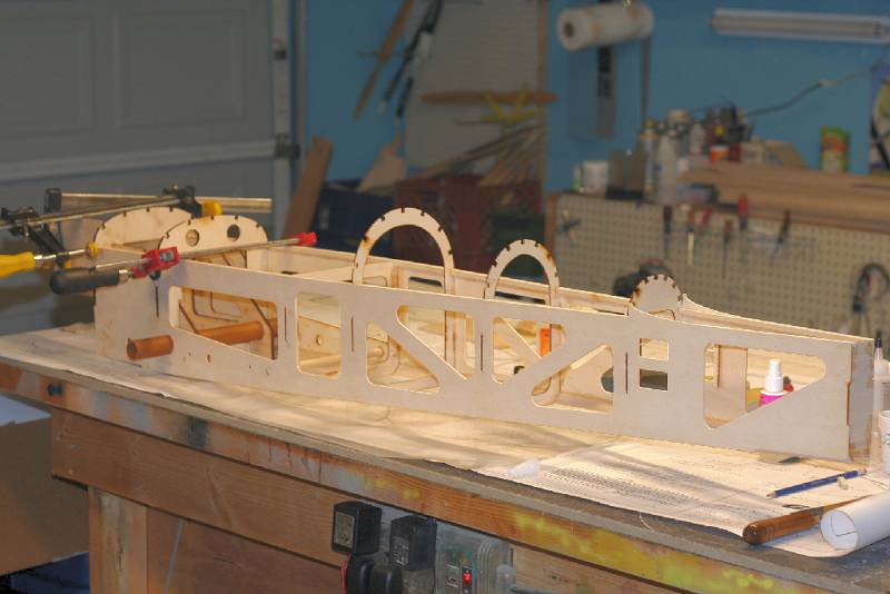

The Cap's started. Fuse sides are done, and F2 and F3 are curing in the right side as I type. *heh* (I'll get some pics up tomorrow, hopefully)
Thus far, I must echo most of what sscherin said above:
Everything seems to be decently cut...which is to say, no dinged edges, anything like that. And everything is, indeed, CNC routed or laser cut...not die-crushed.
I'm less than impressed with the precision, however. Having recently worked on Top-Flight's big mustang, which WAS die cut, I got spoiled by how nicely EVERYTHING lines up in that kit. From the very first step here, putting the fuse doublers in, already I see where some holes are enough off that some drilling/opening will be required. The instructions suggest you align the doublers using the fiber tube and a 1/2" dowel....nice idea, except both holes don't line up, so you CAN'T. Not a big deal...will just mean that things have to be cleaned out as we move along.
The wood seems to be of decent quality...no rips, splintering, anything like that. Certainly not the lightest stuff though. To be certain, the plane could absolutely be built with the wood available, imo, but it's an easy and relatively inexpensive thing to replace. I won't replace everything, obviously, but I DID just order some contest grade sheeting from National Balsa to do the wings, stabs, and turtledeck. That alone should take a fair amount of weight out of her.
Speaking of weight...good lord. Apparently, when Lanier went shopping for the aluminum to make the gear and wing tube, they requested some sort of aluminum/lead alloy. I'm fairly certain I own .40 sized planes that weigh less than either of those things. There's definitely some carbon fiber in our future here, at least for the wing tube. (We'll see if we need some weight up front before chucking the gear)
The cowl is, as reported above, some sort of ABS plastic monstrosity that fits together as well as...err...as well as two things that don't fit together will. I shan't bother you with another picture, but suffice to say that sscherin's above is "flattering".
All of that aside however, it seems a fairly simple kit, and has the feel of one that's going to go together fairly quickly. And, as mentioned above, none of the stock stuff is "unusable"...I just think some judicious purchases here and there will deliver a lot of "bang for the buck" as it were.

Couple of comments about specifics in the instructions.
First, the "build" of the motor box/F1 is...er...well, bleh. The design makes it IMPOSSIBLE to get F1 in first, nice and square. F1 and the sides to the box MUST go in at the same time, but can NOT go in as an assembled unit...in other words, you've got to have the whole assembly sort of "together", but nothing glued...this makes building straight and square ALMOST (but not quite) impossible.
I highly recommend a trick i picked up from Bob Parkinson...
Buy/find yourself a small sheet of 18" or so balsa. Cut out numerous right triangles in all sorts of various sizes. Take great care to ensure that the 90 degree corner is well and truly SQUARE.
As you're building, if you have say a former or something that needs to be square to another piece (like a fuse side), epoxy it in, and then tack-glue 2-3 of the triangles in the corners with thin CA...just a couple drops. They'll do a fine job of keeping things nice and square, and can be easily knocked out with a tap once things are cured.
This is the ONLY way I could get a square and true motorbox/F1 assembly in this thing. I basically just wedged in in there roughly, stuffed some epoxy down into joints, and then started at each corner, using the triangles to true it up, sort of working around to each corner.
Also, one other bit of info...the instructions say, once you're ready to move to the tail and install F7, to score the fuse sides just aft of F3, and to notch the stringers at top and bottom, or you won't be able to make the bends. Bah. The sides will bend just fine without doing that, and you'll avoid weakening the structure in those areas. I didn't even have to soak the wood to get it to bend...just takes a little care, and some clamps on the bottoms of the formers, and it'll go together fine.
Have attached a couple of photos...nothing spectacular, just documenting the progress, and making Nogyro look like a psychic. )
First is formers F2 & F3 in the right fuse side. Next is the motor box loosely framed up. Finally, the fuse with things curing...yes, the fuse is all framed up. Frank DID say I've been known to get into a "frenzy". *heh*
