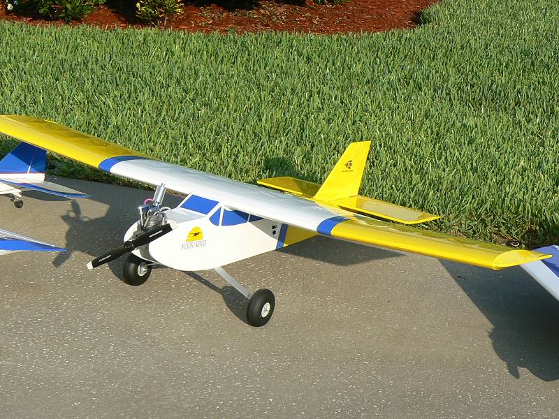

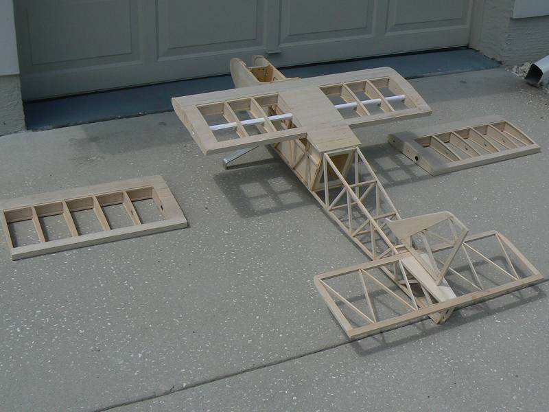

The Flyin' King has been out quite a number of years and lot of people have built them. I am starting this thread to show, when completed, a few changes I am making to the kit. Presently a bomb bay/candy drop mechanism is being built. I have a couple of Hobby Lobby's plastic bombs that may go on wing racks. This is my third BTE kit(previously Vortex and Venture). May 16th started taking items out of the box. May 23rd, one week's work.
See Post #17 below(today's date) for Maiden Flight Report

I'm using med CA in a lot of places(wing and stab construction). Bulkheads, landing gear mount, motor mount bulkhead, and other designated areas I'm using 30 min epoxy.

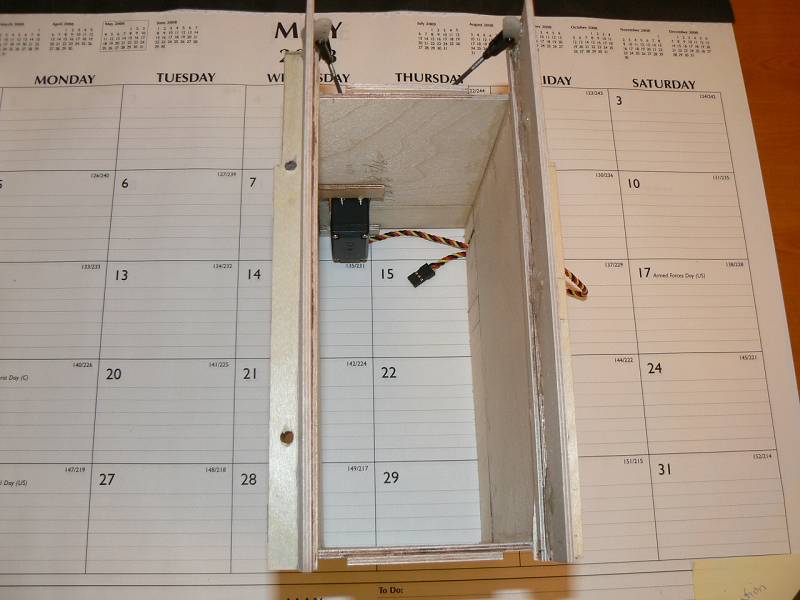

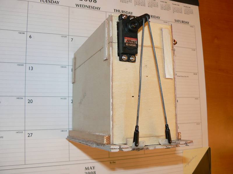

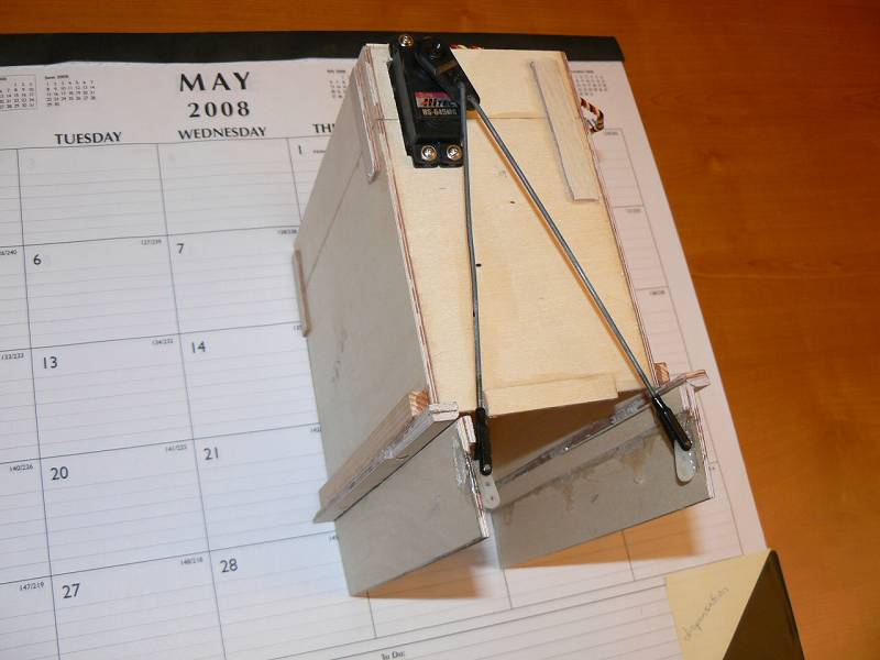

Here are pics of my prototype candy drop box. I will use it until after the build is finished when time allows making a better looking one. After building the original height of the box, I decided to relocate one fuse cross brace and then was able to make the box taller. Hence, you can see the added section at the top. The internal measurements are 3 1/2" wide X 7 1/2" long X 6" high. Also, there will be a cover hatch on top to preclude anything spilling out and into the fuse prior to release.

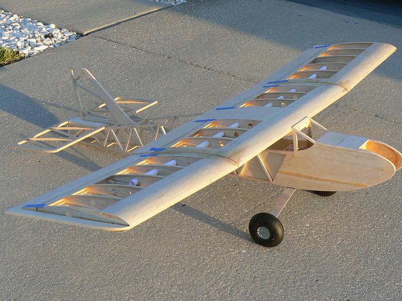

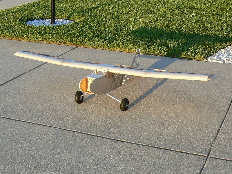

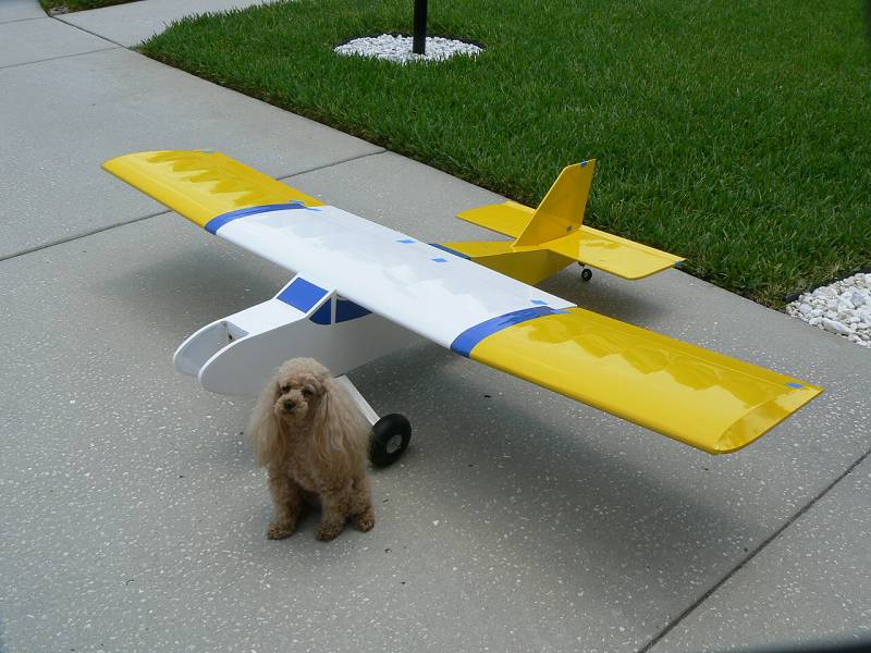

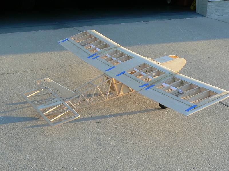

End of week two finds the ailerons and flaps built. The fuse is finished, the wings joined. Now the fun part. Trying to place the equipment to keep CG in range using the Saito 120. I'm using two aileron and two flap servos. Each on separate channels. With the bomb bay, I'll be using 8 channels initially.

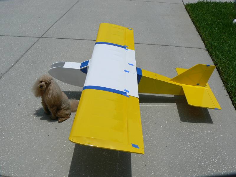

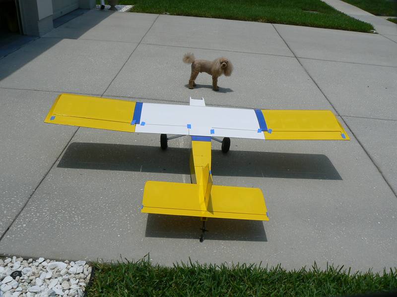

Three weeks and two days have passed with a lot of work and thought about equipment placement. All the parts are covered and assembly begins. Maybe in a couple of weeks she will have flown.
Oh, the pilot is getting to know his plane.

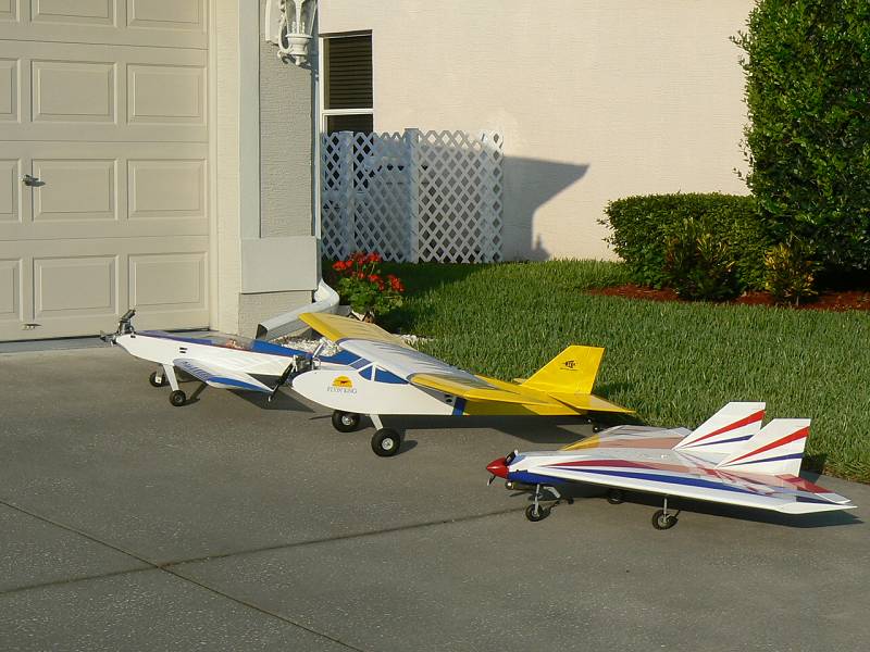

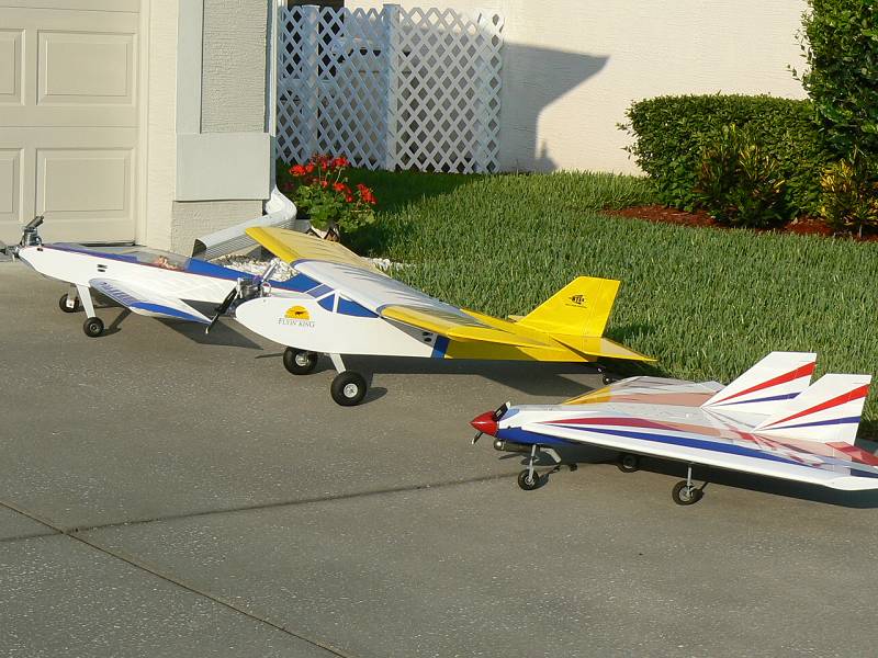

Four weeks and one day, 29 days, after starting the kit, she is done. About two weeks ago I stopped flying my Venture which is now my every day flyer. We all know that every airplane has an expiration date and I wanted to be able to photo all three Bruce Tharpe planes that I had built during the last 11 months. The Venture is an everyday flyer. The Vortex(Delta) is only for when I feel like an adrenalin rush. So now the Flyin' King is added to the fun side of the equation. Last night we had neighbors over for dinner and cards. They knew I was building the plane, but had not seen it. My wife said I should put some candy in the bomb bay. So while showing them the plane, I said "Watch this." I flipped the bomb bay switch on my transmitter and out fell a hand full of mints. They were duly impressed.
Another thing that is really impressive using the JR X9303 transmitter is the flap down and up times. I programed two seconds travel time. The flaps now extend and retract slowly just like a real airplane. Two seconds to the intermediate postion and two more seconds to full extension. Some down elevator for the flaps has been programed, but flight tests will be required to determine the proper amount of elevator trim for flap extension.
Today or tomorrow I will do the break in of the new Saito and hopefully this next week she will be airborne.
Here is a link to the Venture build, http://www.rcuniverse.com/forum/m_67...tm.htm#6792792
Here is a link to the Vortex build, http://www.rcuniverse.com/forum/m_13..._5/key_/tm.htm . My build info starts at post #102.
Here is a link to Bruce's site for all his planes, http://www.btemodels.com/flyin_king.html
