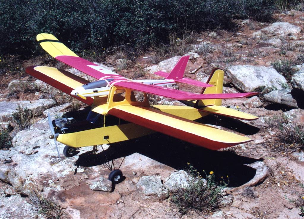

Here's mine. Barn door flaps and ailerons, 1/2 dihedral, Bomb drop door, tow release top center of wing, custom piggyback cradle for glider launch, conventional classic style tailfeathers and braced, tailwheel of course, Coverite and Randolph dope, OS 1.08. It's probably about 15 years old now and holding up well.

Hey AV - nice runway! Talk about a CGnightmare. Kadet Seniors are soooo modifyable. Our club has 1, 2 and 4 motor seniors. They pull gliders and drop candy. They carry cameras. What ever you need it to do.
Can you show a detail of your landing gear? I used a stout wire with standoffs to reinforce the flat aluminum gear. Kinda heavy.

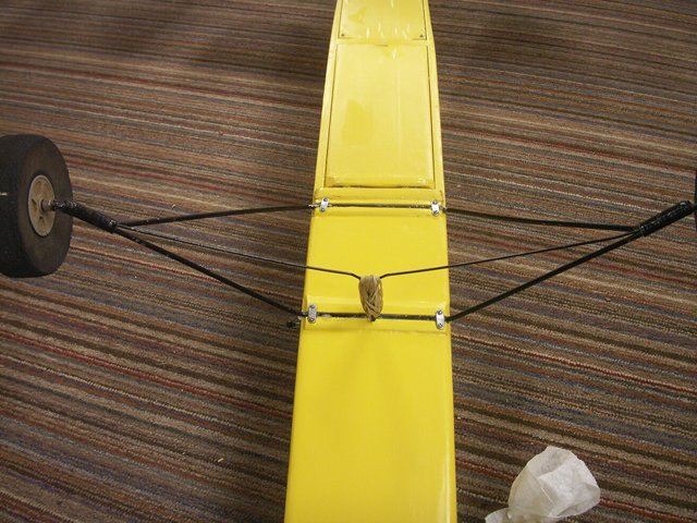

Yeah it takes big tires and a STOL airplane to use the runway at my home

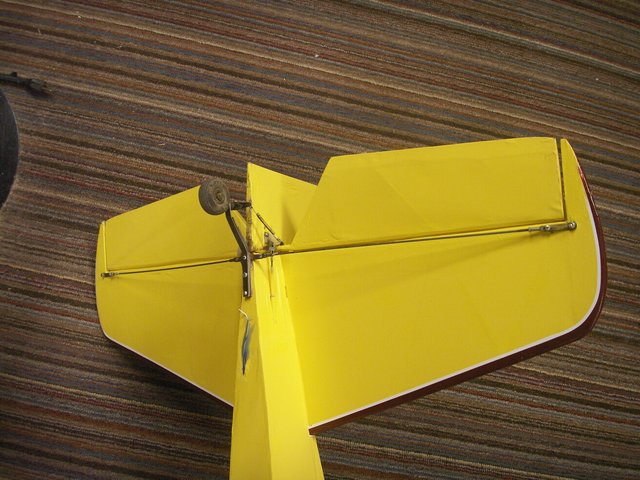

Here's the picture and also one of the tail and lower braces. The gear is really simple and could also be dressed up a bit by filling the "V" between the wires. Adjustable shocks by the quantity of rubber bands.

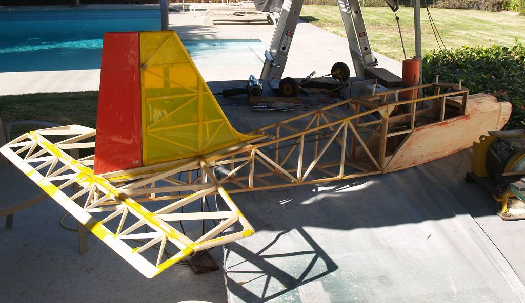

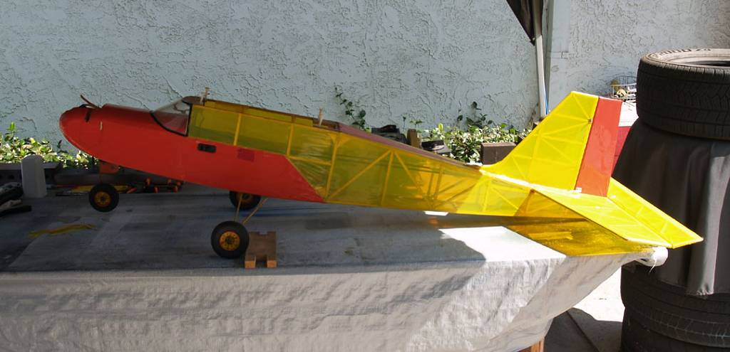

av8djc - It looks like you moved the fin back so that the rudder and elevator hinge lines were on the same plane and then dropped the rudder base to be flush with the fuse. That's one mod that I should have considered. Maybe the "next" senior build.
