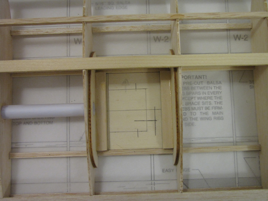

I installed the first aileron servo into the wing today.
Started by marking out where the servo will sit exactly relative to the servo bay – you’ll note the substantial grasp I have on technical drawing in the first photo.

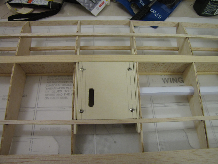

Then once I’d cut out a slot for the control horn it was a standard setup with hardwood standoffs to mount the servo and 4 servo screws to mount the cover.
I finished off by adding a drop or two of thin CA to all the screw holes.
I’m pleased with how this has come out – it’s not a complicated modification but it’s always rewarding to get a good result. I’d say I’ve built more strength into the area than is required, meaning more weight but not enough to be detrimental I shouldn’t think – and so the strength can only be an upside.

Looks good. Agreed, it's a little over engineered, but not rediculously so. I find every plane I build/rebuild, I learn something. This is one of those things you'll learn from and apply to your next build.
I too prefer to have my aileron servos "laying down" like yours. It seems a cleaner look, IMO.
