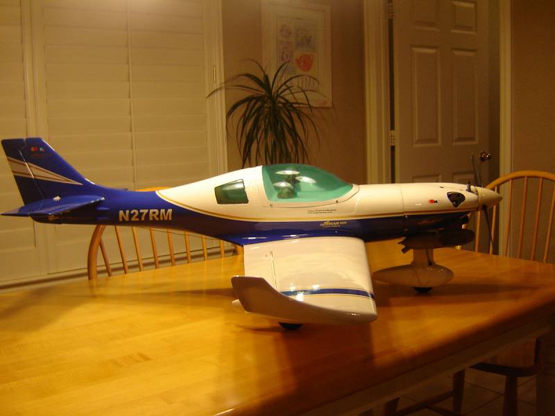

I'm putting one together with an MDS68.
It appears to be about 8.5" ground clearance to the prop shaft so even a 13 inch prop should be ok.
Overall it looks pretty good for an inexpensive ARF.
Getting a wider engine entailed making clearance in the motor mount so it could go against the the upper nose gear block with clearance to get at the collar holding it in place. The engine is a tight fit and I'll probably have to cut up the cowl quite a bit.
I expect to have assembly done in a couple more days.

Some things I noticed in the construction.
Need to make clearance in the motor mount for the nose gear on an MDS 68 or any large engine
Dont forget the 2 washers under the left side holes of the motor mount to get the thrust (not built into firewall)
CMP measurement for face of prop to firewall too large - measure first - I have more than 1/4" gap - I'll leave it for now
With the large engine I needed tail weight so I cantelevered the 2100 NiMH 5 cell pack off the back of the servo tray in the middle of the Fuse with a Lowes paint stirrer - this will reduce need for dead weight in the plane - at 70mm will target 72 - 75 from leading edge by adding a little more weigt to the stirrer.
Trying TowerPro Digital (they call them digital) w/995 MG - better than expected for $13 ea.
Put the nose wheelpants on before putting the gear on the plane.
Zap a Dap a Goo works well for Front wheelpants components as well as rear windows (dont use old glue in a 40 degree garage)
Replace the wing screws with 1/4 - 20 nylon - ease of replacement
Elevate the rudder servo further and cris cross the rudder pull pull wires to get the right exit angles as well as the rudder matching the correct steering direction
Make rod standoffs for steering and throttle servos as appropriate - did not use one on the rigid (CF) elevator rod

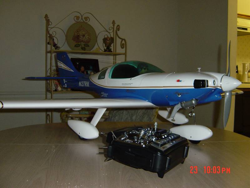

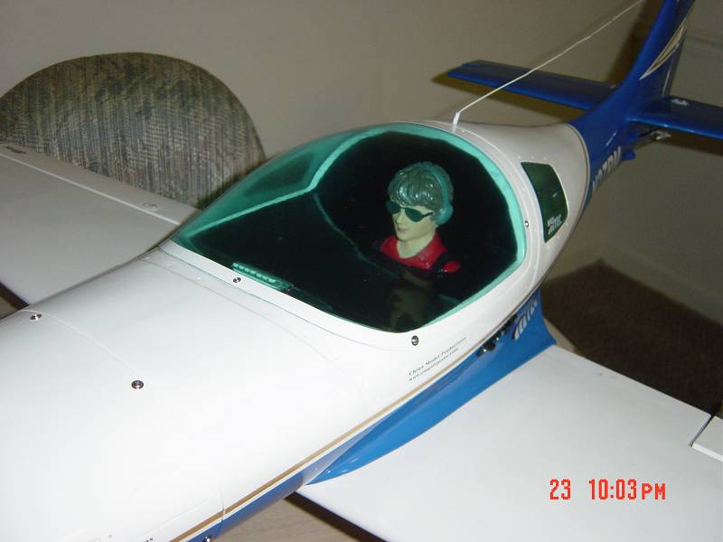

First pics

Old 01-15-2007, 11:47 PM

More pics

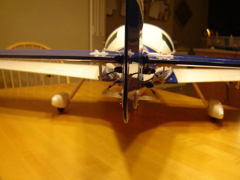

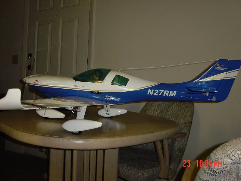

A few more

Wow!
What a slick looking plane! Thanks for the pics and the construction advice. That cowl really hides the engine well, doesn't it? So you think it'll cool ok? I hope so, that's really clean....
I'm hoping to get one on the way before too long.

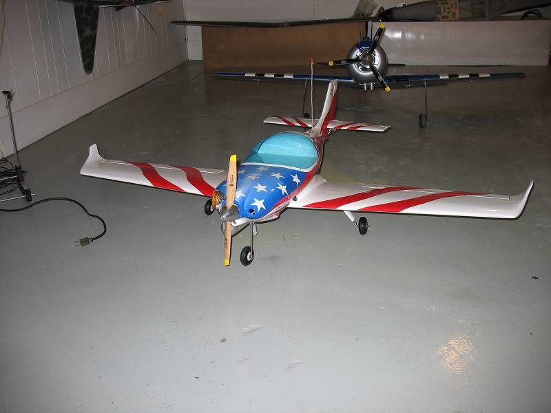

Hey guys thought I would chime in on this little gem. I have the stars and stripes version. First off this is a sweet flying plane and very responsive. I run a GMS .61 in mine and it hauls a@@. Landings are a little hot so be prepared. The plane is so aerodynamically clean that it takes a long time to bleed off speed. Just make a longer landing approach than normal and you will be fine. The plane comes in extremely nose heavy when using the .61 size motor so a lot of weight had to be added to the rear. I will post pictures. He is right about the distance from the engine backplate to the firewall. It is way off. I also have 1/4" gap and it looks ugly but I am going to leave it because it would require rebalancing. I can save you both the trouble of rebending the front landing gear, just replace it now. Way too weak. I fly off grass and it is cut extremely short and the wheel pants had to go. That sucked because they look sweet. If you insist on using the stock front gear and the wheel pants the first time it bends it will crack the bottom of the fuse. Ask me how I know. Once you get her trimmed out it is an awesome sight in the air. Very fast and nimble. Rolls can be very fast if you choose and loops can be as well. If you want to know the measurements of the control surface movements that I have just let me know. I can try to answer any more questions that you think of. Good luck on the maidens. One more thing I almost forgot. On take off the plane actually sticks to the ground. You have to fly this one off. Be careful because at takeoff speeds it can get squirrley as she has a short wheelbase. I flipped a couple of times figuring this out. RCU won't let me upload pics. I will try later.

Hey virtual,
Please post actual throws and cg you are flying with. Pictures would be great also.
Based on your experience, i'll probably use the current nose gear for show and drop in a spare Fults (dual leg) nose setup for flying.

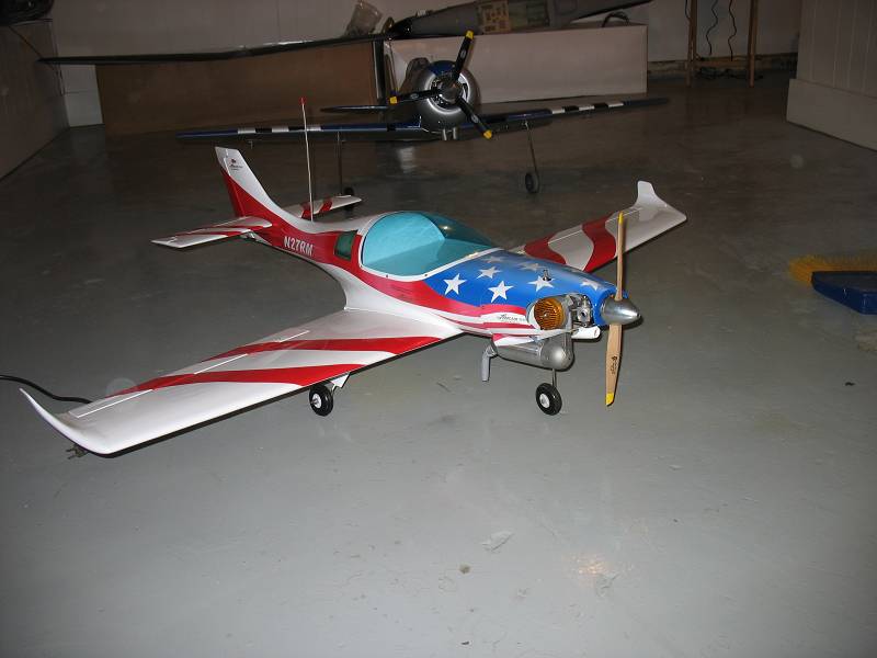

I will try to post pictures. The c.g. I am using is 72mm spot on on the great planes c.g. machine. The elevator has 8mm of movement both directions. The ailerons 10mm both directions. Max throw on the rudder. Believe me that is more than enough to control it. This provides very good roll rate and believe it or not tight loops if you want to.

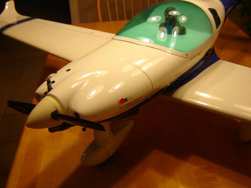

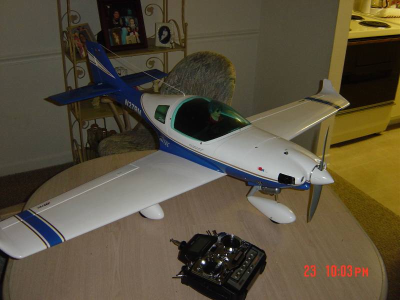

Hi there guys well my bird did have the same ploblems with the nose gear, but for the CG it was 21 grams needed in the tail to have her CG,im flying with a ys fz63 super charged four stroke swinging a 11x8 prop and man is it fast !take offs are easy but landings are really fast and im on a asfault runway thats long.i`ve had mine for about a month so for and i love it im planing to replace the nose gear but unsure whats a good choice for this fast mover, please help P.S. here are some pics of her
