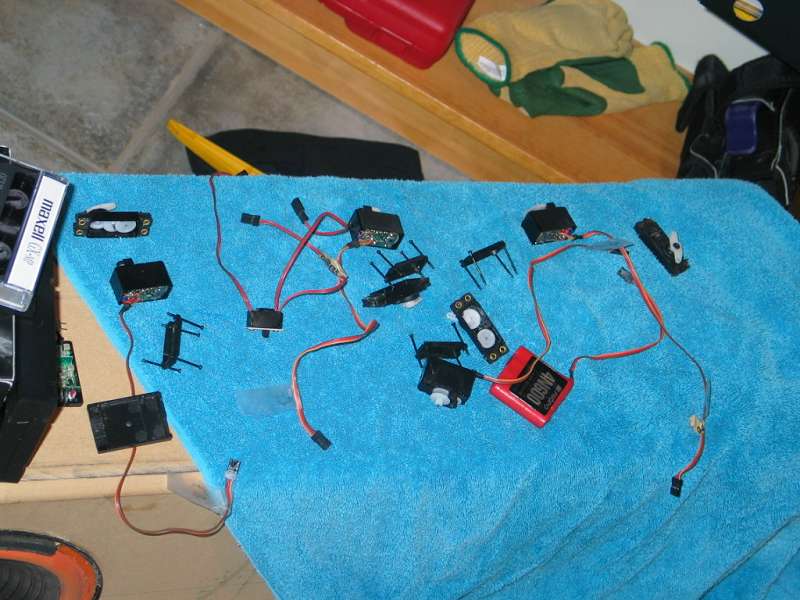

I finally finished my scratch airboat enough that I could take it out and do some test runs on the design. This is not your ordinary airboat, it is a twin engine design spinning 11x7 props with a total of .80ci of displacement. The hull is foam that has been covered in 4oz cloth and reinforced in areas with 6oz. The design of the hull is almost tunnel hull like with a channel running down the middle. Hull lenght is 36inches width is 14 inches. This lead for a very tippy model that had generous amounts of steering power from two large air rudders. This boat tracks very well at speed and holds extremely well in corners. It held so well that in one corner I rolled the boat. Quick grab the inflatable!!!! Below is a pic of my boat after she rolled over, and of my servos drying out.

One more thing CANADIANJOSH ,
You might want to try using CORROSION X on your radio gear .... it water-proofs the servos and Rx . Just open your servos like you have , then fill with corrison x , leave for about 5 to ten minutes to makes sure that its soaked in , then tip them over and drain over-night . Put your servos / Rx back together and wha-la .. water proofed .

terbobob, corrosion x is not a water proofer, but it is a water displacer... it doesnt "water proof" things just gets rid of the water on things when they do take a drink.

Ok ... whatever ..... it SEALS the "electronics" by coating them , FROM the water ....
Better now ?
And FTR - it "displaced" the water pretty good on mine when my mono took a dunk ( straight down to the bottom ...
And seeing how I run OPEN servos in all my boats ( meaning no radio box ) , to me , the CORROSION X 'water-proofs . ( or as you are saying - "displaces" the water . Which is fine , but which ever wording you choose , it still prevents the water from wrecking havoc on your electronics and possibly causing signal IF , or loss of control over your boat . )
If you meant that you would STILL have to dry out your radio gear , then , yes , by all means , you are correct . This does NOT provide a seal on the plastic casing on either the Rx or the servos , but rather JUST the electronics parts .
So , maybe my choice of wording was improper , but the over-all effect is that your electronics don;t get ruined , shorted , OR get messed with IF you DO get water inside them .

ive used it before i ran and had gotten water inside a servo, and well.. the servo stopped workin.. AFTER i sprayed it again , it came back to life.. so waterproofing and displacing water are 2 different things..
There is a spray that amsoil makes that does water proof (i have since changed from cx to the amsoil spray) that works perfect.. i have intentionally takin a junk servo and some old radio gear, sprayed it with the amsoil spray sat it in the sink (underwater) and she worked while submerged.. great product, and cheaper than corrosionx

CANADIANJOSH, if you would want some peice of mind, theres a simple way to really waterproof your servo's.. it looks a little goofy but it does the job. Take the top of your servo's off (where the gears are) and pack it with alot of grease or vasaline or some kinda grease type substance. Then reassemble the servo, and tape off your output shaft and dip it into some of that rubberizing stuff ya get at home depot. Its used for rubberizing handles of pliars or misc things.. but works good, and ya dont have anymore problems with water
Hope this helps ya!

i run open servo's also and i drill a small hole at the side bottom and give it a little squirt every now and then with some corrosion blocker. servos' seem to build condensation and with out the hole it has no where to go.
