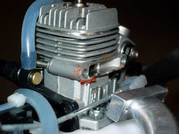

Well Kirk thats good, anyway im going to just take off my mousse can muffler and switch to the famous MAS blue prop. I do need to figure out how to fix this hole i have in my engine near the exhaust outlet. 2 stoke goo is just going everwhere!!!

You have a hole in your engine? Is it just a loose fit between the muffler and case, or something larger? If it's just a loose fit, try using some RTV to make a gasket for the muffler. If it's something like a chip then you should be able to fill it with JB Weld. Just make sure to clean it off really well first.

I dont know if you would call it an hole or a chip on the exhaust outlet. Maybe this picture could clear it up. So far ive tried RTV w/ paper gasket, and just RTV. The nitro just breaks the RTV down when running. Maybe JB weld could fix it for a longer period of time.

Yeah, looks like a job for JB Weld. Just make sure to get all the oil and such off first. I've used JB weld to seal up pressure tap holes on mufflers to move the tap to another location.

That looks like a Megatech to me, and as always, I don't look any closer, as long at the RPM is good.
And yeah, that chip looked a lot like a drill bit got away from someone when doing mounting holes

Yeah that chip was all my fault. Actually the head of the screw didn't make it past the exhaust outlet when i was trying to take the motor off and then it happend. chris you were 100% correct.
