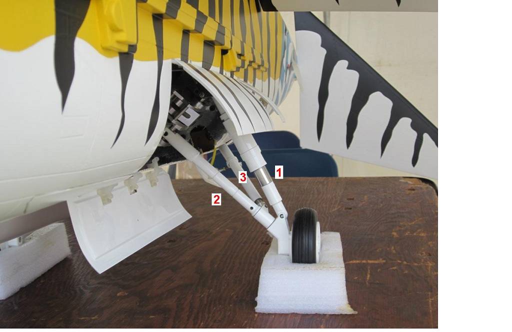

Jim,
It sounds like you are saying that the gear mounts bolt to the former that is completely constructed with honeycomb core, is this true? If so, that is a very bad practice. In all applications where sandwich composite construction is used, the core MUST be replaced with a crush-proof material, like aircraft plywood, at every place where something is through-bolted to the structure. If this is not done, the strength of the structure is severely compromised.
Bob
Bob

Bob,
I saw no indication that the honeycomb core was replaced with a crush-resistant material (eg hardwood or aircraft ply) in the area of the landing gear mounting bolts. The red-lined photo that Oli posted states that indeed it is done. OK, fair enough.
I have to wonder though since there are so many holes and cutouts in that former (particularly in the lower area around the holes for the gear cylinders) that local reinforcing is more problematic than practical. You can see the honeycomb in the U-shaped cutout for the turbine partially filled with potting compound so any reinforcement would be local which gives rise to the issue of accurately locating the reinforcement pieces during the layup process. The mounting holes are much closer to the cutout in my photo than in the photo Oli posted so perhaps the cutout on the plane I examined was cut oversized. An edge margin (L/D) of at least 3 would be appropriate and that didn't appear to have been achieved.
The wing/stabilizer layups seem structurally questionable as well. I noticed some earlier comments/photos on the FEJ announcement 2011 thread that seem to be particularly appropriate.
Apart from the obvious structural design issues, there is also the issue of consistant application of adhesive during the layup process, not to mention the landing gear design. I was also concerned about photos from FEJ stating that they inject foam in spar boxes. Foam isn't noted for it's strength therefore it's applicability in such high stress areas is questionable.
I'm standing by my earlier statement of "I think that the use of honeycomb core technology is an interesting innovation but it needs to be applied correctly and with appropriate design and quality control. There appears to be significant issues with the model's structure which could lead to catastrophic failure."

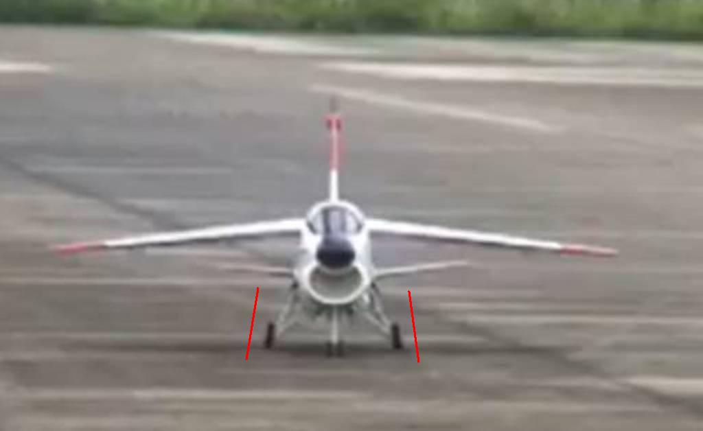

#61
My Feedback: (55)
RE: New A7 from FEJ
This gear looks pretty sturdy to me. The sink rate was greater and touchdown firmer for sure at 1:38 in this clip http://www.youtube.com/watch?v=jJsGftJZmww than was the landing with my My SM L-39 yesterday, and the left gear folded right up. Won't hijack the thread with details.
#62
RE: New A7 from FEJ
Hey Sluggo,
Yeah, it was a bit of a hard touchdown at 1:38 and the plane bounced up in the air. The gear didn't collapse (which is always good) and the plane taxied back. If you check out the video at about 2:06, you get a head on view of the plane (see picture below). The wheels are tilted in about 12 degrees after that landing (the wheels in the unflown tiger-stripe model are vertical - see photo in post ) so the landing gear did sustain damage - likely bending of Strut 2 or the axle/housing.
Of course, no landing gear can be built strong enough to repeatedly absorb the worst landings we can all do on our bad-landing days (and I certainly have had a few of those). However, the design of this gear is fundementally not very strong as it relies on a single a small pin to to transfer all vertical forces from landing. While it didn't shear in this video, there was other damage to the gear and it's quite possible that the lugs (through which the pin fits) which are made of aluminum, would be damaged as well not to mention any damage done to the upper part of the gear (the retract shaft and the retract downlock/mechanism).
Regards,
Jim
Regards,
Jim
