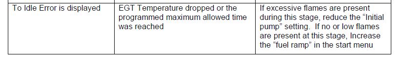

I started up my rabbit for the 1st last night, and after the 3-4 step it shut down ..... And it was reading Idol ERROR???? Was this something I did wrong when I paired up my transmitter? If so how can I fix it?

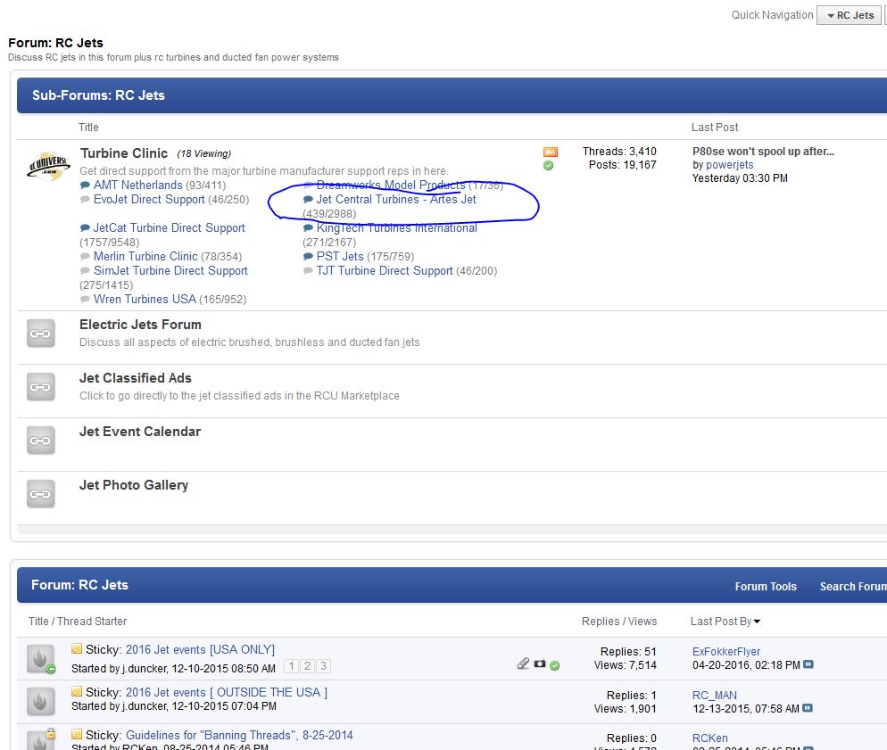

Welcome to the Jet Central family, Jet Central has a specific form that they monitor on a regular basis for posting questions that you may want to consider
Hello Baldhead
"To Idle Error" means that turbine is not getting to idle on a pre programed time
To avoid that you only need to increase the fuel a little
Go to Start menue and increase the initial fuel a couple of points and one point in the fuel ramp
That should solve the problem
Regards
