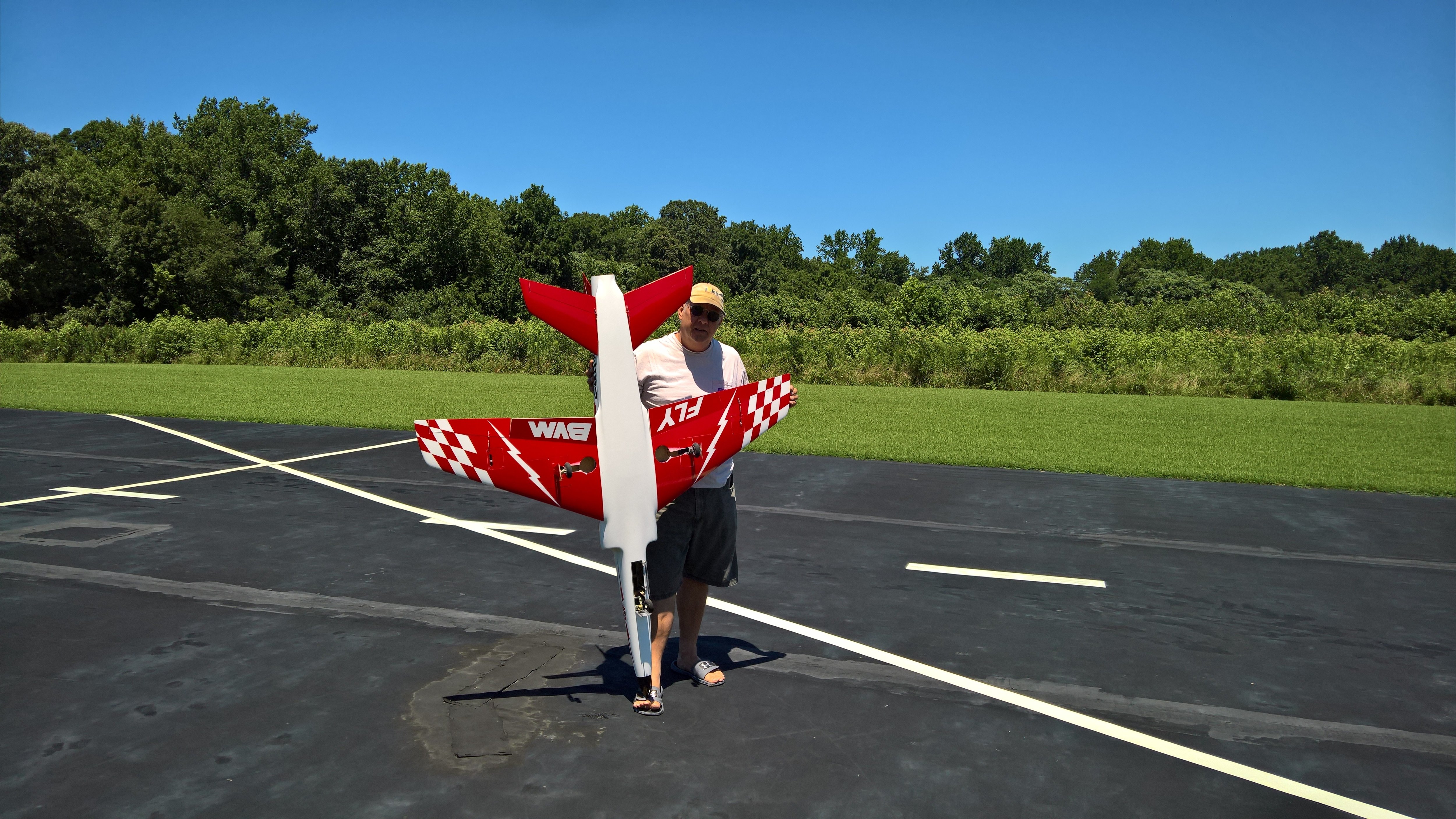

This Electra started as a white ARF, your plan will work fine!
ID:	2226216   Click image for larger version
