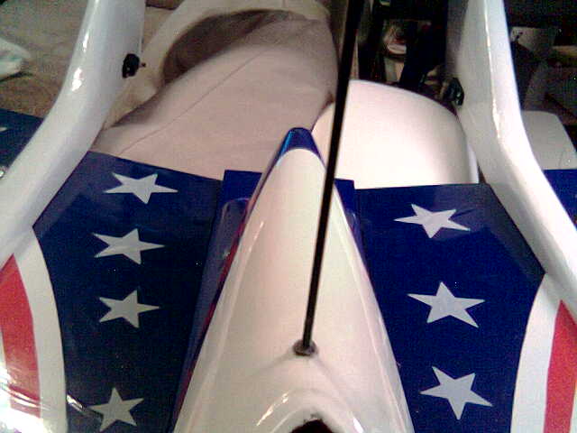

What size turbine ? We are goning to put my PST600r on it when my new turbine arrives for the XL. Look at the mounts that i think will work perfect, i think my base mount is going to be made out of wood.
Also check out the $3.50 antenna mount that i got from HobbyTown's car section, this way you don't have to cut your antenna.

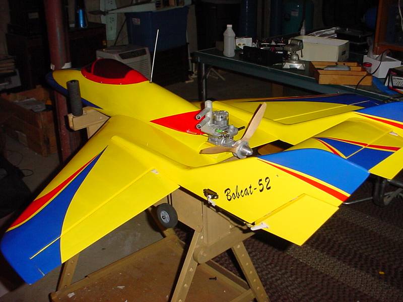

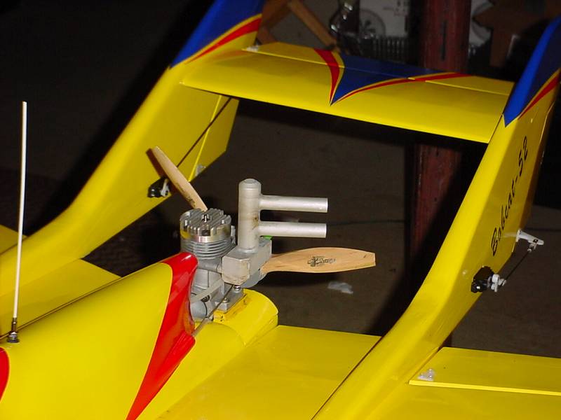

I have gotten some more flights in on mine since the engine conversion. The 75 two stroke does a good job. I am going to mess with prop pitches a little but all in all it's a winner. The problem now is the main landing gear. No matter how good a landing I have the gear bends back. After three landings I have to take it out and bend it back. Is anyone else having the same problem and if so have you done anything to fix it?
Bassman

ORIGINAL: bassman
Bassman
Replace it! thats What i did. and a Faust nose gear up front.
The landing gear blocks are not glued in very well, soon onemay fail on you.

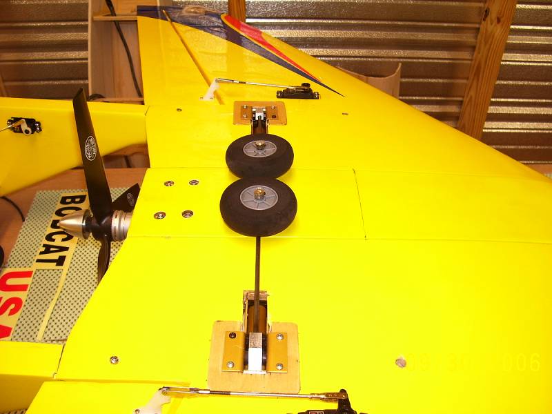

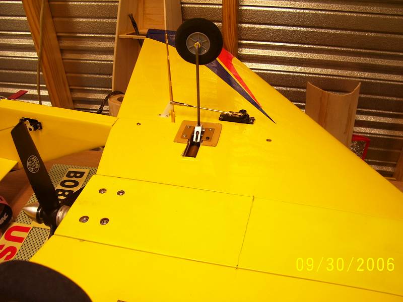

Hi
This is my “Nitro models pusher Bobcatâ€.
Check the main gear retracts. I did not sink the wheels into the wing or fuselage.
The placement of the retract did not interfere with any of the wing structure.
This let me put a trimmed Master Airscrew 14x7 3-Blade Pusher on the O.S. 91.
This combo moves out!!!!!
The comets at the field was “except for the sound it just like a turbine jetâ€
I also agree.
Johnny
