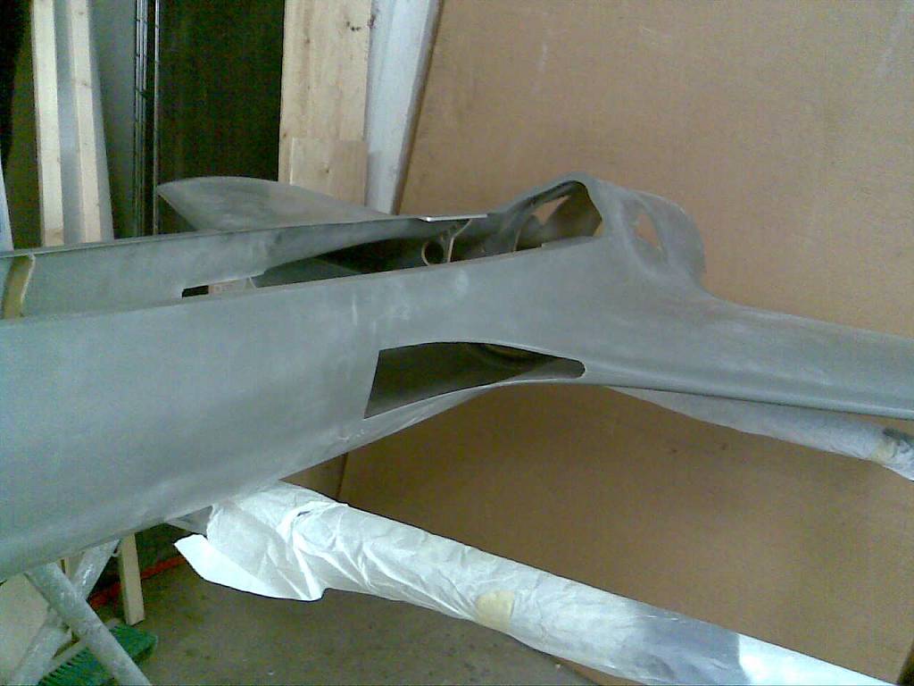

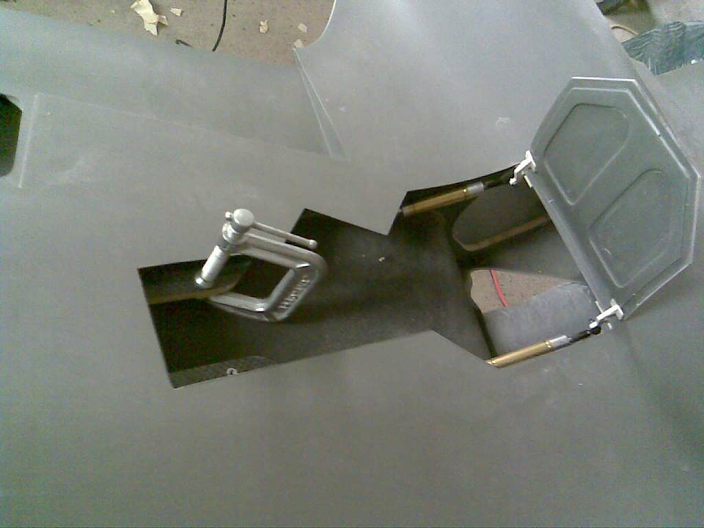

I started out by measuring in the 1/2" flange around the hatch to cut it out. This includes a 3/4" wide section at the rear. It measures 2" from the rear corner of the hatch and is 5" long.

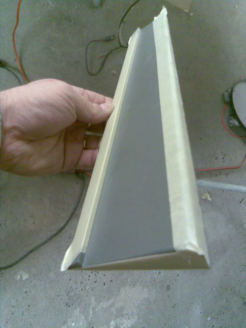

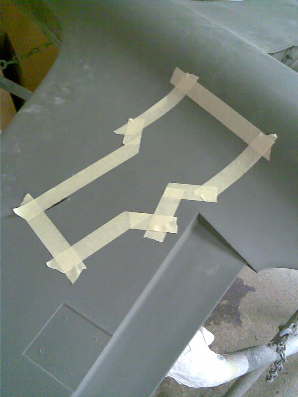

Next I masked along one of the premarked edges of the gear cutouts. Almost all of the cutouts required are marked with a fine line in the fiberglass to guide you, no measuring needed. I just masked along the edge so I could see it better while I cut it out.

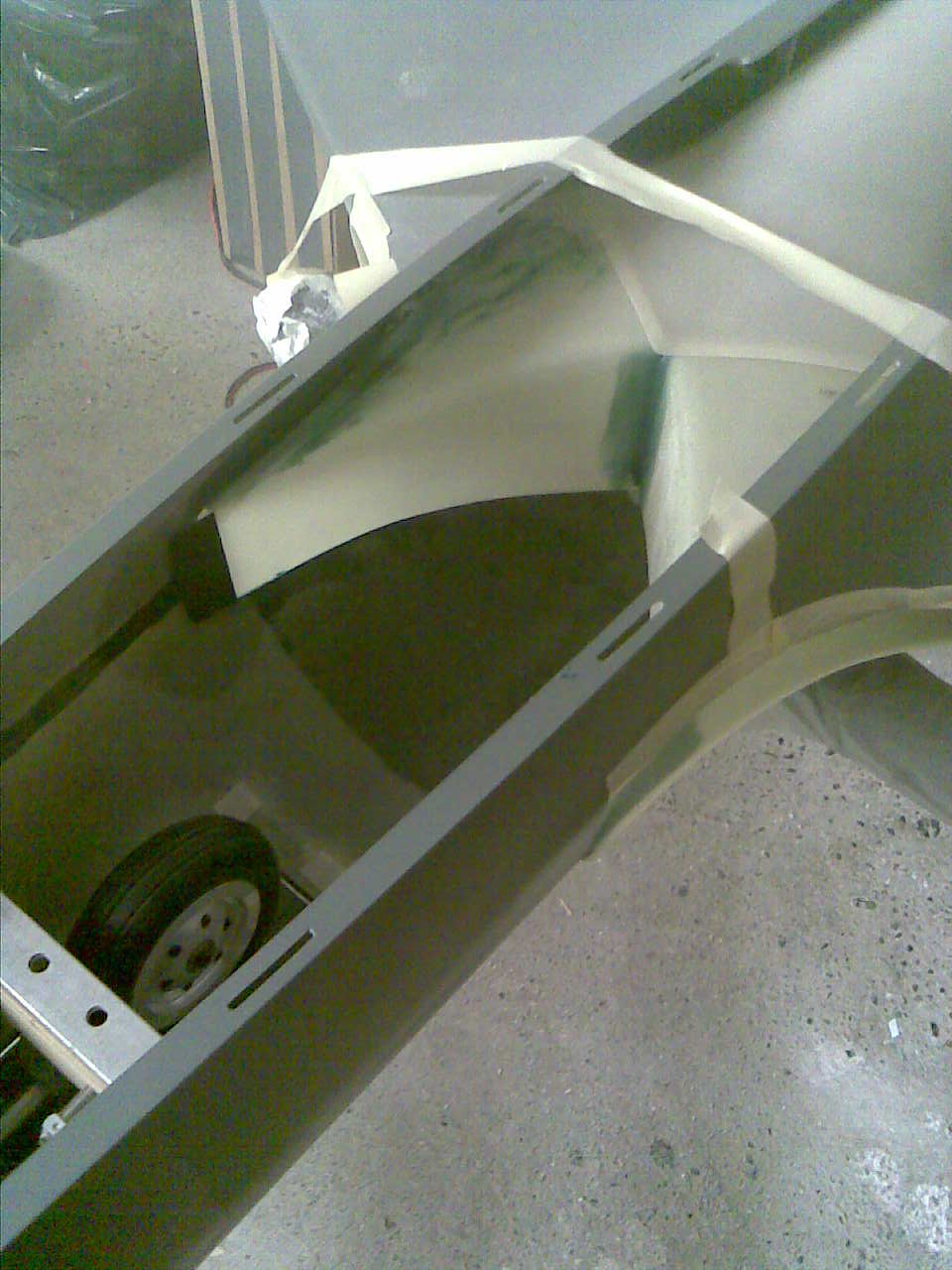

Picture 3.
Here is one of the main gear cutouts completed.

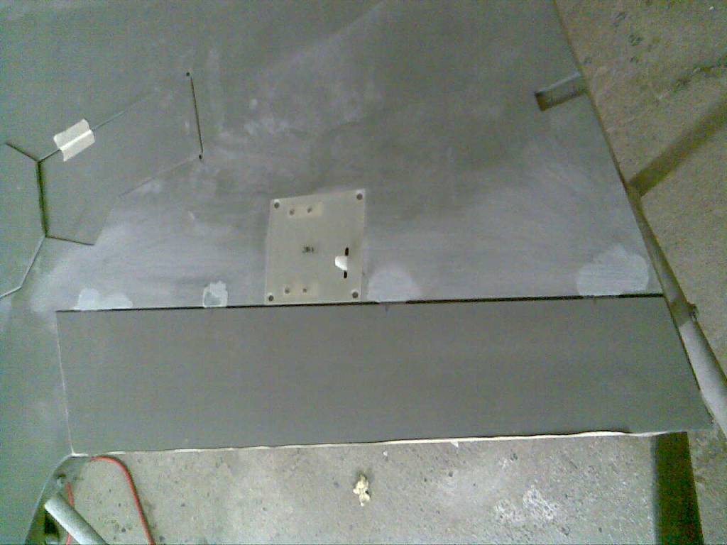

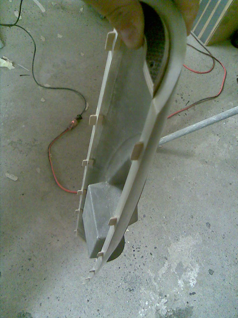

Picture 4 and 5.

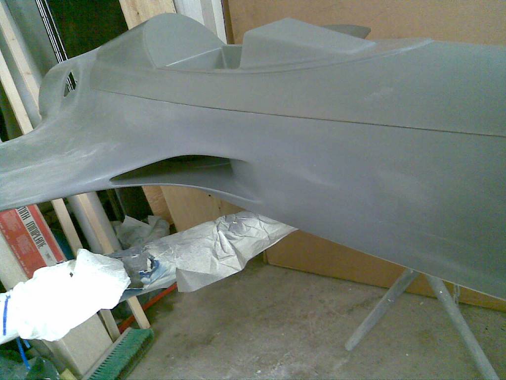

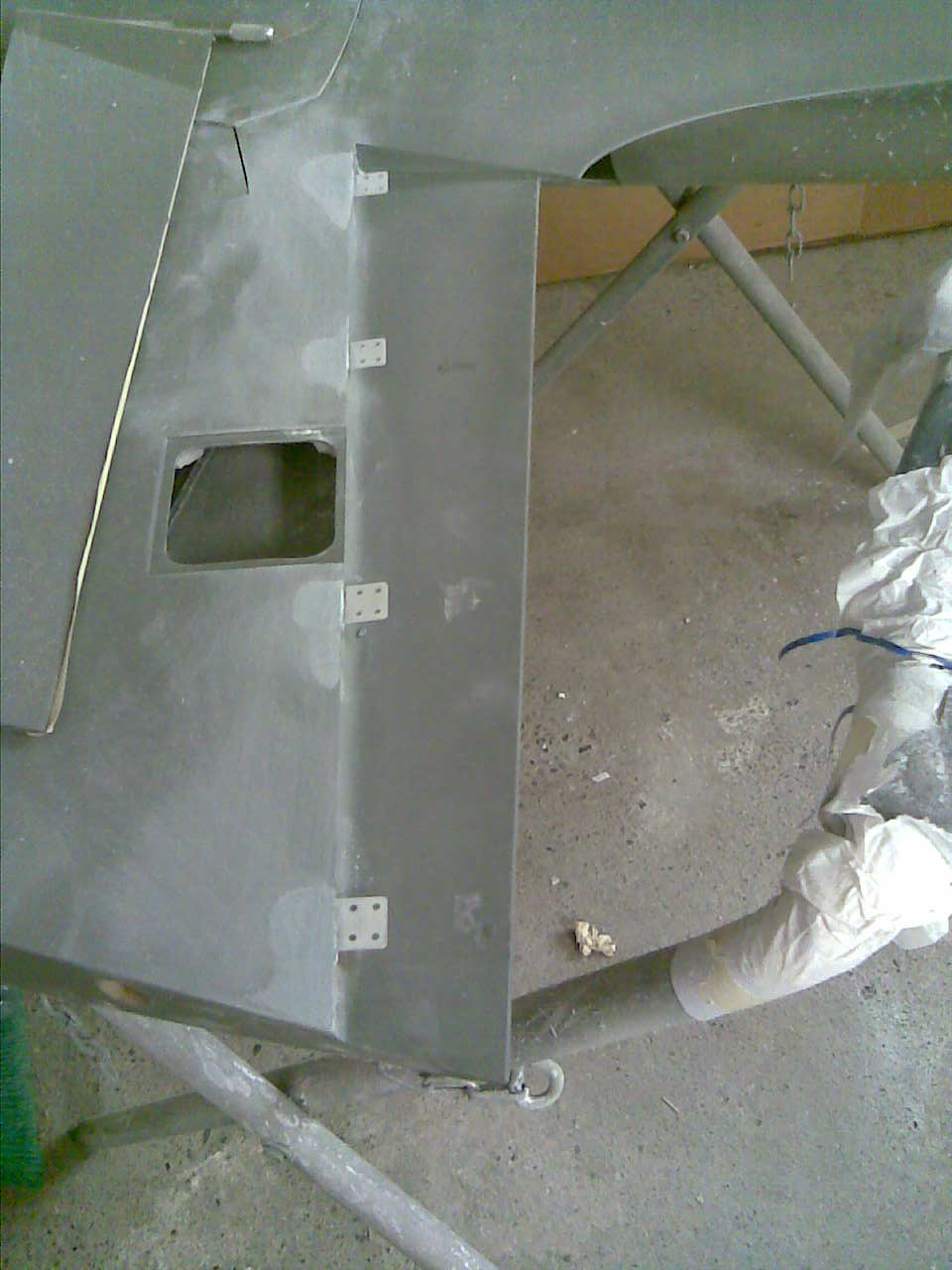

Here is the inside of the fuse looking at where the nose gear cutout will be made. Notice that there are already reinforcements molded into the fuse for the screws. This is great, I hate having to glue things like that in after the fact!
Picture 6.
Here is the recessed flange with the cutout.

Here are the inlets cut out, you can also see the top hatch opening cut out in these pictures.

Here is the flap pocket opening cut out. Again, there is already reinforcement in the corners for the screws that will hold the hatches on.

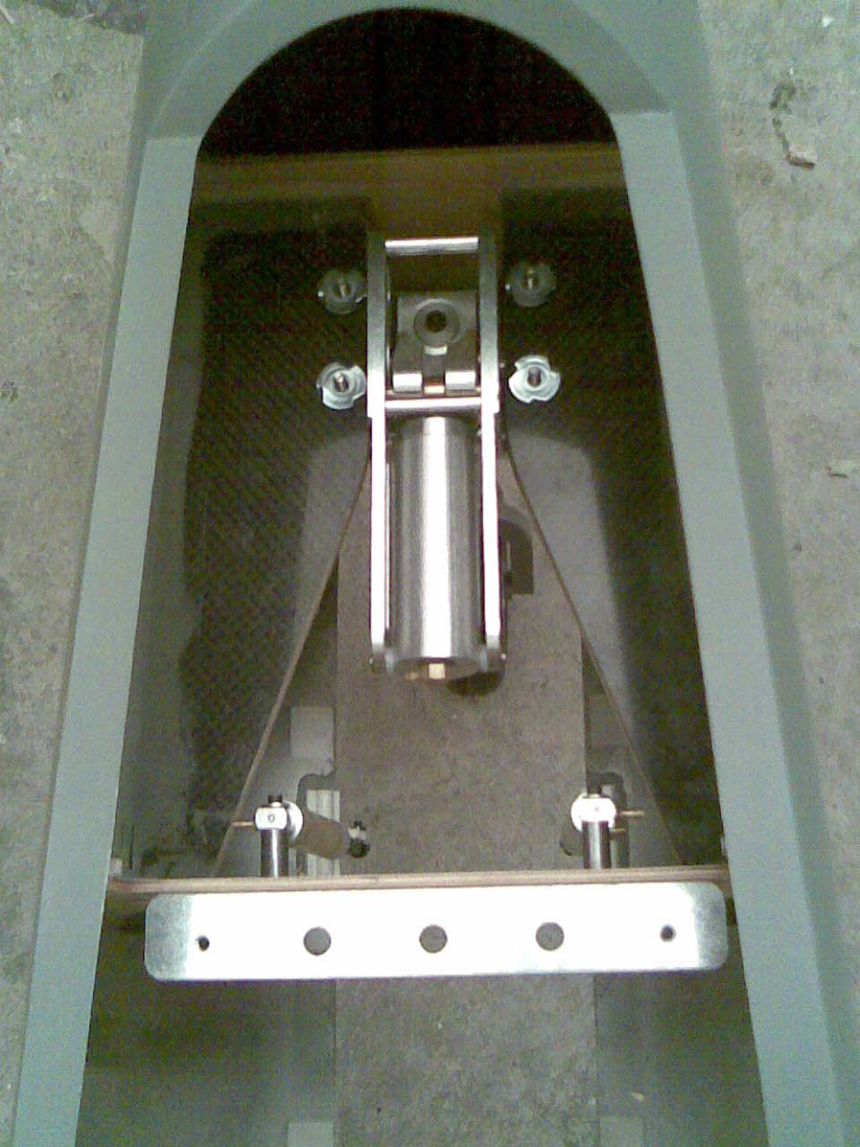

First thing I did was cut the nose gear door flange for clearance for the hinges. Everything fits sweet in that recess, I had to order a 3-48 tap so I haven't drilled and tapped the holes for holding the door plate in place, as such, it's just taped.
Picture 2.
Here is a picture of the nose gear doors closed, the gaps are nice and tight, probably a touch to tight, I'll open them up a bit to leave room for paint. To make them nice and tight, I first cut out the gear doors, this left less than perfect lines. I block sanded all the edges to get them nice and straight. Then I masked off the door frame with one layer of masking tape. I then taped the doors back into the frame from the inside. When I was satisfied with the alignment I filled the gaps with polyester body filler. Once that dries, remove the tape holding the doors in and pop the doors out. The body fill doesn't stick well to the masking tape. Then a couple quick swipes with sandpaper and you have a perfect gap all the way around!

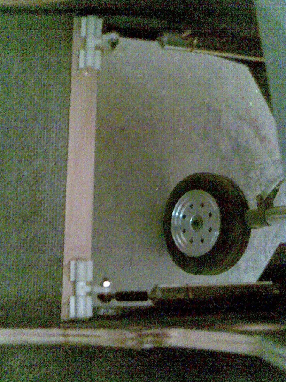

The gear door cylinders needed to be shorted 1/4", I wrapped some tape around a pair of needle nose pliers so I wouldn't mark the rod and removed the links. I then marked how much I needed to cut off with some tape on the threads.

Ok, got a little bit done today.
I haven't been totally sure what engine I'm going to use yet so I didn't want to mount anything to the lower bypass cover. Having said that I didn't want to have to stop building because of lack of an engine choice. I discovered that I can still get the lower bypass cover out of the jet once the inlets are glued in place. So the first thing I had to do was come up with a temporary method of securing the lower cover. A couple of screws was what I decided on, When I put the bypass cover in place after the jet is finished I will glue it in with some silicone and also glue it to the inlets with some silicone and use the same screws.
Picture 1.
The first thing I had to do was align the lower cover, the rear half is aligned by the rear bulkhead, but the front needs to be centered. To do this I taped a carbon rod to an adjustable T square so I could line up the front point of the bypass.
Picture 2.
Once it was aligned, I drilled 2 small holes through the cover into the wooden bulkheads and secured it with a couple of small screws.
Picture 3 & 4.
After a bunch of test fitting, sanding, tack gluing etc, I was finally ready to glue them in place. I used a product called Everglass, it is a polyester resin with finely chopped fiberglass that has the consistency of bondo. I used this to permanently glue the inlets in place. The only downside to it is it's ugly, but some sanding and paint will cure that. In order to get the inlets to fit to the bypass perfectly I needed to extend the front of them a tiny bit, this could probably have just been done with fiberglass cloth as outlined in the manual, but I used a couple pieces of carbon fiber that I had layed up already. (these are the black pieces in the picture)
Picture 5 & 6.
Once the everglass was dry, I laid a piece of fiberglass cloth over the front joint and over the carbon extension.
Picture 7 & 8.
Then, some filling and sanding on the outside, and a quick coat of primer to see how things are, and the inlets are looking pretty darn nice!!!

Ok, so onto the next step, I had very little time today as I had to airbrush and clear coat a Harley, but in between Kandy coats and clear I got the flaps installed on the Firebird.
I did deviate a little from the instructions here to a method I've used in the past that is bullet proof.
In the instructions you are told to cut slots for the hinges in the flaps and the flap pocket. I was able to easily cut the slots into the flaps themselves, but the pockets were tough. I didn't have the right cutter to get the slot deep enough for the hinges so I used a slightly different method, I have no fear in this method, it is at least as secure as the one in the instructions.
Picture 1.
First I put 3 layers of tape on the inboard root of the flap, as well as along the lip on the back of the flap. I also put tape along the LE of the flap to guide me for the slots. The reason for the 3 layers of tape is to leave a nice even gap all around and leave room for paint so that things don't end up to tight after painting.
Picture 2.
The I cut the slots 1/32" away from the lower flap skin with a dremel cut off wheel.
Unfortunately my phone battery died (yes, camera phone, I know, it sucks) so while I waited for it to charge I got a couple of other steps done.
Step 1.
I transfered the hinge locations to the fuse along the flap pocket. I tried cutting the slots again with the dremel, but with the large support blocks in the fuse I couldn't get the slots deep enough to put the hinges into. So I went on to method 2.
Step 2.
Once I had the hinge locations transfered, and drawn on the skin the correct size, I routed the lower skin away where the hinges needed to go. I went the thickness of the hinge plus 1/32" deep so the slot lined up with the flap.
Step 3.
I then glued the hinges into the flap hinge pocket I created. Once that glue had set, I drilled a hole through the hinge, I then put a small screw through the hinge into the wooden block that is already installed in the fuse.
Picture 3.
This picture shows the hinges glued into the flap pocket, filled over the top with the same Everglass milled fiberglass I used for the inlets and sanded out again. I don't care how hard you pull those hinges, they are not coming out without destroying the fuse.
Picture 4 and 5.
Here are the flaps now slid back onto the hinges. I will glue them after I paint the inside of the flaps and flap pockets. I'm going to paint the inside of those now, then mask them off to paint the rest of the airplane. This way I can still easily glue the flaps on, pin the hinges, and fill, sand and prime everything plus have a perfect paint finish inside the flaps.
Picture 6.
Here are the flaps from behind, drooped down a bit from gravity.
Flap Linkages and horns will be next, then I'll paint the inside of the flaps and glue them on.
