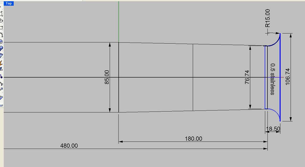

BJ,
Both of the tailpipes I built used the John Wright thrust augmenting pipe design. They were used for a Jetcat Titan and a Merlin 160.
They were about 86mm @ the inlet, tapering up to 96mm (at about 180mm from the inlet) and then 96mm all the way to the exit. On a test stand I measured about a 5# increase in thrust (over no tailpipe at all) with the Titan but never tried the Merlin on the stand.

Would those dimensions work on a 30lb thrust Turbine?
(I think the Merlin is 38lbs??)
BJ
Join Date: Jun 2009
Location: Melbourne, AUSTRALIA
Posts: 1,505
RE: How To Build RC Jet Turbine Exhaust Tubes
ORIGINAL: grbaker
BJ
I used the same specs on the pipe I used on the Titan and it was only putting out 27# without the pipe and about 321# with. I suspect it would work well for yours..
BJ
I'll use those dims to build my pipes with then.
The 96mm diameter is perfect - the only 316 0.010" stainless I can get at a reasonable price is 305mm wide (by 1m long), so 96mm will need 301.4 of sheet. Which leaves 3-4mm overlap to spot-weld on.
I'd be more comfortable if the sheet was 310mm wide - just to give me a bit more room to move in, but I might just be able to squeeze it using the 305mm stuff.
There is one other place that I can get 316 0.010 stainless from, and it's 600mm wide - but they have a AU$60 cutting fee on top of the sheet price, which brings it closer to 200 bucks a sheet. And I'd end up with about 290mm left over that would be next to useless.
Do you have any suggestions on how to make the bellmouth on the tailpipe at the Turbine end? They look like about a 1cm flange affair...
Oh, one more question: What distance do you space the start of the tailpipe from the tip of the Turbine's exhaust cone? From a lot of pics I've seen, it looks to be around 15-20mm.
Thanks again for your help on this - much appreciated...
BJ

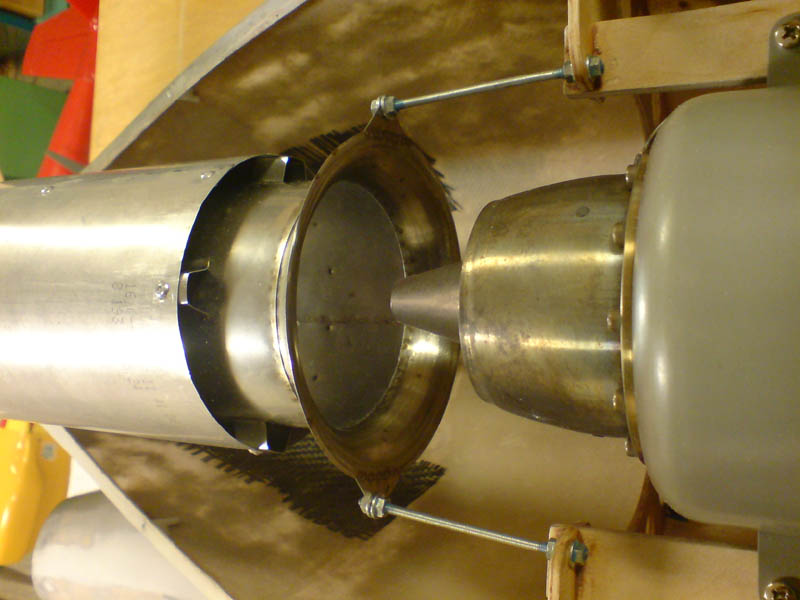

I have made one tube so far, and so far I am very happy with it. It is the augmenting type, and I made it from .008" 304 from McMasterCarr.
Bellmouths: I once found a formula that said the radius should be internal dia/5. This is what I used, and the proportions seem good. Bellmouth was spun over a mdf plug in the lathe. I use full length lithoplate aluminum outer duct, 4mm spacing at the rear, and 6mm extension beyound the inner duct. I am running a JG100 engine, so the dimensions should be ok with 120 class turbines.
Lars
