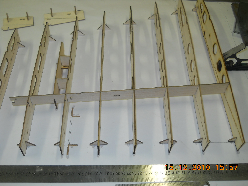

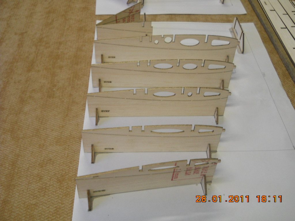

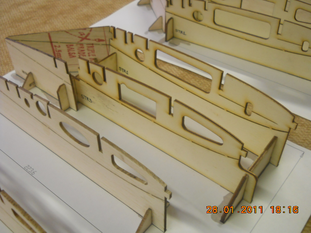

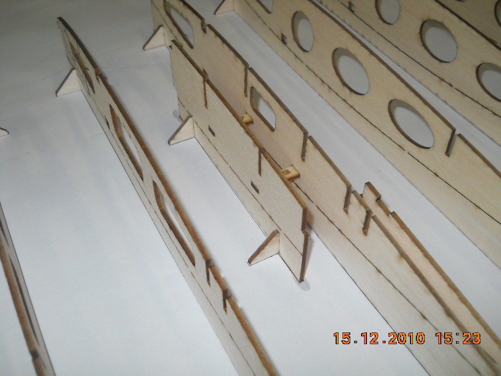

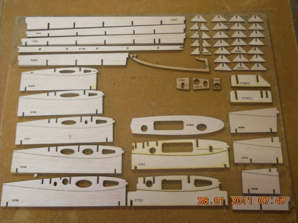

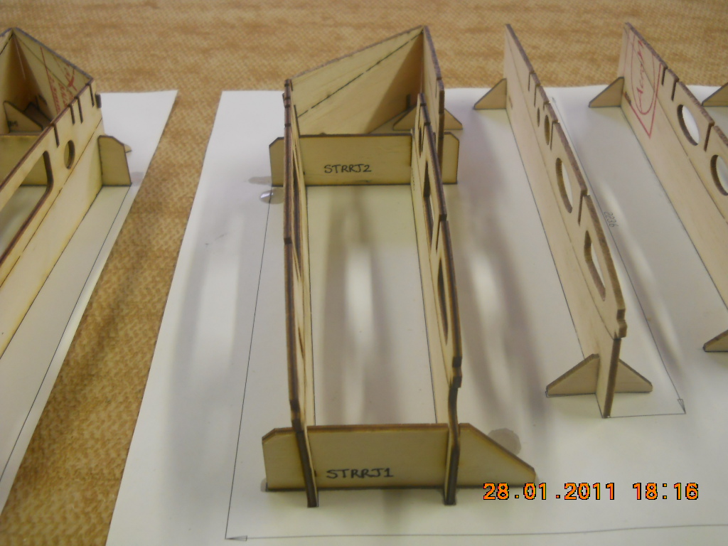

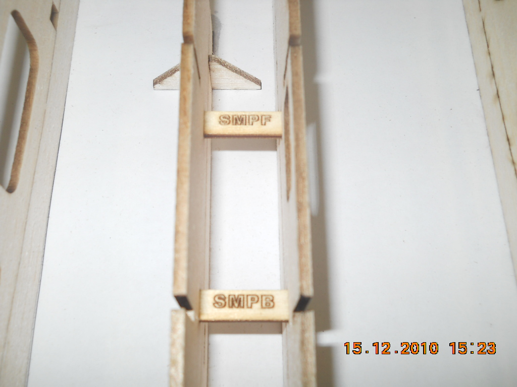

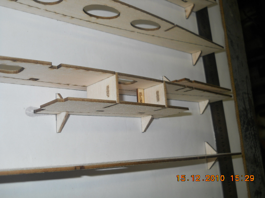

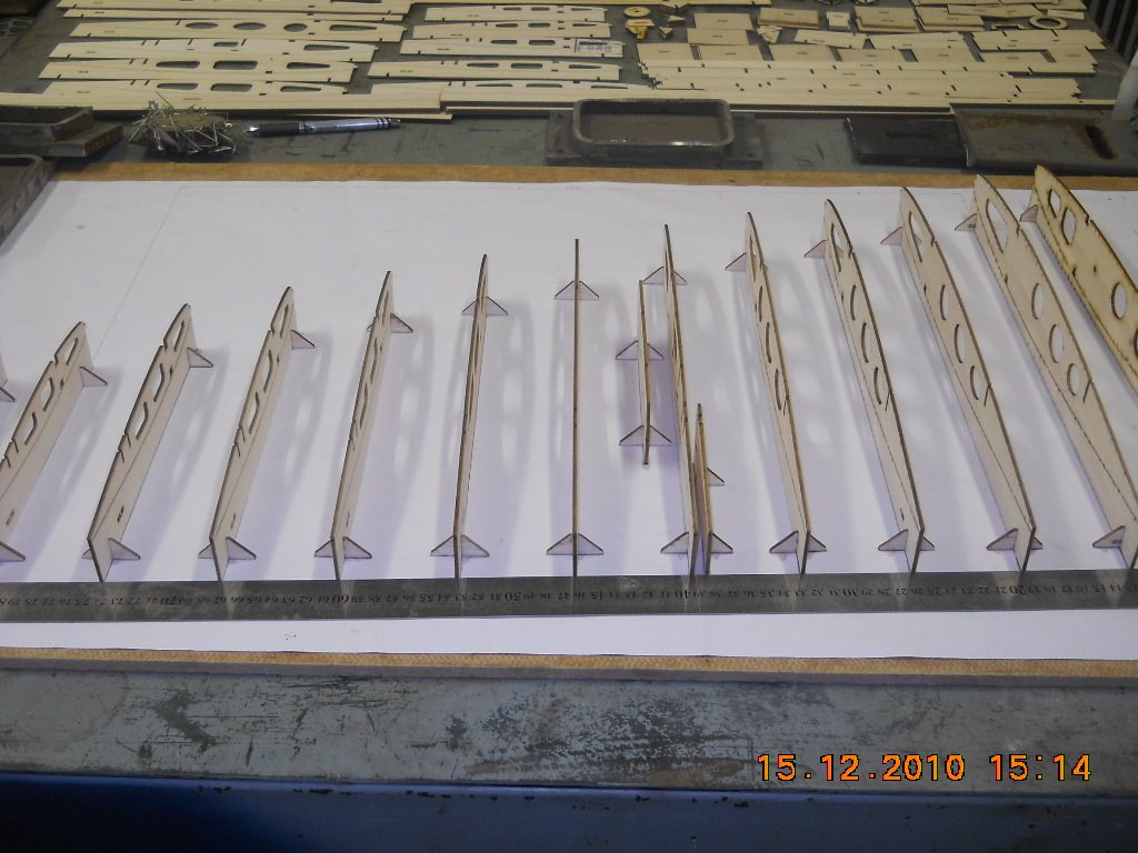

Thanks Doug, as you can see the interlocking parts construction makes the building process very easy, no need for complicated jigs or paper plans.
I attached a few images showing the turtle deck assembly and tailwheel support plate. The fin is assembled separately and then attached to the fuselage.

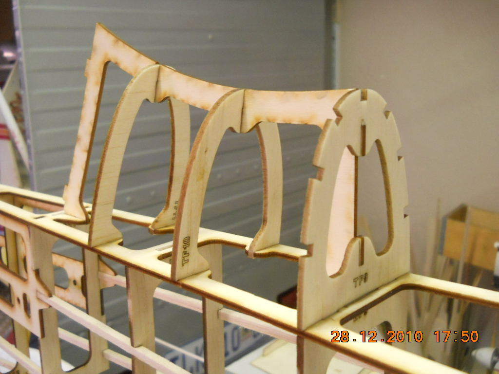

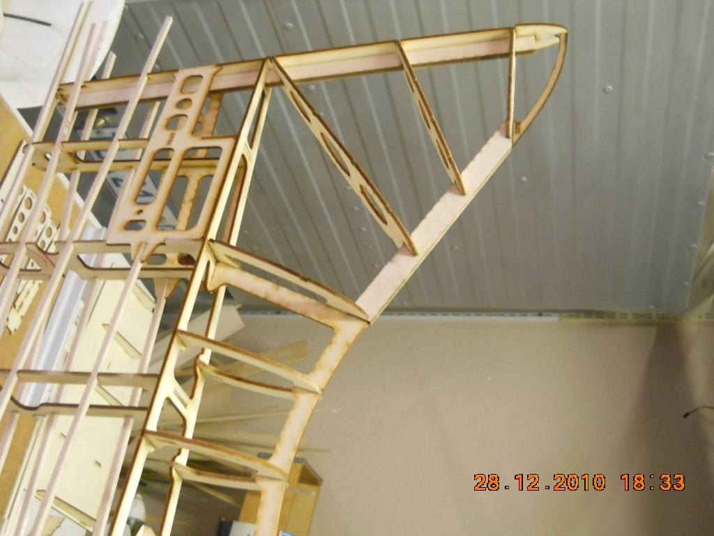

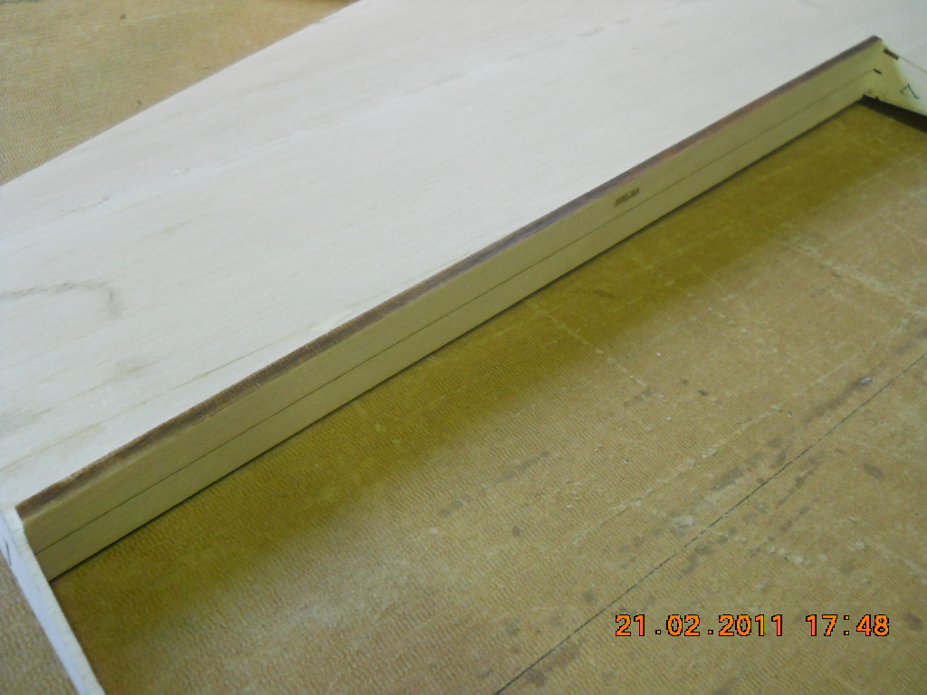

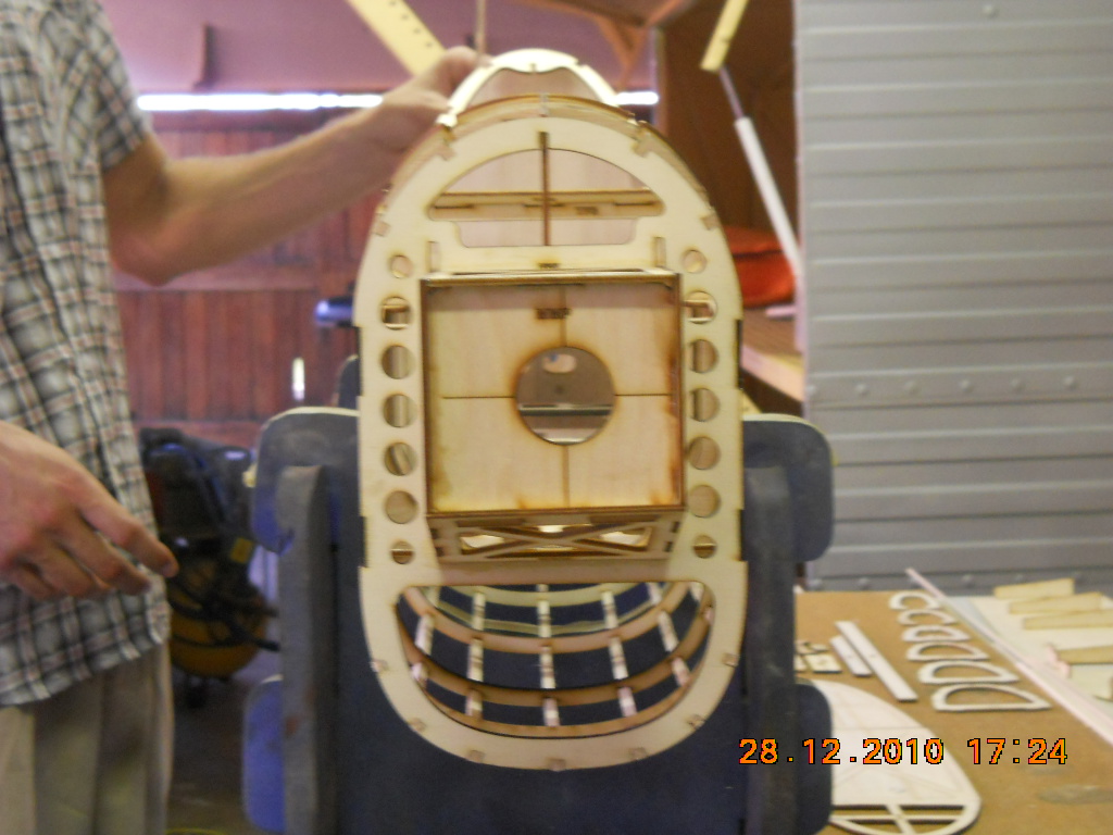

To complete the fuselage structure, all that was left to do was adding the top stringers. Rudder was also assembled using the jig included in the kit.

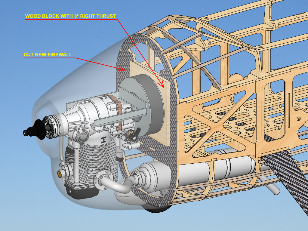

For the kit version, we also adjusted the CG location so you will probably need to place the batteries in the middle of the tray, no need to put them so close to the firewall.
As Tommie said, there's plenty of space to work there.

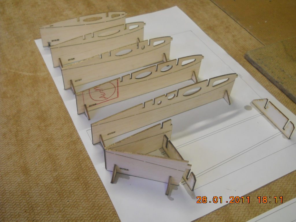

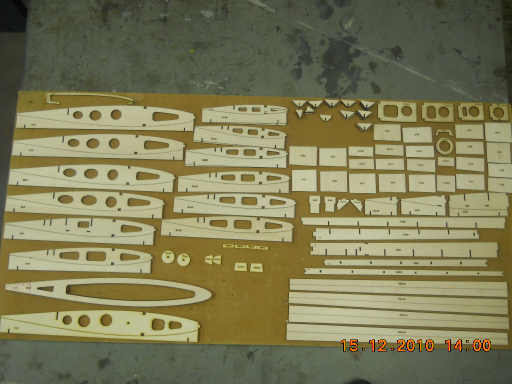

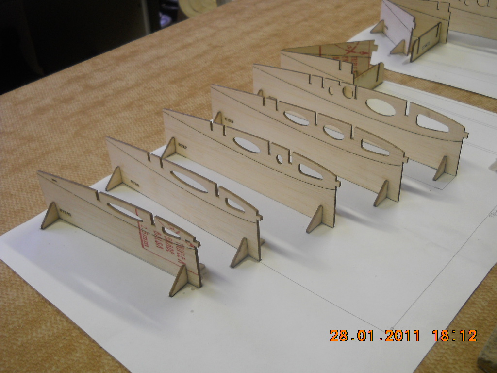

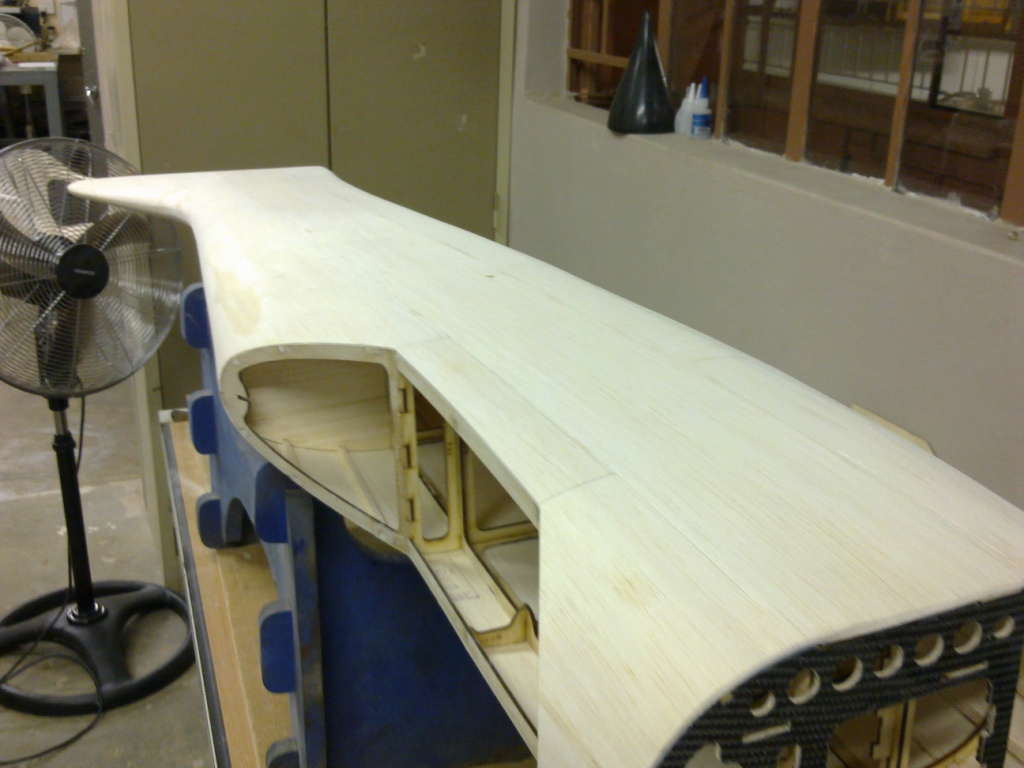

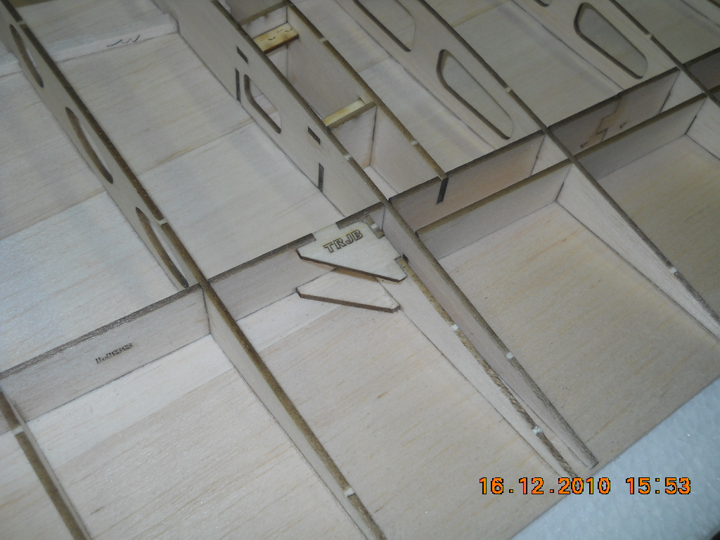

Unfortunately we only have very few pictures of the fuselage sheeting process. Here are a couple showing the balsa covered fuselage:

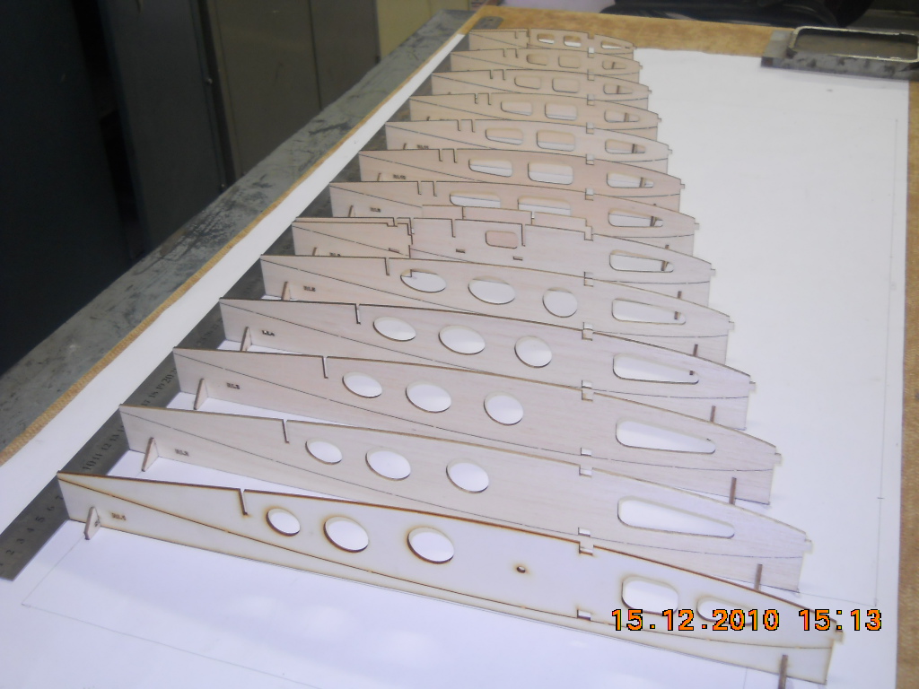

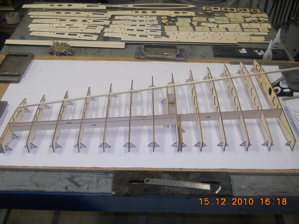

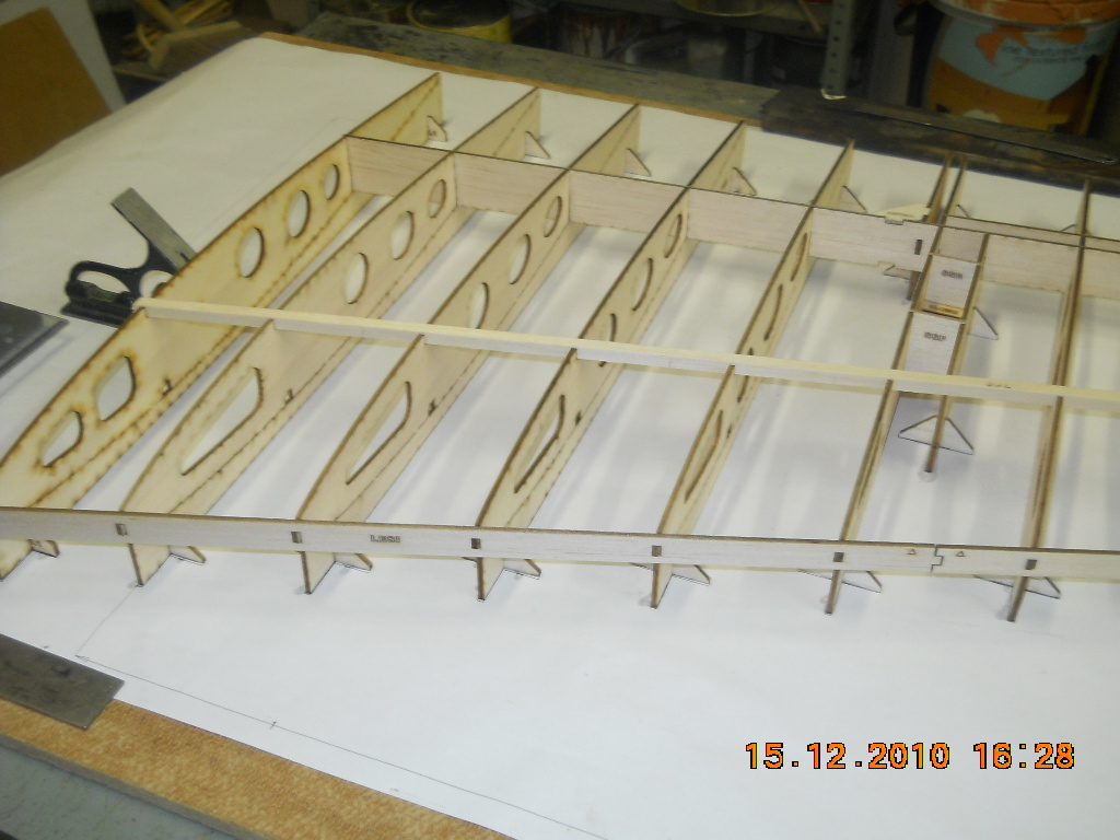

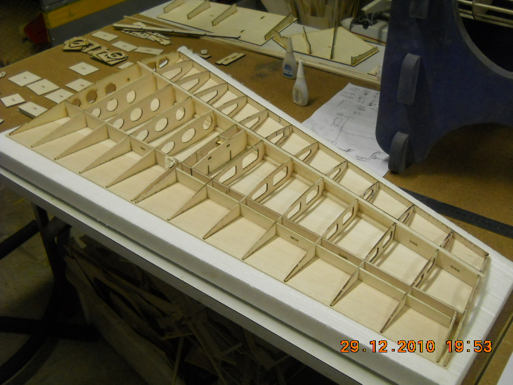

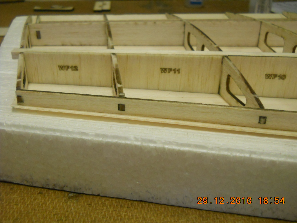

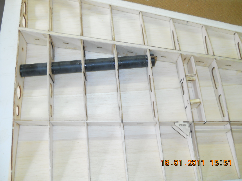

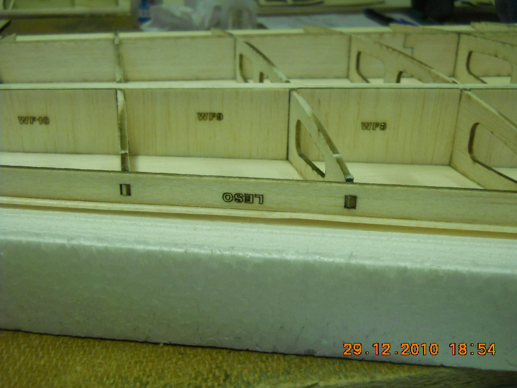

Moving on to wing construction. The pictures show the rib placement and servo box assembly:

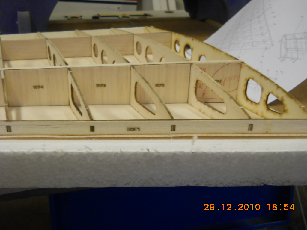

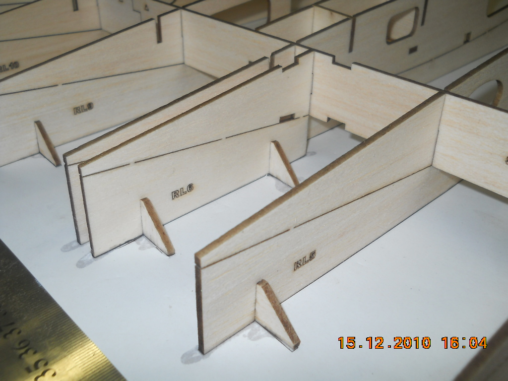

Thanks Doug, i did the CAD work but Tommie did a great job building the planes. All the building pictures here are his work.
More details of wing assembly:

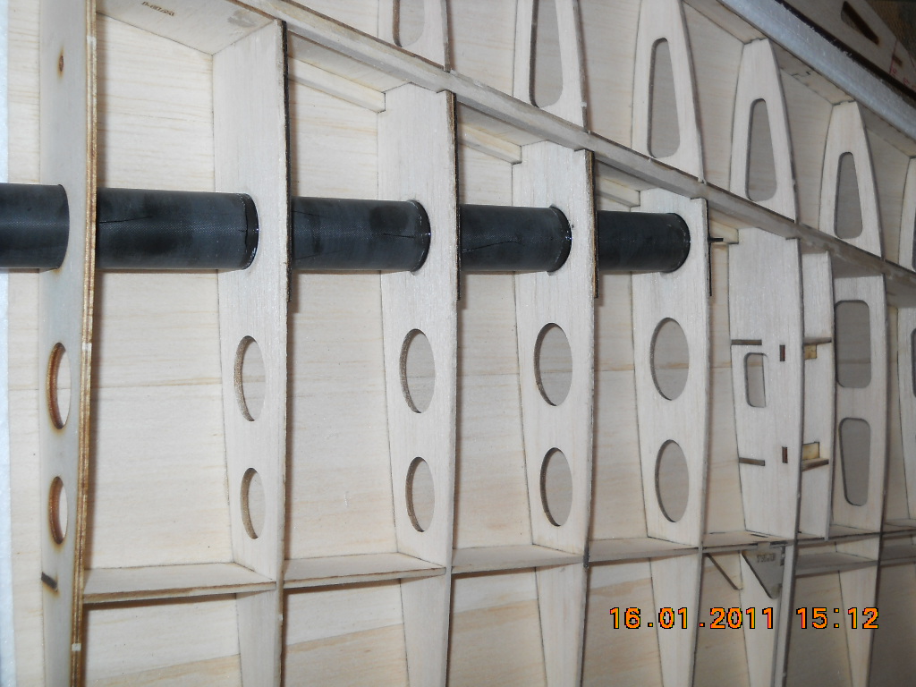

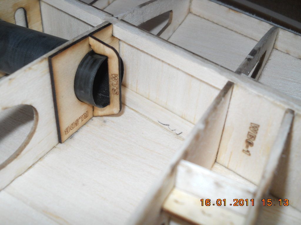

Adding the wing tube sleeves is next. To increase strength, we decided to make the plywood rib doublers longer and use them to connect the wingtube and main spar.
This way we can transfer the loads from the main spar to the wingtube through the hard plywood doublers, rather than relying on the soft balsa ribs.
The root rib is made of 3mm liteply, so it's strong enough and only has a small doubler for local reinforcement.

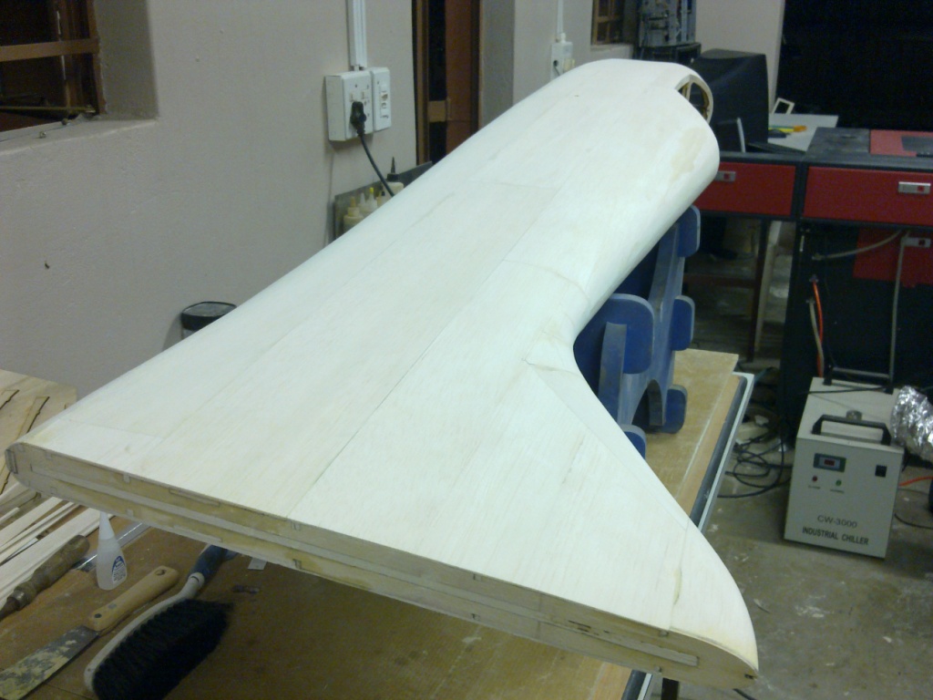

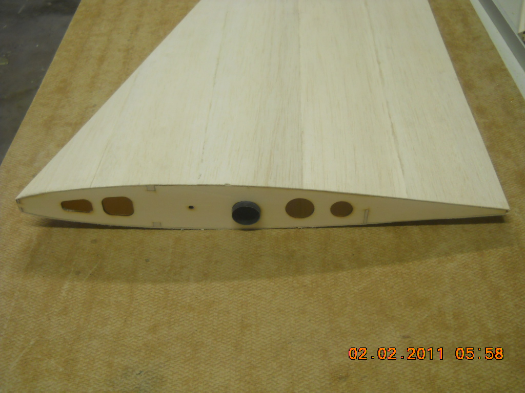

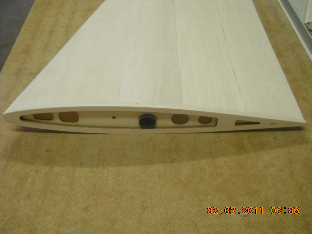

Final operations on the wing: adding the root balsa block, cutting the ailerons and adding the hinge lines.

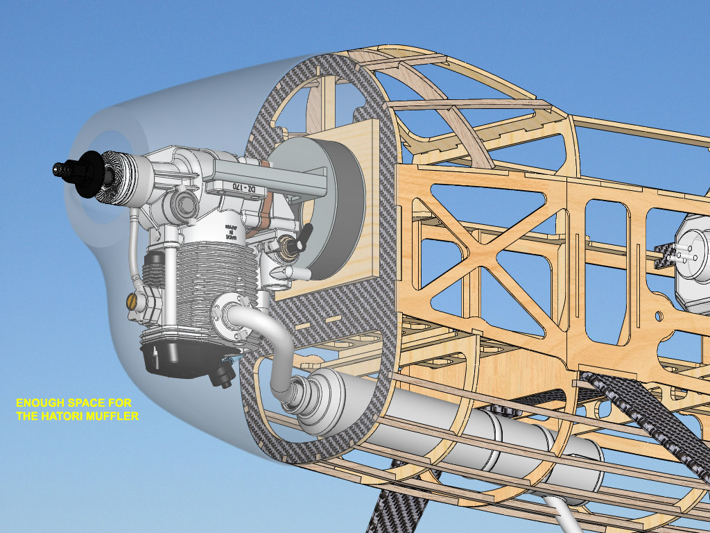

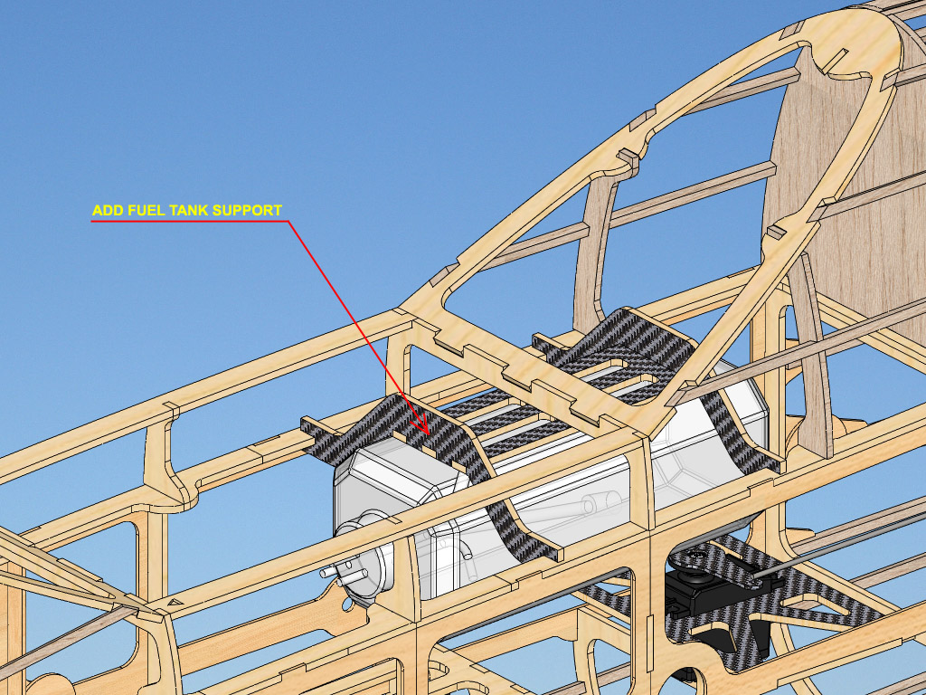

Thanks Leo, we had quite a few questions about a glow version. For us it would be too expensive and time consuming to re-tool for glow power, buy engines and accessories, build and test a new prototype, etc. But for those willing to build a glow powered Radiance, it would be quite easy to convert the model.
Basically what's needed is to cut a new firewall, remove the frame indicated in the attached picture and build a fuel tank support. Additional reinforcements will be needed on the inside of the fuselage for attaching the firewall and also the cowl support tabs need to be reinforced to withstand the YS engine vibrations.
For the new firewall you can use the one included in the kit as a template, but without the big rectangular cut in the middle. I can provide a PDF file for the glow firewall and fuel tank support if needed.
The attached pictures show the modifications needed for glow power conversion:
ID:	1743489   Click image for larger version
ID:	1743490   Click image for larger version
ID:	1743491   Click image for larger version

Thank you for your detailed info Alex. Do you think since the aircraft wasn't tested with a glow engine, we would run into cg problems
Leo
Old 03-28-2012, 11:07 AM
  #45
Alex Voicu
Join Date: Aug 2006
Location: Trollhattan, Sweden
Posts: 519
Received 60 Likes on 28 Posts
Default RE: Radiance F3A - new pattern kit
ORIGINAL: Leohenriques
Leo
I suppose it's more or less the same as converting any other model. For electric power the CG can be adjusted between 25-35% MAC by moving the battery.
Maybe other modelers who converted their pattern models can relate their experiences concerning CG position?

If you keep the CG in the same position, nothing will change since the the CG regards the glider and not how is powered. Just for safety and as shall be done in any plane, you can start from the forward position and furtherly (if needed) move it backwards.
