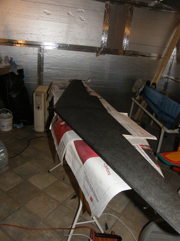

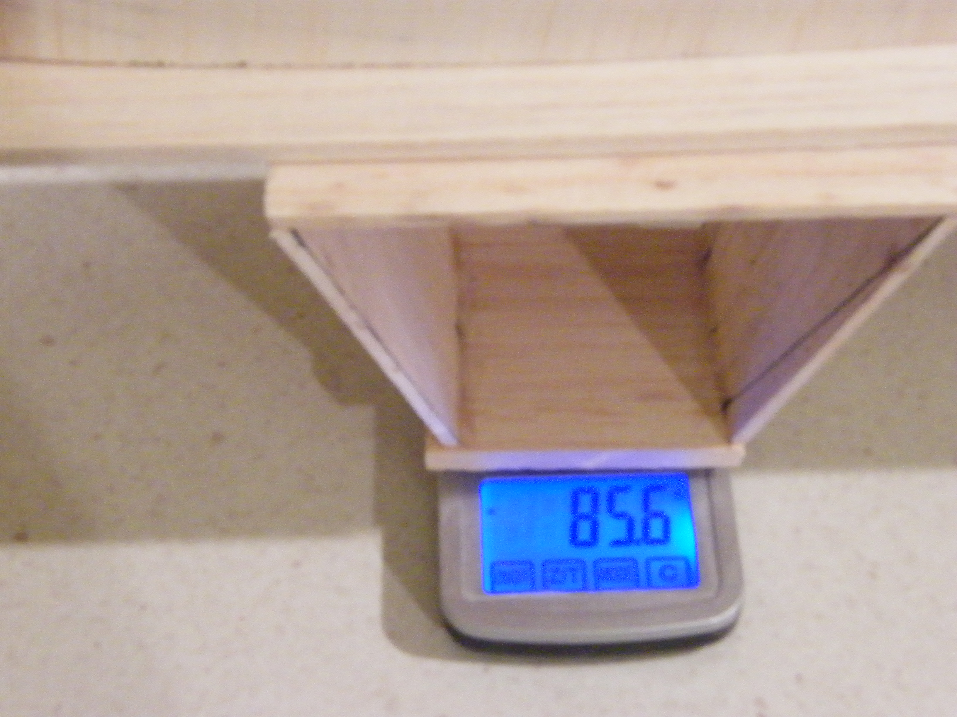

Have skins on the first two wing panels - top wing.
They weigh 85.5g
That's ;
Core - 27.5g (top wing)
Skins - 25g x 2
Glue - 8g - ; = 4g per skin.
There is some more sanding to do on the skins while the facings are being prep'd. So Maybe 80g equivalent is possible for these top panels.
The bottom ones will be 7g to 10g more.
A little concerned re finishing method after the discussion on the 'post a photo thread' just now.
Some quantitative testing req'd over the next few days.
Brian

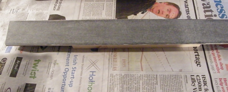

Just a little on method for applying the skins.
- Using the veil on the inside eliminates the need for additional structure ; spars, carbon straps etc.
- I dispense the PU with a syringe and a lab,, calibrated sampling nozzle. This measures that used and I cut the tip back on the nozzle to give the desired bead size.
- I roll a 'damp' emulsion roller across the core before applying the glue bead. I then roll it over the skin/carbon veil just before positioning it. I do not wet anything - just leave a residue.
- Using PU on pre-sealed surfaces means that one skin can be applied at a time as there is no wetting of the wood. This makes accurate alignment easier as it is critical for the application of the 2nd skin only.
Brian

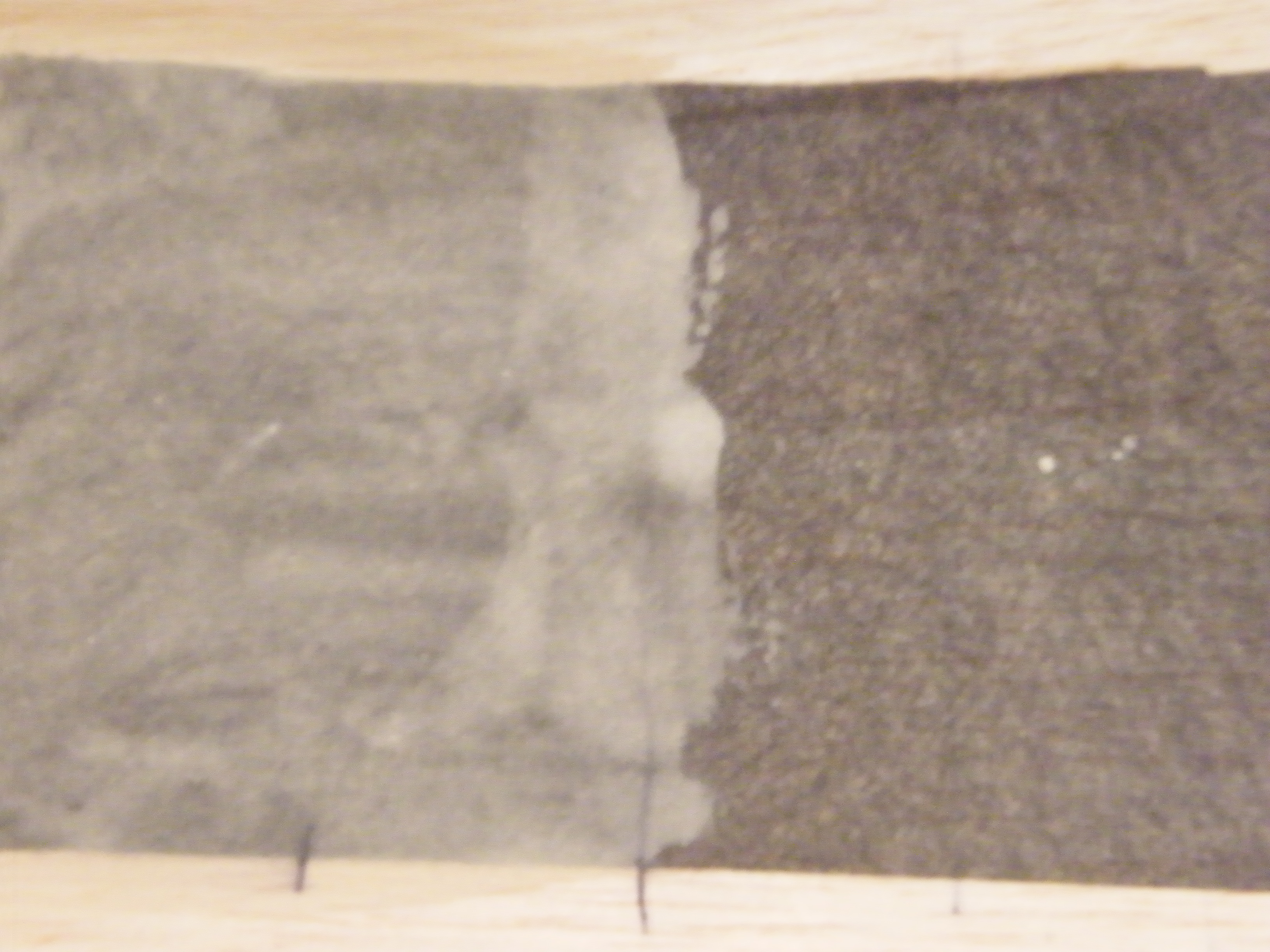

' Hi Brian,
Is that Fumed Silica? It is very fine, extremely fluffy material. But I don't think it's a good filler that sands easily. I don't think it will do the job on the finish that you are looking for but I don't know for certain. I would test first.
I don't use microballoons in the finish either. Much too coarse and needs extra filling so paint can stick without pinholes or bubbles. I don't recommend it as a top coat. Great underlayment tho.
So that we are not accused of highjacking this thread, maybe we should this take this discussion to your other thread?? What do you think? '
( Quote from the 'post some pictures' thread.)
Matt,
Good thinking
http://www.westsystem.com/ss/410-microlight
I can't find a data sheet or spec.
I think it's a synthetic 'balloon' a bit like the brick red phenol ones but this is easy to sand according to a friend ,Dave, who is helping when he has time.
On a test piece just now it, mixed 50/50 with a dope thinner 50/50 mix, it has filled 0.3oz veil all but completely in one coat.
There are pin holes/air bubbles in it alright - very small though.
I'm thinking that if I thin the dope more and use less 410 that it will fill in layers and I can start to add talk progressively in layer 2 and 3.
I will do samples first.
Brian

Have all the panels sheeted now.
The bottom wing panels are at 100g - they are a little bigger ,have less foam removed at the root and I used a little more glue each skin (6.5g/skin)
So the weights with the skins applied to the cores are;
Rudder 21g
Tail half 28g
Top wing half 86g
Bottom wing half 100g

Have spent a lot of time in the last few days working out a method for finishing the carbon veil - if ever I get that far !
I have had a look at both the 0.2oz and the 0.3oz veil.
The .2 is a bit feeble over the soft balsa - it is usable but is soft and easily cut through, I would have to bury it in dope to avoid cutting through it while blocking over the honeycombed foam walls.
I like the strength and resilience of the 0.3 so I have decided to give some weight back by using it.
The lightest and shortest path I've found is ;
Apply the veil to unsealed wood using this mix; Dope 1 part, thinner 1 part and west 410 1 part.
This all but fills the veil and the 0.3 is happy being put down this way - but it is full of pin holes.
Then two coats if sanding sealer - fairly thin.
This seems ready for wet sanding then priming - see pic;
Brian
#64
Brian, I like the 0.3 veil too. But it is thicker. It will build an even stiffer panel. BTW, how are you planning to mate the halves? Carbon Joiner Tubes of glass cloth? If glass cloth, consider applying that with nitrate dope too. Probably 2.4 oz bias cut is more than enough.
I've tried the "shortest path" before and wasn't happy with the result. It had a tough time sealing, needing way too many coats to do so. For wet sanding that is. But wet sanding is not the only option.....
I don't think it will hold up to wet sanding. It doesn't sound like enough sealing coats went on. But what the heck! And you always have dry sanding available which should work well enough for primer. One thing certain, the primer will show every flaw you can't see at the veil stage.
The weights you are seeing are on par with my honeycombed panels, area for area. Definitely lighter than non-honeycombed. Glue weight savings is considerable; my regular 530 square panels take about 40 grams of epoxy top and bottom skins. Yours are taking half or less area for area. Another way to say that honeycombed panels expose about half the foam area to the wood. Sounds like the early weight estimates for the wings that we kicked around should be very close to the real thing. I still see around 10-12 ounces per wing ready for equipment.
#65
Matt,
The test pieces seem water tight - I will check some more as this is my first time using dope.
Re the joining/mating of the panels ;
I should get to that next week or the week after and will show it here.
Having attached the root faces with a minimum of PU (some people use excessive amounts of glue here and all it is is weight,a waste and useless) my plan is to first overlap the veil - as you have said there is some substance to it - actually the 0.3 with the 410 and dope is as hard as epoxy and 1/2oz glass ,maybe harder.
Anyway I've tested the veil on a lot of samples and even the 0.2oz supports the balsa enough that, with the veil on the tension side, the balsa always(100%) fails in compression. When tested the other way around, ie with the veil on the compression side the balsa always failed in tension on that side.
I will do a small overlap on the top wing, both sides, and on the bottom of the bottom wing. I will extend the overlap past the wing seat on the top side of the bottom wing.
This overlapping will simply continue any tension that is in a panel skin under load past centre to the other side.
Then I will use 0.6oz glass to back that - first a wide piece then a second narrow one. Wide of course will be relative to location. I think that will be sufficient. I will load the wing to check.
Yes I'm impressed with the tensile strength of the dope and intend to use it for the 'bandaging'. Again no abrupt change in load bearing characteristics by continuing through with the dope also.
Brian

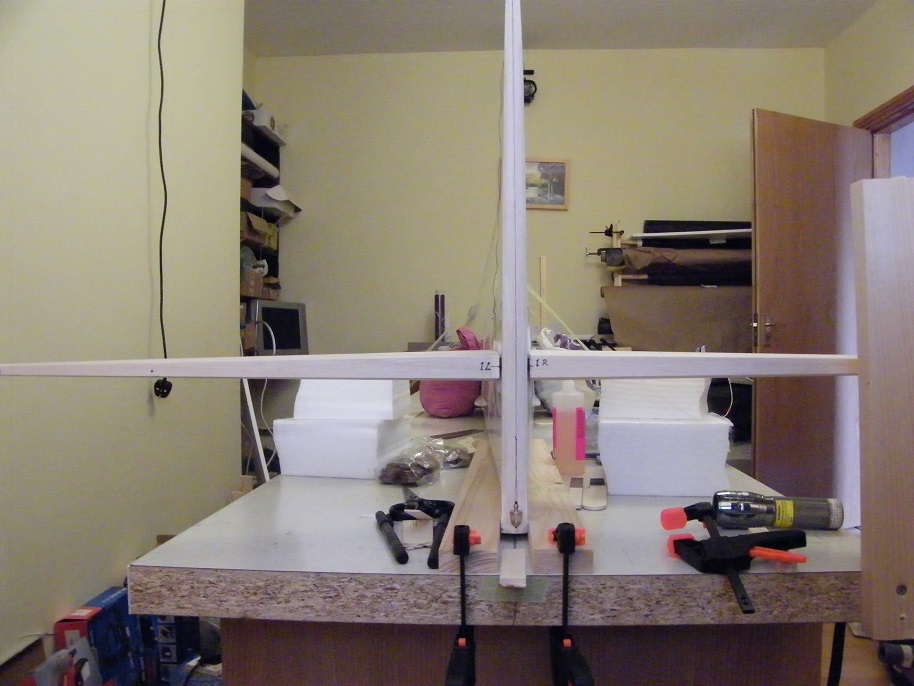

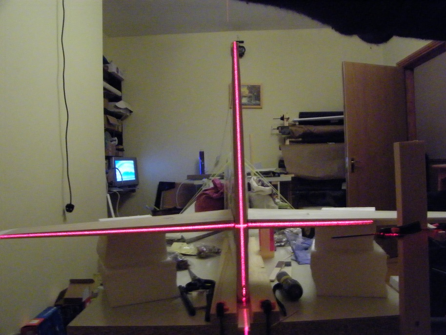

#70
Hi,
The alignment of tail halves and the importance there-of was mentioned recently in an other thread and quite correctly.
Back in the day,when we were producing our OD stuff we came up with the following to deal with this ;
We made the tail halves as if they were for a one piece tail, going through the fuz,, .
We then joined/glued them having jigged them up for perfect alignment (as close as possible anyway).
Then the outer tubes are dropped in from the top (or bottom) having been boxed in balsa first.
The tubes/boxes are put parallel to each other in plan and end views. This assure ease of assembly there-afterwards.
Then cut the halves apart again (two cuts), face with a root rib and discard the middle piece. Rejoin with inner tubes for that 'perfect' alignment !
Finish the boxes to profile and they are ready for covering - a 15g glass patch over the top is a good idea, but not required, if using film.
The adjustable tube is run through a box in a box and shims are used to adjust. This is stiff and not subject to loosening up or pivoting even if using a YS.
The foam former is plenty stiff enough and is not subject to popping loose if jarred. It and the boxes weigh 9.5g. The equivalent in a factory job (the screw in the fuz,, type) weighs between 20g and 30g not including the tubes.
Brian

#73
Brian,
Am I looking at the wing on the last photo? The weight is very good for a 700 square wing, just under 8 ounces with covering on.
Have you had a chance to sand the 410 filler? How did that go. I bought some a few weeks ago but have not tried it yet.
#74
Matt,
Yes that is the top wing - a little smaller than the bottom one and a little more foam removed near the centre.
I am going with the 0.3oz veil all around.
It will take more to fill than the 0.2oz, quite a lot more, but I think it is worth it for this project. I am still working on getting a good sequence of materials and sanding to get the best out of it.
The 410 sands very easily but if too much is used too soon it gives a lot of pin holes etc.
However this 0.3oz (actually 0.35oz) adds so much stiffness and strength it is hard to believe. It also gives quite a hard surface.
Also the 0.3oz takes a lot extra per coat - it really sucks the material out of the brush as you try to wet it.
That wing has a sealing coat and 3 heavy coats of 1:1 dope/thinner , the first of which put the carbon down.
