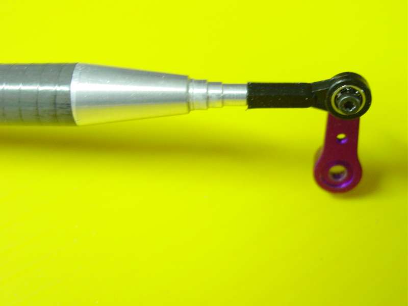

I have also decided to use MK BB fittings througout this model. I was told that the supplied horns are too flexible - agree, so I decided to try and laminate the existing ones instead of trying to make new ones. The results are fantastic- extremely stiff - bling[:-] and only added a few grams. and a total of 1 hours work.

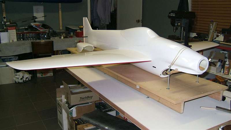

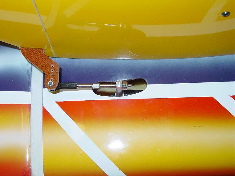

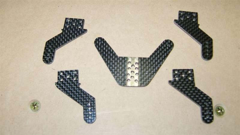

#465
RE: Impact
I also decided to invest a few hours in assembling a jig to assist me in all the critical stages of assembly of a F3A model. Believe me guys it is worth it spending some time here. A straight model requires a lot less effort to fly.
The jig consists of MDF 16mm for the surface and 2.5in x 1in for the rails. Everything was screwed together with tek screws. I also used a 1metre length of 1/4in threaded rod as well as a stock of 1/4 in nuts and washers.
The jig holds everything in place and postions the fuse level so that the wings and tailplane can be postioned precisely. The use of threaded rods gives you infinite adjustment in getting the fuse level. I am wrapped with the results.
The idea is to get this jig perfectly flat. I then take all measurements from here. You will see that I used threaded cup head bolts at the feet. I tapped 1/4in holes in the rails so now I can screw or unscrew the bolts to raise or lower the jig. I used 6 bolts in this case.
When everything is level I use this device for scribing lines along the fuse. I simply put an exacto knife in it to scribe super fine lines. When it comes to designing paint schemes I replace the knife with a soft pencil to drwa perfectly straight and symentrical lines on the fuse. I simply run this device also the smooth surface of my jig.
Hope this helps some of you.

I have decided not to go the wing adjuster route. Not worth the extra effort if your confident that you can position the wings exactly were you want during construction. I have added an adjustable tailplane to fine tune elevator trim. Servos in tail after a lot of thought.

Great work Peter!
Have you decided yet how to finish the colour scheme?
One of your photo's shows the stern post & I noticed that the fin base former isn't installed, you might be aware but thought I'd mention it!
Your building jig looks brilliant [sm=cool.gif] sure will make life a lot easier for modellers now!!
Good luck with rest of the build and keep us updated .

#469
RE: Impact
Peter,
MARVELOUS WORK!!!!
I just love the simple yet supremely effective fixtures. The super simple "height gauge" which uses an exacto knife as scriber, is genius. This device is a "must-get" for everyone wanting precision (been using mine for 25 years and I find more uses for it than you can shake a stick at). I really hope everyone studies your photos and gleans as much as is possible from them. There are many more complicated ways to accomplish the job, but none more effective.
The carbon cloth laminate on the horns is also a great idea, one I hadn't considered!
K.I.S.S. mate!!!! (A little play on words, but quite appropriate methinks!)
Mattk

RE: Impact
Hi Andy,
The stern former hasnt been installed along with the depron brace. I only fitted the brace temporarily for the photo. I am currently setting all my incidences which are now perfect. It has taken some work as I found that the markings on the fuse are a fair way off.
Even the advice they gave about the 37mm below the centre of the tailplane tube does not result in a line that is directly in line with the engine cowl flange. The jig allows you to check everything perfectly. I would not reply on the seam line at the front of the fuse as being centre. I found it the be of to one side by 3.5mm. By having a centre line directly down the centre of the jig, you can position the fuse exactly by marking certain points along the jig base. Run a set square along the fuse and measure the distance to the centre line. Do this to both sides and make the distance equal.
I am happy with the alignment now but it would not have been possible without the jig. Hopefully I can glue everything up tomorrow.
I have also replaced the supplied wing tube with a PBG unit Frazer Briggs sent me. This new tube is 34grams lighter and much stronger. He also supplied a outer tube which will replace the part which is glued into the fuse. They are a perfect slide fit which will eliminate most of the slop.
I will be painting the IMPACT exactly like my Alliance except replacing silver with gold.
