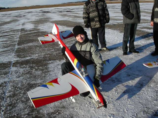

This is a photo of an Omega -a .90 pattern plane. You can get ne here (ARC) for $150. This particular model is covered with paper and oracover together. Powered by os 91FX.
Here is the bigger photo:

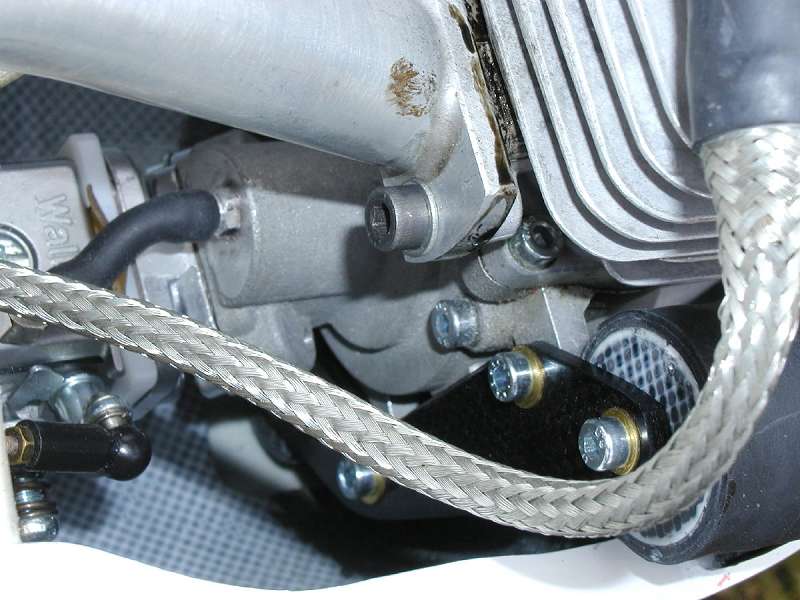

Ask him for engine mount pictures, look like carbon fiber structure or not ?

4) The motor mount is in fact 3 motor mounts in one, made out of carbon & balsa all covered with anti-vibration rubber.
5)Unexpectably, but ir produces less vibration than his YS!!! It is because of the motor mount and the motor is better balanced
