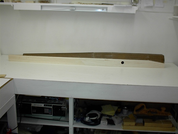

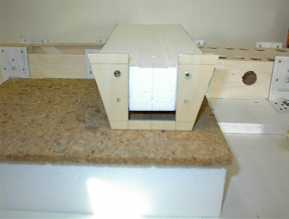

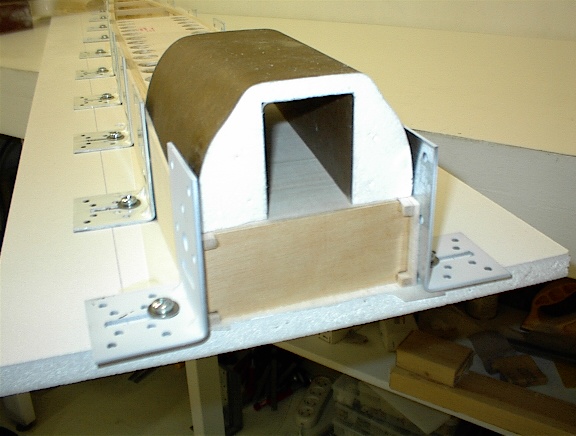

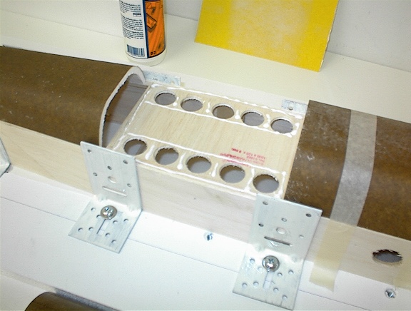

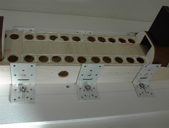

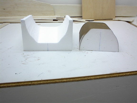

The fuselage bottom is made up from four pieces of foam. This is the one behind F1, covered inside and out with brown paper.
This one needs to be cut with the down and side thrust.
Sig
Sig

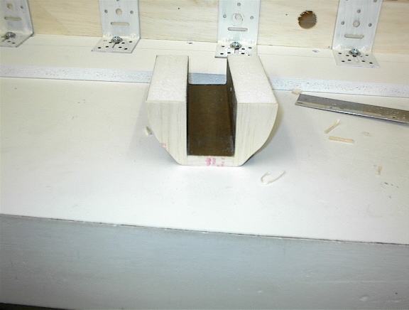

To make things easy, the second and third pieces are cut for the pipe tunnel before gluing on to the fuselage.

With the foam parts glued on the weight is now 274gr and it seams to have adequate strength.
But definitely not built to hit the ground.

The foam top is 66gr and is strong enough like it is and doesn't need any support only a former at the front. The rear of the fuselage is so much lighter than my previous T2k I just might have to move the wing a little forward otherwise it could be a little nose heavy.
