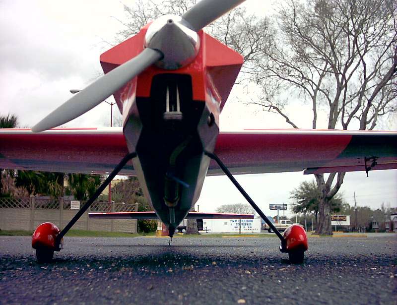

Forgive my enthusiam, but sharing news of a great test flight with the family just didn't give me enough satisfaction....they don't understand do they?!
This is my new Insight (Insight-squared) that I built from my own plans. The look of this plane will likely create "lovers" or "haters" of the design. It is mainly a shape that came from what I thought would be a quicker build (notice no fiberglass or plastic parts to mold or buy.....). The square shapes allowed me to cut all of the top and bottom decks from foam (hot wire) and sheet them easily in their shucks (just like wing panels). The only wood building was the fuse-box, which is a 4" tall x 6" wide fuse (think of a giant kaos fuse) made from balsa and small amounts of ply. The wings and tail are again cut from foam and sheeted with contest grade balsa. Apart from a learning curve with the foam cutter, the build was nice.
Some may recognize the landing gear as it is from the Ultra-rc Icepoint ARF.
The good news:
Span: 74"
Length: 78"
Area: 890" (approx.)
Weight: 9lbs. 12oz.
Engine: YS140sport (apc 17x8)
Radio: Futaba
I will make plans available soon (need to detail the drawings) if anyone is interested.

RE: Insight
Mike,
To tell you the truth, the wind today was nearly right down the runway. I noticed how light the plane felt in the turnarounds. When I got off the gas in my turn to base for landing, the plane slowed down instantly. I kept a high idle all the way in and cut it when I was over the numbers. I think without any wind, this will float by real easily (thin airfoil, light plane....).
I realized too that the edges could be easily softened alot during the template process, prior to cutting the fuse deck cores. It would easily change the look a good bit.
One of my favorite items is the open nose above the spinner. You can look right in there and see your nose ring and YS regulator. Cooling looks like it will not be a problem.
Here is a close up of the front end during the build.... I also angled the inlet of the pipe tunnel to improve header clearance and airflow out of the engine bay (sorry for the low quality pic...).

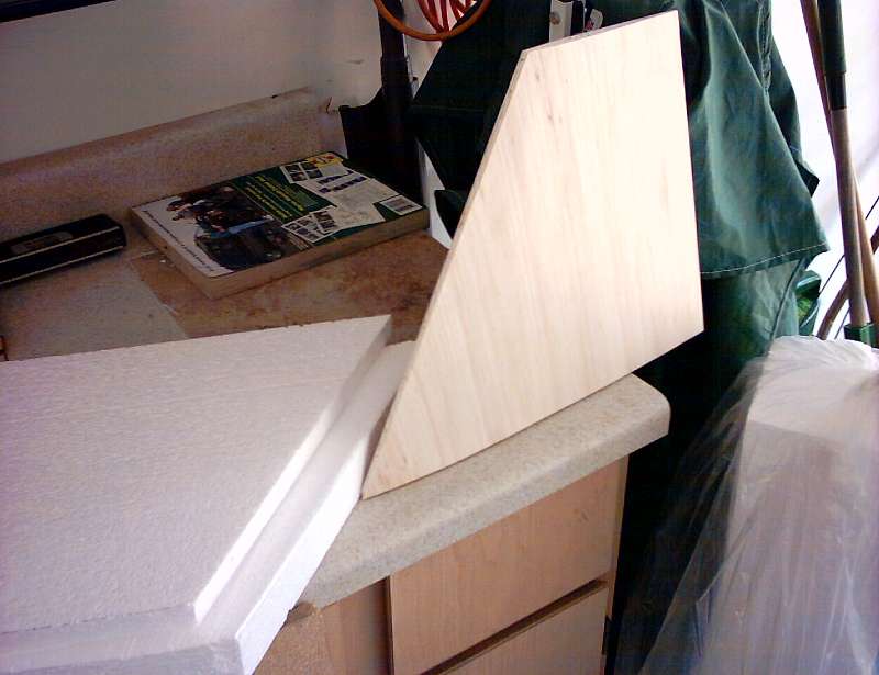

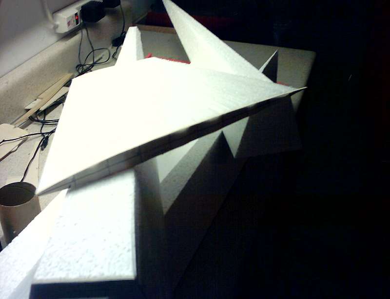

RE: Insight
tph1,
I cut my own cores for this one with the help of a flying buddy. I setup all the core blocks with my templates attached (double sided tape) to each end and called him over. We were able to cut the fuse decks, wings, and tail in about 2-3 hours (learning curve with the hot wire). I have all my templates in CAD (of course) so it is possible that they could be cut by professionals.
I got two more flights on the plane today. I actually flew the 402 a few times and it will take some time to get used the plane's slow abilities. I mentioned before that this plane slows nicely on bottom radius exits. In flying the sequence the advantage of this is much more apparent, as I now have more time to setup and draw a straight horizontal line entry into the next manuever.
-Mark

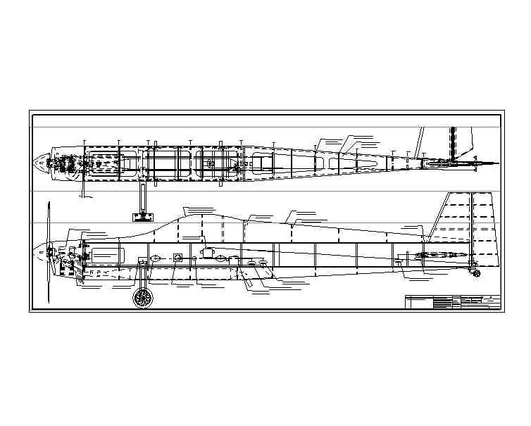

RE: Insight
Wladimir,
Here is your ZDZ40 sketched onto the nose of the Insight. The plug cap will protude out the bottom, but otherwise should fit just fine.
Sorry about the low quality image. I would model the engine in 3D if I could get my hands on one for an afternoon.
-Mark
-Mark

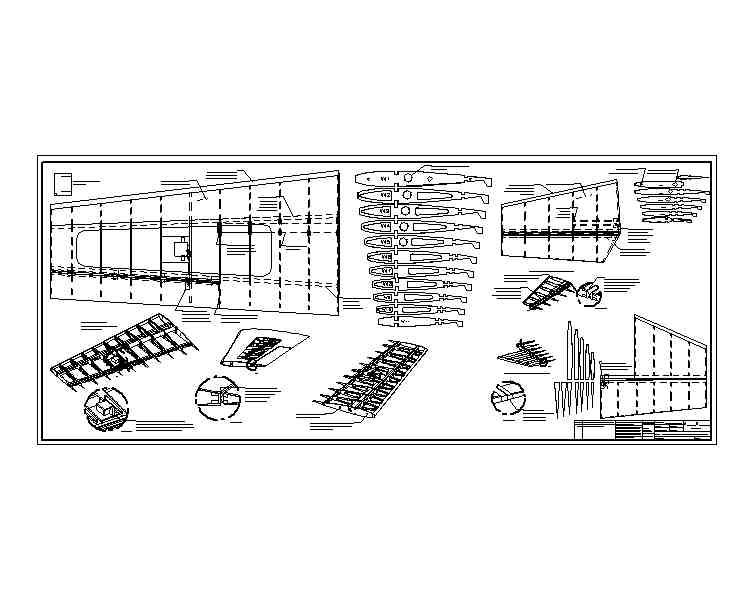

RE: Insight
I now have the plans completed, which comprise of 2 large sheets (34"x80" & 34"x60" ). They look good and provide all parts, formers, foam templates, and a couple isometric views of some of the sub-assemblies. I have compiled some notes from the build that I would like to also include, just as a reference....I'm working on cleaning it up into a word document that is twenty-some pages so far... I am also still working on pricing for having all the foam cores cnc cut using the cad file templates. I would like to be able to provide a nice set of plans and allow the builder to decide if he/she would like to buy the cores directly from the cnc cutter...hopefully, I can get someone to provide all the cores at a reasonable price for all of you.
Plans and notes rolled in a tube within the US $40
Outside the US, please PM or email me for shipping cost of the tube or folded plans
Paypal: [email protected]
PM or email me for mailing address if you prefer to use check or money order.
I have to now admit to the world my own lack of building skills. It seems that we have found some extra dihedral built into my wing panels (about 1/2" at each tip in the top surface of the wing). Not sure yet how I let this happen...still searching. This would explain the slight proverse roll that I have mixed out in knife edge. However, to prove that theory, new wings must be built. I had planned to build another Insight at some point using the new plans with a slightly lower belly, so I guess now is a good time to start. To experiment with the one that is now flying, I will be adding a bit more to the rudder counterbalance and flight test as soon as time allows me to do so. If it works, great, if not, I can live with the minor amont of programmed mix....besides, my sequence flying is starting to show I'm getting very comfortable with the plane. I hope to post some video in the next week or two.
-Mark
