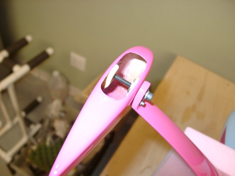

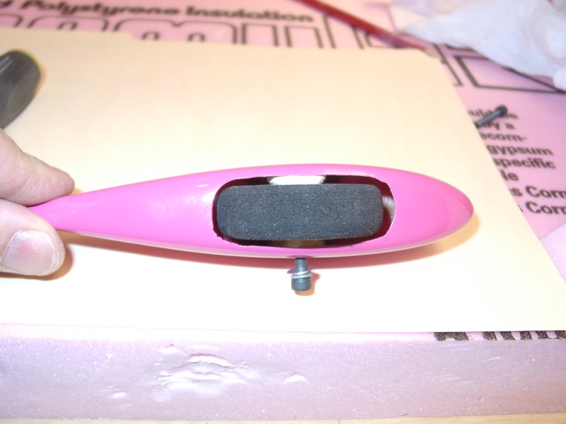

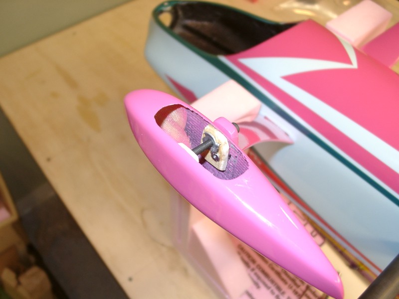

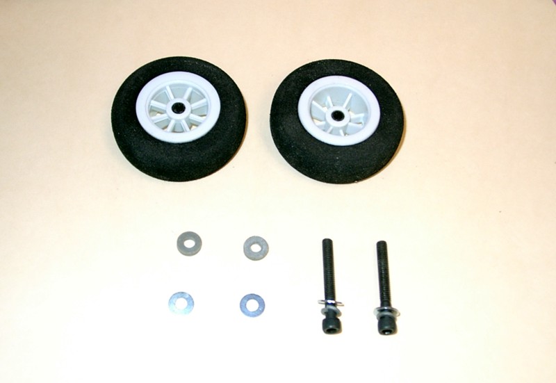

I needed spacers to center the wheel in the opening between the two pieces of ply. The MK wheels are asymetrical. The outboard side is recessed to hold the wheel collar. On the inboard end I just needed 1 number 8 washer. On the recessed side I used a plastic spacer from an electric APC prop. I used the one with the smallest opening and drilled it out to the right diameter. Although not shown in the pictures I ended up adding a metal washer to the outside of the palstic spacer for a better fit. The spacers were glued to the wheel hub to allow easier installation and removal. On the wheels, the 4 mm bushings needed to be drilled out slightly to allow easy passage of the 8x32 bolt.
#27
RE: Oxai E-Pinnacle Build
The wheel pants are attached to the gear with the 8x32 screw and an additional alignment screw. There is limited space on the gear leg for this but I was able to fit a 5x56 cap head screw into a blind nut mounted into the same piece of ply as the main axel blind nut. I drilled a hole into the gear leg first and then aligned the wheel pant and continued the hole into it. There is still a slight bit of play in the angle of the wheel pant if you loosen the two cap screws. With both tightened it stays quite firm. I do not think it will be necessary but Loc-tite could be used if needed.
