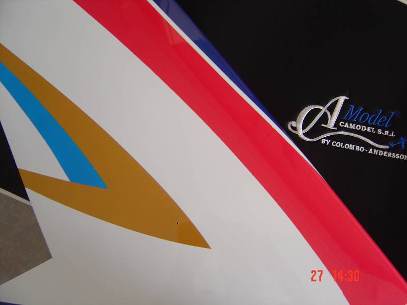

I had been admiring the CAModel Passport and was thinking of ordering one.
However, I was aware of the quality problems of other CAmodel planes in the past. But after seeing Chip flying at the Tangerine this winter and Jason test flying the plane, I was really enthusiastic.
The plane looked very good, and the guys flying it were very happy.
So, I ordered my kit , asking for a light one for electric, with split rudder. I asked Marcelo Colombo to install a quick release mechanism for the Canopy, similar to the ones he had been shipping for the chin cowl .
I was surprised by what I received !!!!
I won't go into my fruitless efforts to return the kit.......
I should have ordered a basic Kit and have it finished in a professionnal way, by professionnal builders !!!
So, I want to let you know what you get for the Deluxe Kit.
You can make your own conclusions.
In the following posts, are pictures of what was in the kit I received with a few comments.

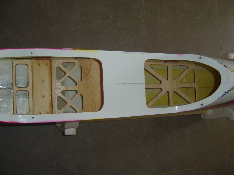

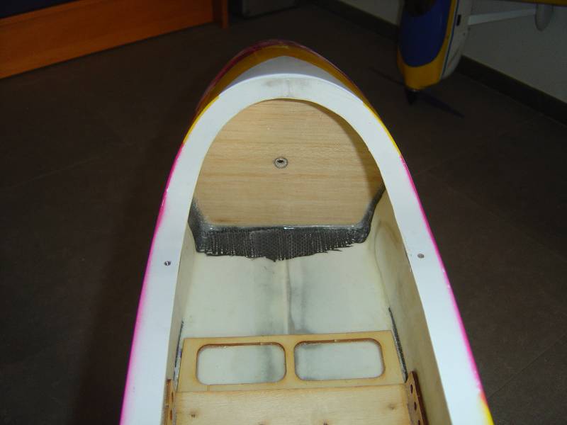

RE: CAMODEL PASSPORT DELUXE KIT
This kit is not very light for Electric
It comes with an engine firewall installed, even if you asked a light kit for electric

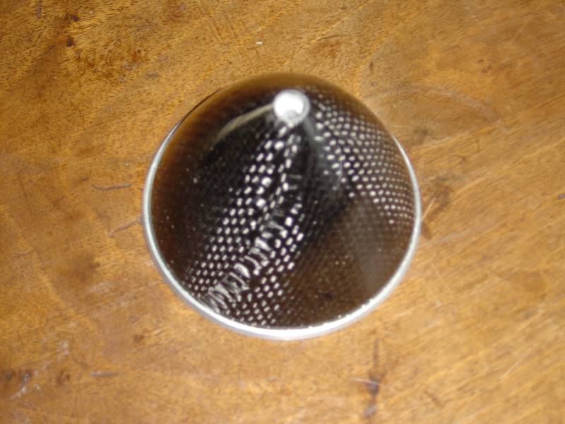

Carbon spinner 45

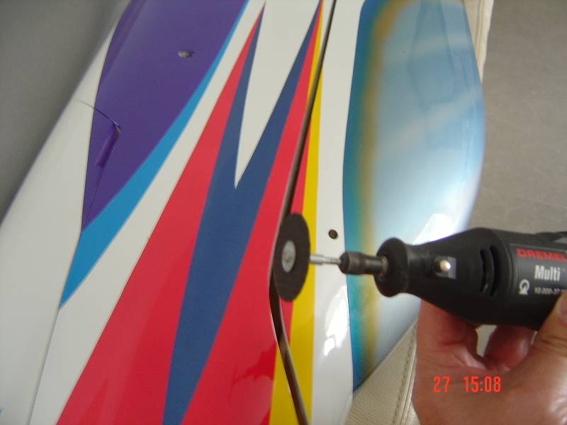

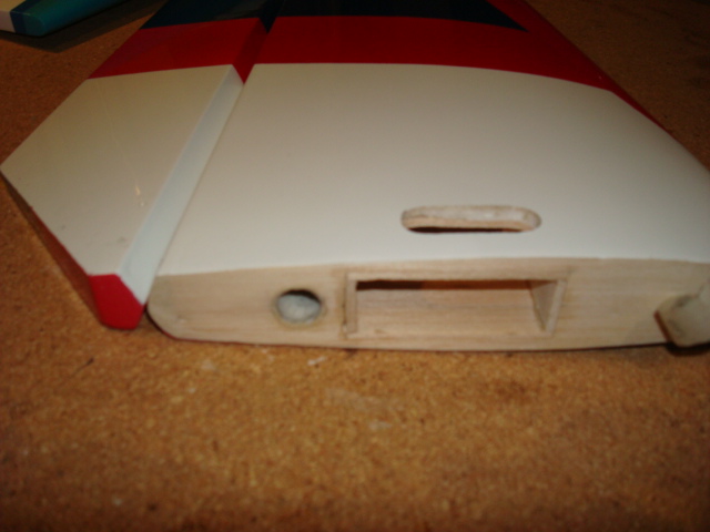

For the elevators servos, do what you want !!!!!!!
This is an ARF DELUXE KIT .......Almost Ready to Finish .....
So be prepared to cut slots in the fuse, in the stabs .....
Easy job (after painting done), and professionnal finishing guaranteed according to CAMODEL
From my experience:
the fancy holes on top of the wing panels are for two screws that secure the wing tube in position
hinges, I think they left this for presonal preferences. great!
Fancy hole in the back of the fuse, is for painting reasons, to hold the fuse somehow. it will be hidden below the rudder so you cant see it.

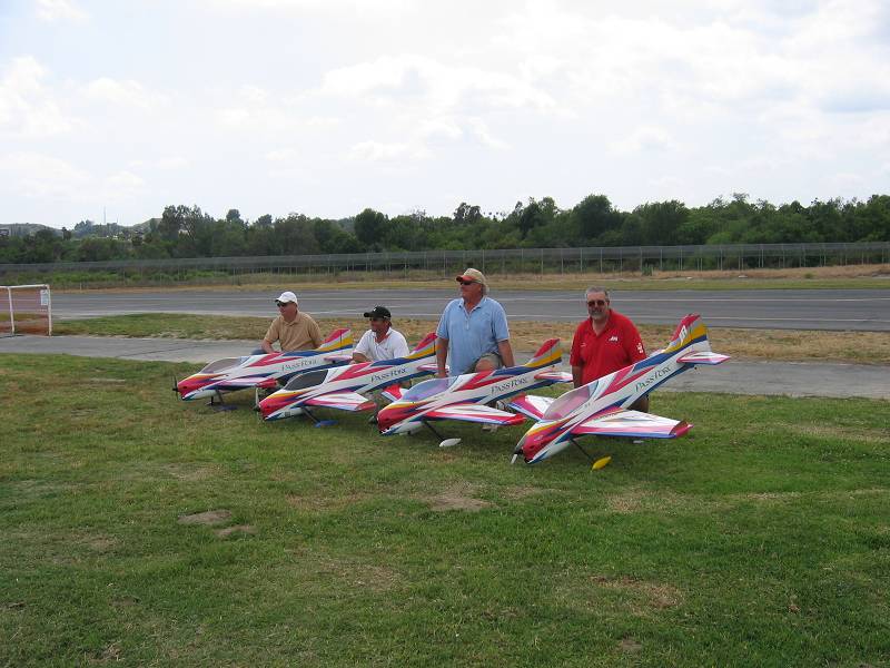

I have seen them fly with both the split rudder and non split rudder and from a flying stand point, didn't make much difference. I did fly Chip's with the split rudder a couple of weeks ago and the rudder authority with the mini 9650 servos was unbelievable. It had as much rudder authority as any plane I've ever seen and the knife edge loops Chip did last weekend at our contest here in TX were as nice as I've ever seen. The 2 mini servos definitely work, but only with the split rudder. I don't know if it is because you are only moving 1 half in a pulling motion, but it is very impressive. Not 100% sure it is necessary, but it does work...

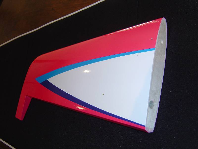

Hello J-P,
Sorry to hear you are disappointed, but I would like to share something with you, I think the split rudder does not worth the hassle and weigh, besides, Marcelo don't use it, that's reason enough for me no to use it.
The hole in the rudder post, yes it's not that nice, but you can not see it when assembled, really.

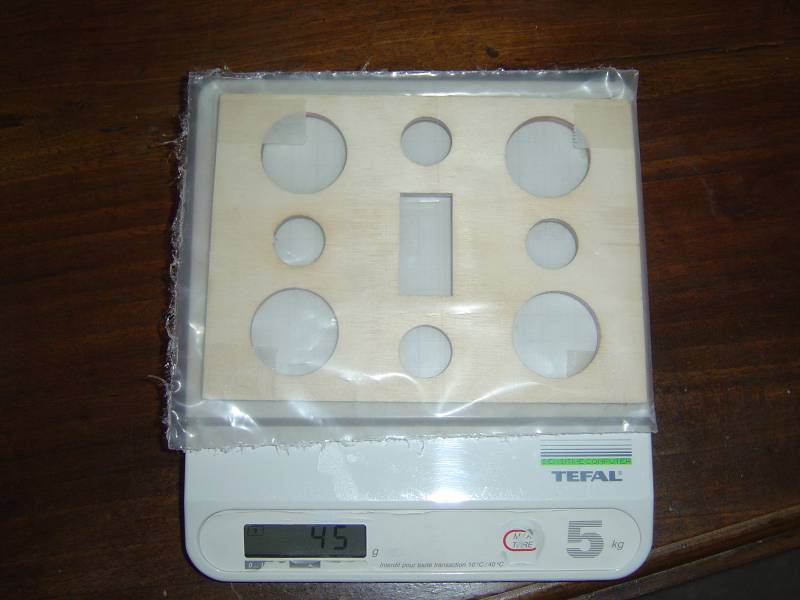

I strongly suggest you to remove the servo tray from the bag and re-weight it.
Of course I agree with Tuny on hinges, too many choices.
On the stab, attached please find the pictures of the stabs the way I go it from Camodel, I asked them to build the stabs for the JR 3421, and even the servo tray is in place, I really do not understand what happened with yours, I wanted mine concealed in the stab and they did it that way, but other people install them on the intradox, so you have the choice to do it either way.
A friend has two Zeque's from Oxai, and the aileron and elevator bevel wasn't painted, actually there was only over spray from the paint design, that really looks ugly on a plane of that price, but, of course I don't own the truth, it might been only those two, but I don't know.
I think that thinking about returning a kit for those details is kind of overkill, I'm sure you will love it once you fly it.

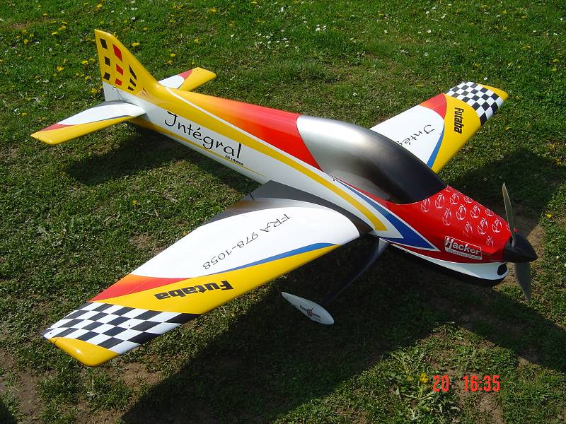

Maybe you were not lucky, because guys in my club have the same kit and are very happy, .... and they fly competition.
Here is what you paid for your all white kit.
Integral (all white) Product#: 702000
This is the all white model. Please look at the CARF Scheme product page for much more detailed information..
The Integral is a joint venture between Composite-ARF and ZN-Line. The plane ...
USD 1,190.00$
This is what I got for 1590$, very good value in my opinion
You will see a few of them at the World's.....
USD 1,190.00$

You are correct, the rudder servo tray out of lite ply is not very light. I replaced it with a narrower honeycomb tray. I basically copied what Tuny did in his build thread.

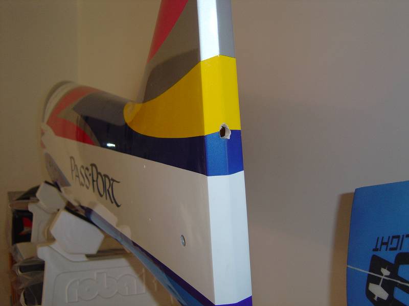

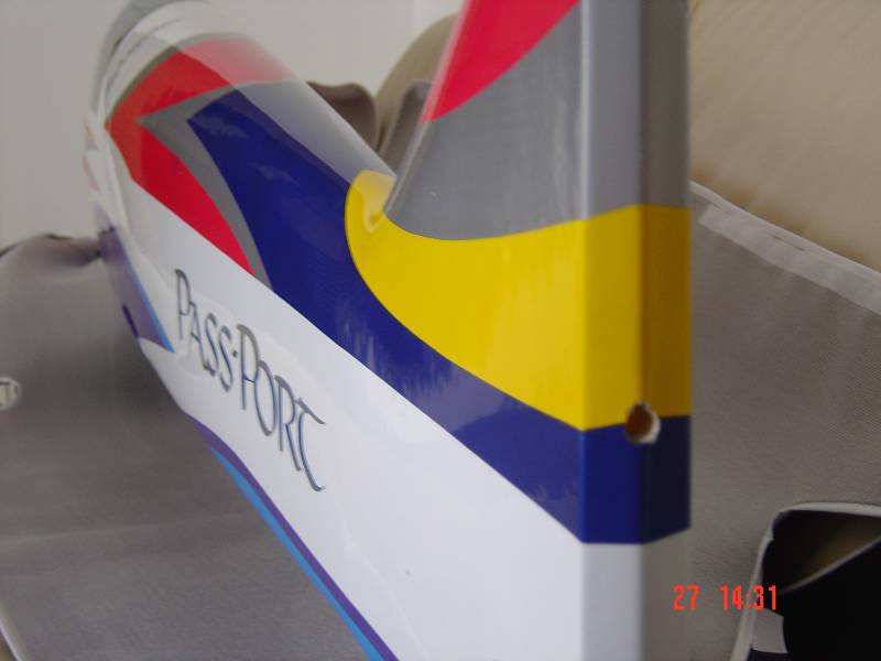

As others have said, you won't see the painting jig hole in the rudder post once you mount the rudder. Mine did not come with a quick release for the chin cowl either, but it uses a single 4-40 bolt which is pretty quick to remove.
