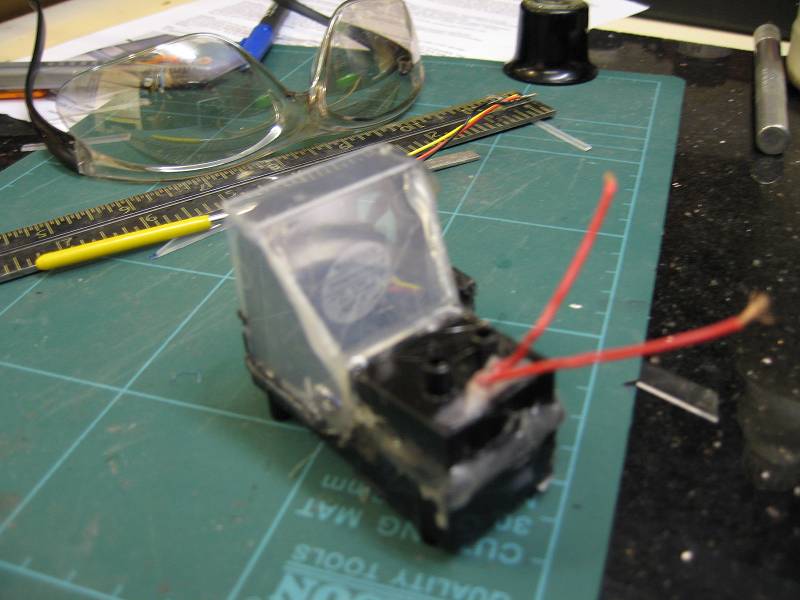

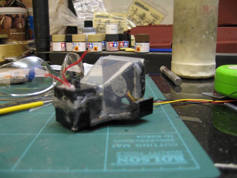

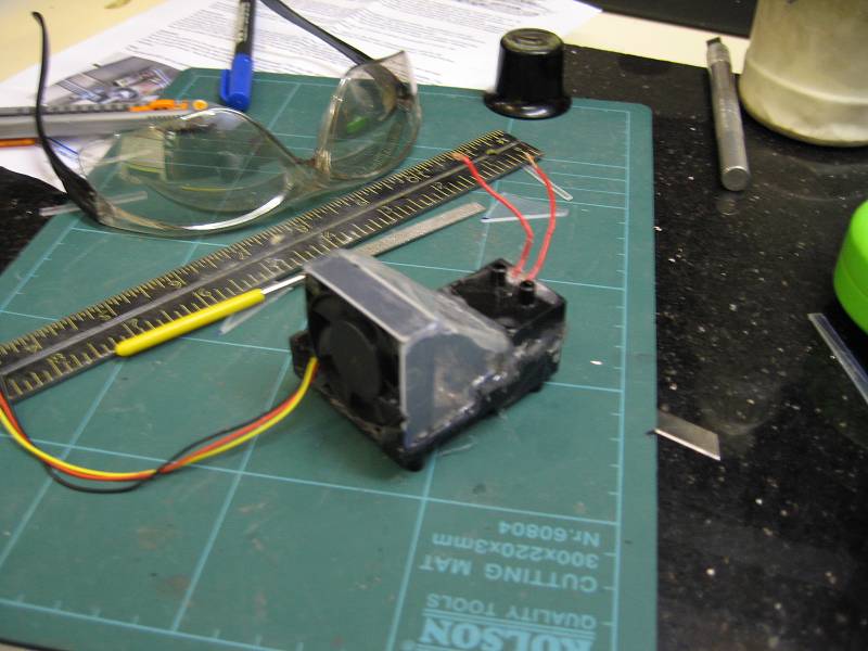

Hi Guys
Nearly changing the subject, My smoker box died after a short while as well, same problem, I did something different though, I found the element had broken as well, so all I did was got some household fuse wire and joined the broken filament together. What had bothered me since day one was the motor/pump noise, simple, I got a 40mm computer fan, cut the original smoke unit about, rebuilt it with a cd case installed the fan (with the help of a hot glue gun) and hey presto, a smoke box that worked again but totally silent !!!
Sorry about the fuzzy piccys but you can get the general idea
RE: Heng Long Tiger Smoke Unit Repair and Mod
Nice job on the tank forum's most ubiquitous smoke generator fix (the computer fan).
What I am curious about though, is more details about the "household fuse wire" you used to replace the filament. Can you elaborate on that and what it is exactly? If it works long-term, then we may have a viable fix for these troublesome little smoke units.
Whereas others promptly discard the smoker after it gives up the ghost, I always like to see one that has survived albeit in a different form.

Hi Again
The fuse wire I used was standard fuse wire that all the older houses have (you know, comes on a card, old type ceramic fuses, screw at each end, wrap the wire around the screw and tighten the screw up) it was 15 amp fuse wire and all I did was to wrap the fuse wire around the original filament wire bridging the broken gap. The smoker box were the filament is has a small hole in it (about 4mm) I drilled it out to 8mm so the air from the fan can get in more easily and also pushes the smoke out quicker and makes the smoke seem more dense

oh I forget to mention, I did this fix approx a month ago and I ran it for an hour after doing it plus I was so impressed with it I run it up most nights for at least 20 minutes and so far it is still going strong, so much so I am having to build one for my bruvver but this time I am building it into a metal box so what I will do is a step by step guide in piccys and post it if anyone is interesed in it, I am going away for a few weeks to Devon (yipeeeeeeeeee, Love Devon) so I will do it when I get back

hi laz..i too have been waiting for someone to provide info on an easy element replacement...i have several of those cards of fuse wire..!
my question is, how long was the piece of fuse wire you used..? have heard that the length of the element can affect the performance due to the ohms..? dunno much about electrics in case you hadn't realised..![][:@]

Yea no probs, I will do a video as soon as I get back from Devon in 2 weeks ( have I mentioned that I luv Devon )
The fuse wire I used was near as dammit the same length as th original filament but the 15 amp wire is smaller in diameter so making it heat up quicker and run slightly hotter hence the enlarged hole I drilled in the casing of the smoker box making the air/smoke move faster.
