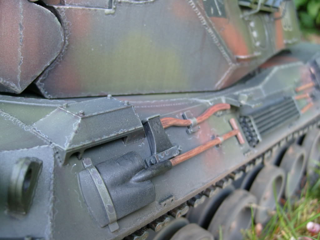

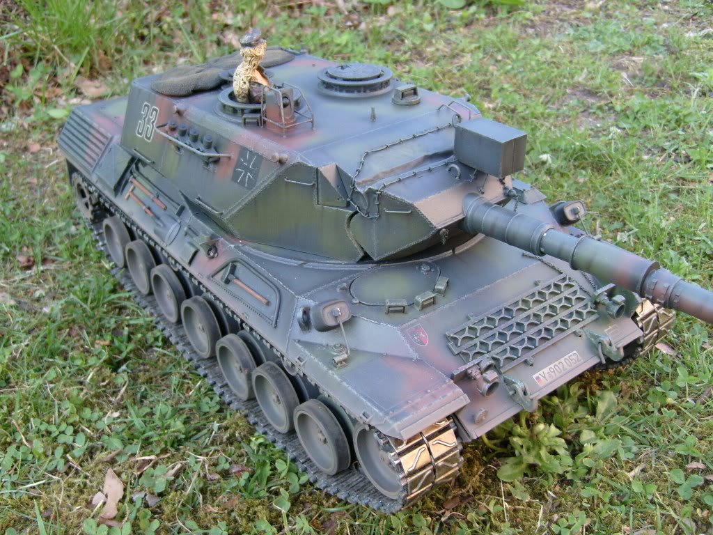

Tamiya Leopard 1A4 mit HL electronics package
1. Tamiya Leo1 that i got second hand, 1970s vintage.
2. HL StugIII electronics package + HL turret ring + Matorro T34 turret turn gearbox.
3. Extra details.
4. New paint job.
The power and performance does not do the real thing justice but at least it moves.
Film: http://www.youtube.com/watch?v=e9g3GJBxhL8
Bilder:
Cheers
Alan.
3. Extra details.
4. New paint job.
Bilder:
Cheers
Alan.

Nice job!! She can be in my crew any day! I have one waiting for restoration. It has the twin gearbox - single motor. How did you mount
the gear boxes and what did you use to make the "canvas" mantel cover? I plan to put a complete HL system it.
Also, your tracks are on backwards, mine were as well. Great job!!

As for a 'canvas' mantlet cover, I'd suggest cotton tea-towel or thin cotton hankerchiefs, and then soak 'em in the color of paint you desire. Dollar Store latex for kids diluted 50/50 works a treat (its how I make my tarpaulins/tents/camo tarps, and color my sandbags) If you want it stiff, or even waterproof'd, then paint the inside with white glue, which can also be used to tack the edges into place if you don't wanna make the wire frame w/ the bolt-down points. If you've lost your original, I have one from my pair of 1A4's thats near-mint, and could make up a template for ya.
Gotta say, its nicely done, though the chain for the mantlet plugs, etc. seems a bit large scale-wise. And then after the point of adding that chain, he didn't put the chains on the smoke-pot caps (like on the 2A6) I've got some for mine, but its on the to-do list... (amongst many other things)
I ditched the stock tracks, and went with a 'stretched' set from the Pershing. Much better cleat definition and resulting traction. I don't loose the end-clips either (those horrid cast things, ugh) that often need to be CA'd on. And besides, after you 'stretched' two sets, you have spare links for decorating, sorry, 'Up-Armoring' your tanks (2 Leo 1A4's, a Pershing & a Sherman, all using that cleat/track)
WhiteWolf

RE: Tamiya Leopard 1a4
The company in Germany that makes the conversion plate for the tamiya gearbox is called AFV and their stuff is top rate aber teuer. There is another company called Scale that also make great Leo parts. I have an aversion however to buying relatively expensive add on parts when you can make them yourself for next to nothing.
I made the canvas mantel cover out of silk and then made eyes out of staples and threaded some metal wire through.
The HL motors are mounted on a 12mm thick piece of wood.
Yep the chains are a bit thick I should have used a smaller gauge of chain. Just did not have any to hand at the time. I could put some on the smoke dischargers too.
Thanks for your comments.
Cheers
Alan
Cheers
Alan
Thanks for the advise! I tried making a mantlet cover from t-shirt cotton impregnated with "liquid tape". It looks like rubber treated canvas. But,alas, it was too stiff for the scale. I will try some black silk or satin.
The rear side grills are exhaust, correct? If they are, I was going to cut thru the slats and mount the smoke gen plumbing on each side.
Thanks again, Dimitri
