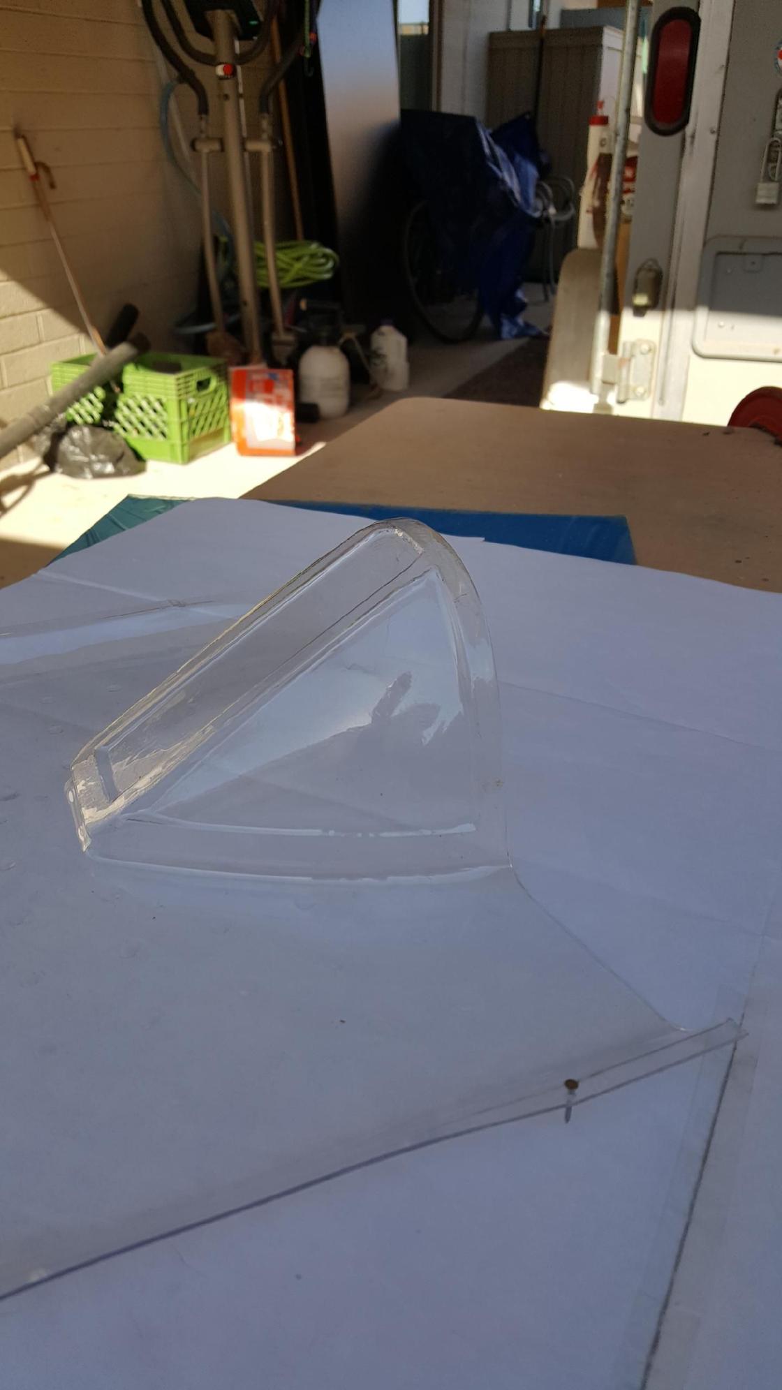

Okay guys,
Latest update.
Here is a pix of the first vacuum formed windscreen, will get to see it Tuesday when I see my friend.
Here is something interesting I just figured out, I was trying to wrap the wing with wax paper to make the wing fillets and the paper kept wrinkling.
So I decided to try some thing else, I put down a strip of 3M Platinum painters tape and mixed up some micro balloons, applied it to the tape and let it setup really hard, it released from the tape as nicely as could be, can't wait to see how it REALLY does. On the pix of the plane you will see a piece of G10 that I am using to keep the thin edge of the micro balloons from chipping.
