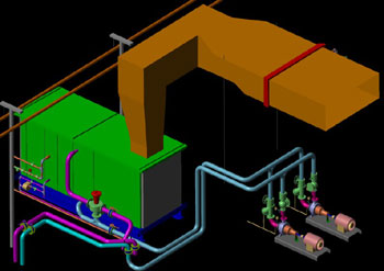

Nice work - I'm a facilities engineer myself - lots of piping and ductwork. Unfortunately, I did all of it as surface modeling. No, I do not think Mstn SE has any solids capability. That was back when "MicroStation Modeler" was still an add-on package.
I'm jealous.
I'm jealous.

RE: 3D surface modeling expert help needed!!!
Kind've took off for awhile during Thanksgiving. Here's some rudimentary stuff I do. I have a lot better examples - with materials, and proper lighting, etc. This is pretty representative of what I do on a normal basis, though. I also have no add-on packages, this is from scratch with the out-of-the-box program:
