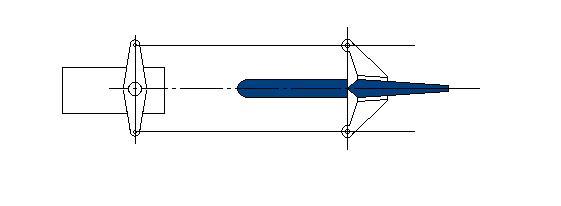

Default Pull Pull Rudder??
How do I get the slack out of the wire opposite of the one being pulled?

Unless it is excessive, you do not want to get rid of it. You have positive Ackerman (a desirable trait for pull-pull). As mentioned above, it is a matter of geometrythe relationship of the hinge points relative to where the pull-pull lines are attached. Google "Ackerman" and delve through the list for where it applies to RC for more info. You may even find it if you do a search for Ackerman in these forums. Without some positive Ackerman, you will strain your servos and could even cause problems in excessive current drain at high surface deflections, even worse, negative Ackerman and you will have some Ackerman effect unless you managed to get every hinge point and attach point absolutely perfect (an almost impossible task).

The geometry thing is easy to setup IF you first take round servo wheels - one at the rudder pivot (hinge line) and one on the servo.
IF -all holes used in both wheels are not in same relative positions, the distance from servo to rudder connecting points will change
On a 40% model , as much as 1/8" offset on one hole will cause a noticeably uneven setup.
You can rig up a test setup to proove this, on carboard using wheels and some pin pivots and two lengths of piano wire to simulate the cables.. .

The servo arm should of course be at 90° when centered so that the motion is symmetric, Ackerman serves a different purpose here. The rudder horns are intentionally not rotating around the exact center of the rudder hinges (instead it is further aft), so that the line that isn't pulling will give a slack. This way, it can be setup to have zero slack around the center position (where it is important) and a little slack when it doesn't matter, i.e. at large deflections.

Anyway, for a truly accurate linkage, everything should be stacked along the same centerline and more importantly, the linkage must be symmetrical.
If the servo shown in the illustration were an elevator servo mounted off center from the elevator centerline, then the control horns would need to be offset so that the cables are perpendicular to the ACTUAL lever arm at zero deflection. AND a line drawn thru the pivot points of the control horn must pass thru the hinge point.
That's the illustration with the green control horns. That would be extremely impractical and it's a major justification for computer radios.

Again, I see some comments in some of the above posts that are not really correct. As one who has been setting up pull-pull on both elevator and rudder on dozens of large (1/4 scale or larger) with success, I will just mention some of the false statements.
You must always have equal lengths on the servo and on the horns on the surface: definitely not true, what you have to make sure of is that the degrees of rotation of the driving arms does not travel so far that the moveable surface horns are rotated past 180 degrees. i.e. as long as the surface being moved does not move past the point where the non pulling line starts to tighten. It is easy to demonstrate this with a compass and a sheet of paper, just draw the respective arcs and measure the distance between the fixed points on the arc for different degrees of throw.
You must always have the attachpoints at right angles to the hinge points of the surface being moved: again false, what you want is to have the attachpoint offset from the hinge point (that is how you get the desired positive Ackerman effect). Realize that if you get the attach point on the wrong side of the hinge point you will get negative Ackerman which can be very bad as both lines try to tighten as you move the surface away from neutral.
You must have straight line shots between the servo and moveable surface: again wrong, if you use the proper guides you can change directions a great deal to enable routing the pull-pull lines around structure or to make exit points in a better location.
It just takes a little common sense and a few sketches to set up a reliable pull-pull system that allows you to make the best use of available space for servos, unusual routing of lines etc. If in doubt, connect a dummy setup of what you want on a mockup which is easy to make with some scrap wood, some cardboard and a little time.
