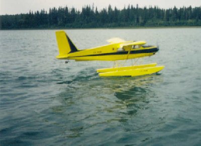

OK flew this 8 footer with an OS .60 2 stoke on wheels, takes about a 50 foot runway.
On Floats! takes about 200 feet and needs some rocking to get it up, but was better after I used flaps.
Installed a Saito .91 Golden Knight, inverted. and run in on ground, then a few flights on wheels before leaning out.
It uses about 12 feet of runway to take-off with full flaps. and about 18 feet with no flaps. weeeee.
I reinstalled the floats, and flew it on water. The engine ran flawlessly. sounded awesome too.
I practiced taxi'ing a bit, and then went about 2/3 rds throttle, dropped the flaps and,,, the plane lifted effortlessly out of the water. surprised me as I was expecting to have to wait for more speed.
Done some scale slow speed flying, then went radical, Immilmans, snap rolls, Loops, hammerhead stalls! This thing has almost unlimited vertical! even with floats. I could hear the kids on the beach squealing everytime I done a radical move! Loved it.
Meanwhile the wind kept getting stronger, and this thing flies about 40 minutes per tank. average on 1/2 throttle. 16 oz tank.
I put 1800 Ma Batteries in the plane, so I don't have to worry about low batts.
After Landing, I ran out of film, and was taxi'ing it back when the wind got under one wing and rolled me over in the water. awww!
retrieved it. left it upside down until the water drained out. and then turned engine over slowly to expell any water it took.
re-started it. set it back down in the water, left it idling.
went to pull up the boat anchor. and the wind tipped it over again. (heavy sigh...). retrieved it again. called it a day. went home. re-installed the wheels and went flying it that evening.
GOlly Gee Gosh! I love this plane. LOL

Flaps up after landing should help. It does on full scale. What is the distance between centres of floats? It should be about 20% of the wingspan.
20% of 80" wingspan = 16"
I read someone's article on floats,,, (Howard I think but don't remember). who recomended 25% of wingspan for stability.
which shouldv'e put me at 20". So I am pretty close.
After looking at the water in other float plane flights. I come to the conclusion that it was the wind gusts combined with the flaps that we're the real culprit.
I also decided to not launch it while sitting in the boat anymore. It is just too crowded for safely starting and launching the thing.
From now On I will have the boat ready to go, but will just start the plane and launch it from shore. Then I can just taxi it right up onto the beach when done.
I'll just have to wear a scary mask, or uhmm,,bring my wife, to scare all the little kids away! LOL.

Smoky, the center line spacing is 20" which is about 20% of the wing span. I haven't done a final balance yet, but I checked it a few times while building. Will let you know when I do. Gotta go help another RC'er move today..........Seaplane
Turbo Beaver Float flight
Smoky,
Cool job! It is abviously VERY light since to takis without even getting the floats very wet. It looks like you could add some incidence to the plane to get off the water sooner. Drop the tail about 1 1/2" from where it is now. THat's why it gets off so quick with wheels: you can rotate more to get more angle of attack.
Remember to hold the upwind wing down with aileron and MAYBE it won't blow over so much. No guarantees, and once the wind gets under the wing, it's strictly up to God whether it goes over or not.

Thanks for the tip.
The Photo you are referring to, I think, is the one in the post.
this was taken just after I dropped the flaps, and about 1 second before lift off. it really sits alot deeper at taxi speed or idle.
My 1st flight I had too much incidence!
and I was using a 2 stroke OS .60 engine with a 3 Blade 12 x 6, and that was when I had trouble with it.
thus the looks of this one now. the take off's are actually easy.
It came out before I was ready for it! LOL Love the Saito 4 stroke .91 power swinging a 3 Blade 14 x7 prop.
When I get to (er,,have to) rebuild my Struts. I will add the incidence then. probably go 1/2 way between the 2 set ups I've used so far. This shallow incidence sure makes it easy to land tho! LOL

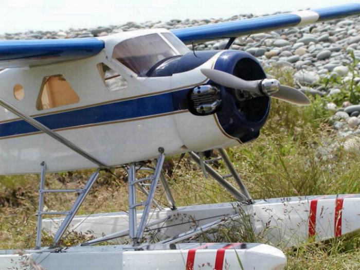

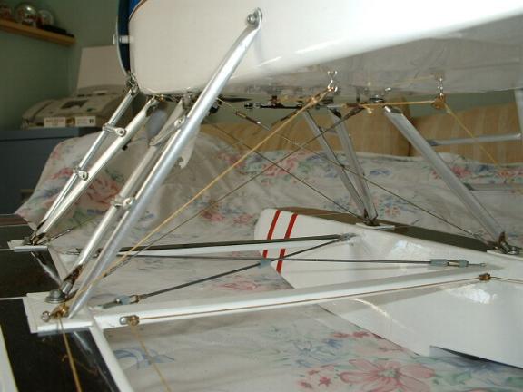

The struts are music wire with airfoil shaped aluminium slipped over them, the steps are aluminium tube squashed flat at each end and attached with model railroad screws. I drilled a tiny hole with a pin vise first.
The cross braces between the floats are basswood (they are built into the float during construction, the floats were scratch-built as were the struts).
The x-bracing between the floats is 2-56 rods threaded on one end (for adjustment), the other end is soldered. The fine wire bracing is pull-pull wire, once again with one end soldered to a clevis and the other soldered to a threaded clevis to allow adjustment. The wire bracing is functional and required. Without the bracing the assembly would have no strength.
I've attached a couple of photos to show detail. You can see the steering tiller on the bottom of the fuse. It controls the water rudders (two) via pulleys as the full size.
