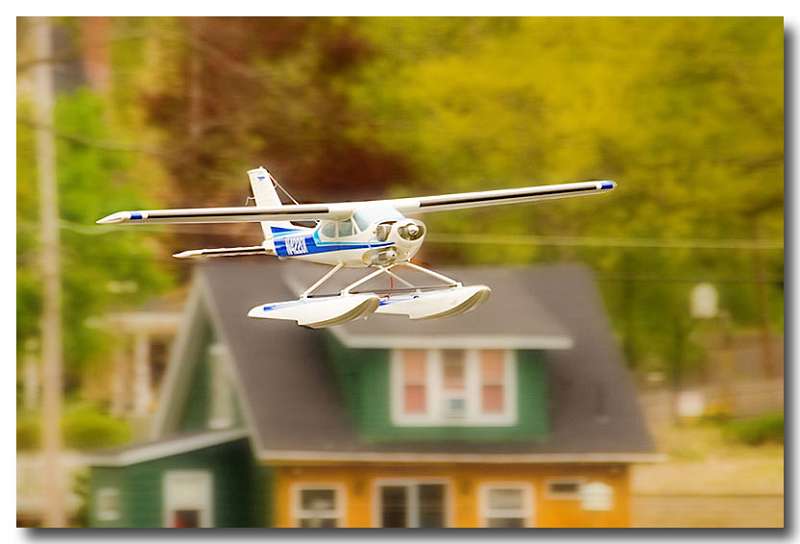

I flew mine on Saturday for the first time on Floats. I havealmost 200 flights on this plane from wheels and it has been my "favorite" plane for almost 2 years. I was totally disappointed with my flight performance.
Let me begin by describing my setup.
On wheels: OS .61 FX APC 12X6 prop, 5-cell AA pack in front of the servo tray, Receiver is under the servo tray.
On Floats: Same engine and prop,receiver under the servo tray, 5-cell AA pack behing the main landing gear mount.
The plane would not take off without deploying flaperons. It flew like it was tail heavy, constantly porpoising although the CG checked out OK.
Any ideas? This is an excellent flyer on wheels but so far I'm pretty disappointed with it's performance off of floats.
Any ideas???
Any ideas???

Surely something is wrong. Mine had the same engine and prop and took off in 50 feet or less. what does yours weigh with the floats on? Are the ailerons reflexed (raised above neutral)? Do you have enough elevator travel? (It will need more on floats than on wheels.)
Are you an experienced float flier?
Jim
Jim

2. The ailerons are neutral
3. Although I have flown the Mariner (seaplane) quite a bit,this is my first "Float Plane".
4. I don't have a lot of elevator. In retrospect,that could be the take off problem.
Where is you battery pack when you're on floats?

I asked about your float experience because some beginning float flyers try to take off as you would from tall grass and that doesn't work. Forgive me if you already know this.
- Hold full up elevator as you taxi out then throttle back to let the airplane weathervane into the wind.
- With full up elevator, advance the throttle to full, then immediately begin releasing the elevator as the nose of the floats rises out of the water.
- After the airplane gets on top of the water, let it run along at full throttle, with no elevator input, as it gains speed. Try not to use the rudder during the take off run.
- When flying speed is reached, pull a little elevator to break free of the water.
Hope this helps.
Jim

Thank You Jim. Believe me, I never get upset when people are trying to help me! All input is greatly appreciated.
I can remember easing the throttle forward and as speed picked up the floats came up on plane. It was really moving across the water. Someone actually yelled out "Nice Boat!"
I pulled back on the elevator and it had no effect at all on the attitude of the plane. It just kept skimming across the water at a high rate of speed.
Next run I deployed the flaperons and it took right off. I think it may need some CG adjustment.I'm going to check it again.
Thanks again
Bob

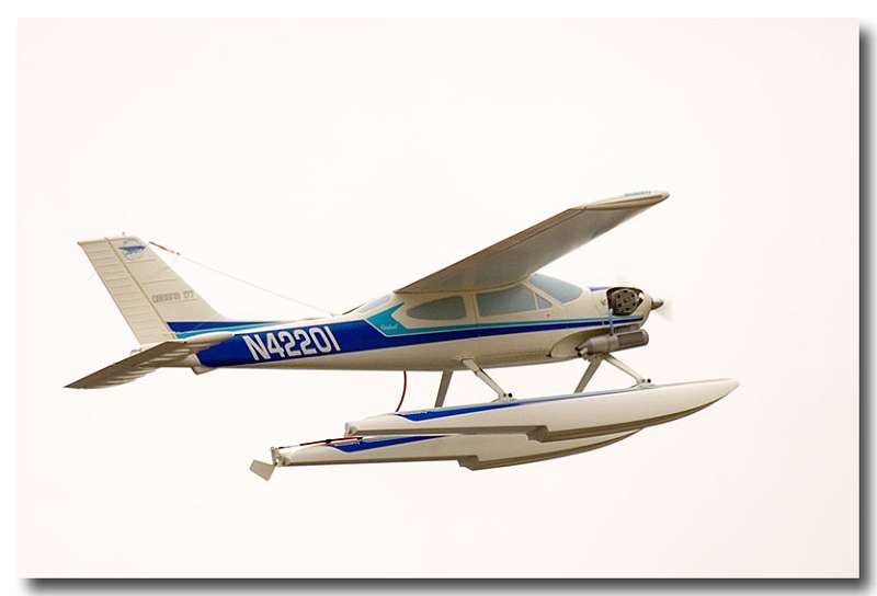

I have a Magnum 91 4 stroke that is probably heavier than the 61. My battery is as far forward as the firewall permits. The receiver is just behind it. With this set up it was a perfect balance and did not need extra weight. Total weight of plane is just over 9 lb on a postal scale. Takes off at 3/4 throttle with a 13x6 prop. I set my elevator 1/2" up /down movement. This is actually too much once its air borne.
Check your float to wing incidence. Using the supplied mounts and hardware should give you about 2 degrees of negative (nose pointing down) I also have my c/g set at 75 mm from leading edge. I think the instruction states 75-80.
It takes off with a short run. I tried the flaperons and it did make a difference, but only used it once to see how it handles. It flies very gracefully and good flying characteristics. One warning, little more speed and altitude is your friend. I assume you have read the post regarding steep banking and spins.

Clarification on incidence. The nose ,bow, of the floats should point down, away, from the nose of the plane as if pointing away from each other. Not too much. 2 degrees is just perfect for mine.

I'm using the stock mounting system for the floats and I bought the plane with the floats in the kit so mine should be the same as yours.
With your setup,engine used and battery placement, I would expect yours to be seriously nose heavy.

Meesh, Magnum 91 FSR weighs 3 oz. more than an OS 61 and I believe it has more thrust. I'd like to swing a bigger prop, but the arc would reach the spray. The 13" just stay free of it but occasionally I can hear it as it it getting up on plane. The balance as I described it is right on the money and the performance is satisfying for me and will keep up with my flying skills.

Boy you guys got me checking my Cessna to see if it was set up any different then yours and basically mine is the same and I have NO problems getting it off. Here are a couple more things to check.
1. Check that your floats are IN LINE. Measure them front and rear.
2. Double check your CG, mine is also 75 mm.
3. Maybe try a 12/6-3 bladed prop.
In your #4 photo it looks to me like you are not really getting up on the step before letting off a little on the elevator, due too?? not enough power or not enough elevator ???
I fly mine with an OS 91 4c and a 12/6 3 bladed prop. I haven't had much use for 3 bladed props on smaller 2 cyl eng but I love it on the 4 cyl. The 3 bladed gives a little more clearence above the floats. I hope maybe something here will help you as this is one Super float flier. ENJOY!!!! Red
