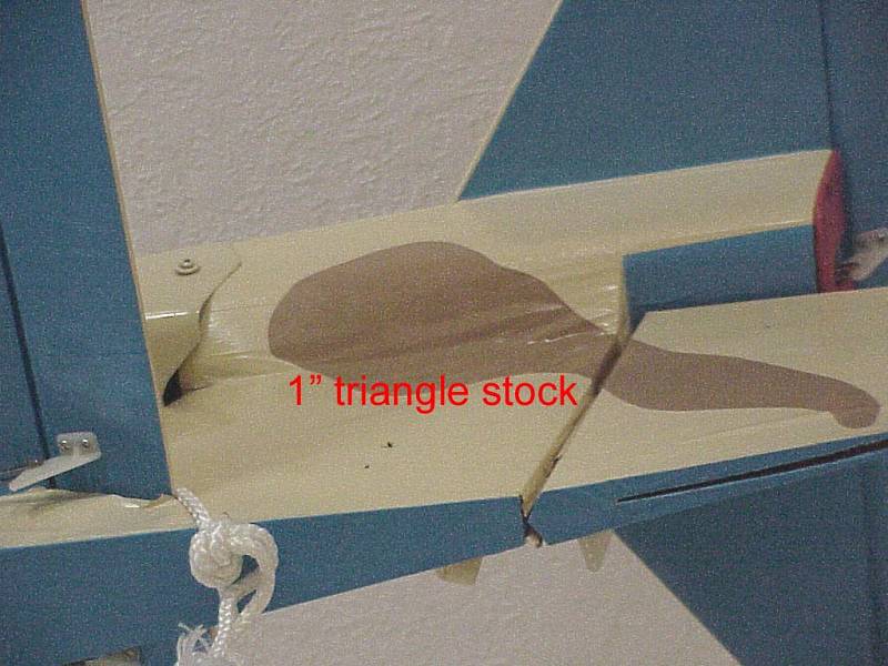

On one of my Northstars I grooved a 'divot' in the fuse to allow for larger diameter props, and I believe that this is a better solution than raising the engine pod. In addition to the other considerations, increasing the height of the pod will reduce its strength. I've included a picture of modifications that I make to my Northstars (four of them) using 1" triangle stock under the pod instead of using fiberglass as is suggested in the plans. This makes the tail fin/pod much more rigid and able to handle the inevitable rough landing much better. Also note the other modifications in the second picture for improved water handling.

Here are a couple of pictures of the 'divot' I created in the fuse for prop clearance. The covering job looked a lot better about 50 flights ago!
