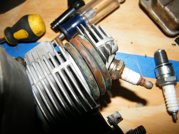

here are a few more pics and then a pic of the water cooling that is on 3 of the engines I have.

It looks a lot like a Mac that I have that is 21cc. Mine has roller instead of ball main bearings. Fine for a boat; not so good for an airplane engine.

Wholly old timers !!! Thos Mac 80s were clones of an ECHO SRM-200 engine from back in the mid 80's early 90's era.
Ignitions in those are RPM limited at @ 11K if memory is correct. Bore is 32mm stroke 26mm, displacement 21cc's
Hate to burst your bubble, but engines are not worth a hoot as a boat engine, without being able to spin them up to higher rpm you can't get any HP from them ... been there & attempted that .... 20 years ago !!
Transfer ports are really small and casting allows very little opening up larger. 2 bolt cylinder and if i remember the 80's correctly, piston was chrome plated and cylinder bare aluminum. The 95's were aluminum piston & chrome bore.
Sorry to sound so negative, but these engines and the trimmers they were on were part of the start of disposable power equipment and the final nail in the coffin for Mc Culloch corp.

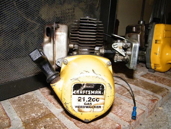

I also have an old sears/ craftsman weed wacker engine i'm considering using. Its a kioritz 21.2cc engine that has idk if its points or a magneto thats in the same housing as the recoil which is in the back. It also is about a good pound less then the mcculloch engine. I can probably knock another half pound off. if anyone has any input on this engine let me know lol. thanks

the Ryobi would work ok if you flipped the engine upside down, which would pretty much just involve rotating the pullstart location to the other side. it's limitation is it's crankshaft and connecting rod, doesn't like to survive life above 8000rpm (well, 8000 as a safe limit that is).
kioritz are well built strong running engines, but the ryobi would have more power

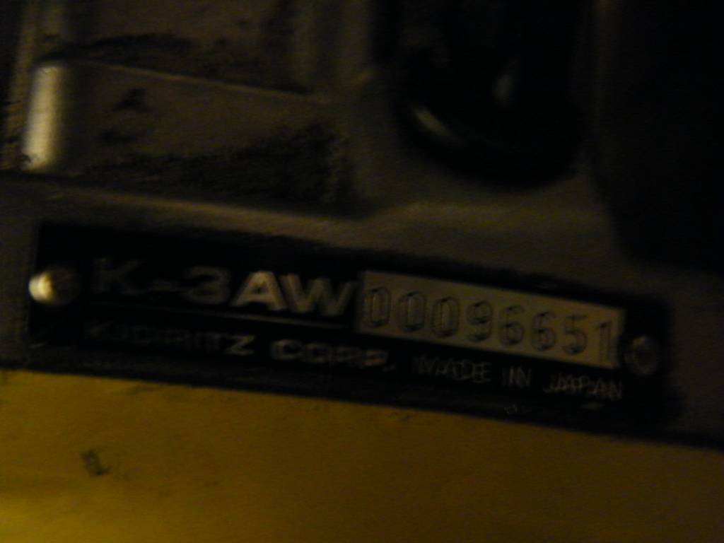

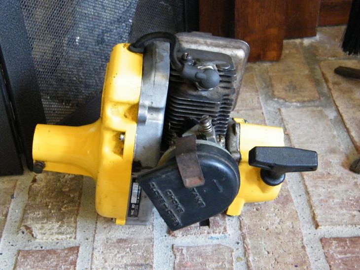

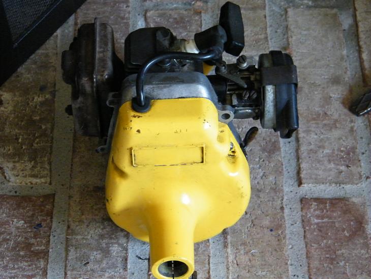

here are the pics. the last one is blurry and dark but it still visible. if you need more let me know. And one last question. the way a few of the engines i have have the middle fins machined down and have that copper tubing wrapped around it(pic in first post) would that be sufficent cooling? thanks

I can't answer that question, but if you don't have the fan schroud for that kioritz, I wouldn't run it as is, for air cooling you need the schroud

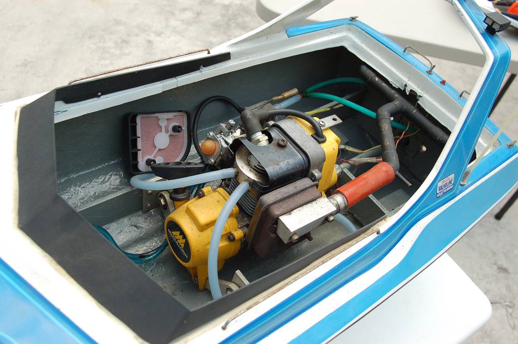

you do worry me Scott. Vaine , you must remember Scott is a motor head just like me. He competes big time and HP is his game. but sometimes its not all about the HP. As a motor that is probably one of the easiest to work on a convert to marine. it has lots of old articals showing how to watercool it, and the crank is solid with bearings at both ends. its also very compact and has its own clutch which is one of the reasons it was popular.
With that said these motors were around during the start of our great hobby. i have a box-load (40) of them sitting in storage brand new never run. they make great model boat engines and i have even seen a couple that were converted for planes. as long as your not looking to go Mach II. I have several old boats powered by watercooled versions of this Mac/Kiortz engine. they run all day long with no problems . they can run 20-30 mph in 48" hull depending on your set up. its not 50? but its still fun.
these pics are of the first boat i ever built in 1985. it has a mac engine and an AMPs drive on it. Still goin strong today.
good luck

That is a Kioritz/Echo SRM-200DA from the early 80's
A really tough industrial motor too !! ... same bore and stroke 32 x 26 = 21cc
* My first successful marine conversions were done to these exact engines. Still have a box of parts, cylinders,pistons, ignitions, etc.
Hot ticket in the day was to use vertical spark plug cylinder off the PB-200 blower on those cases. Loose the flywheel & clutch and water jacket the cylinder.
If interested in some trick 20+ year old pieces to build one up ? ...... ask, will make ya hell of a deal.

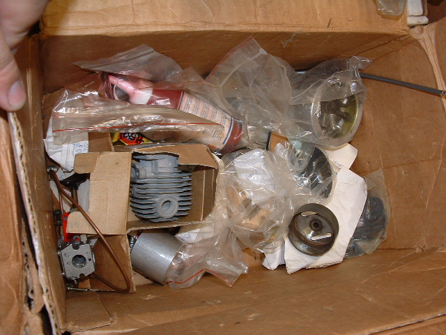

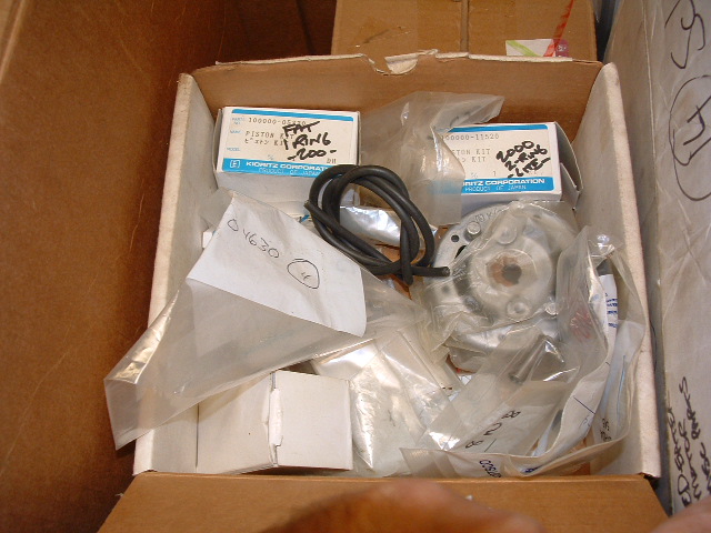

Just food for thought ...
We are not talking a box of used discards here, MANY are NIB parts and those out of package are like new. There are parts here to built 2 engines and still have some spares.
Basically the spoils of a guy into RC boats who had the access working within the industry to get the best of the best to build this specific engine into a great power plant.

Dam Scott theres quite a few goodies there for the money.

Mart,
Ya know I have been rat holing this stuff for years !! .... Maybe I should assemble one and install in a double pontoon retrieval boat of some sort. Maybe put into an old hull and sell off as a play boat ?
Damn shame to let it sit collecting dust for another couple decades [:-]
