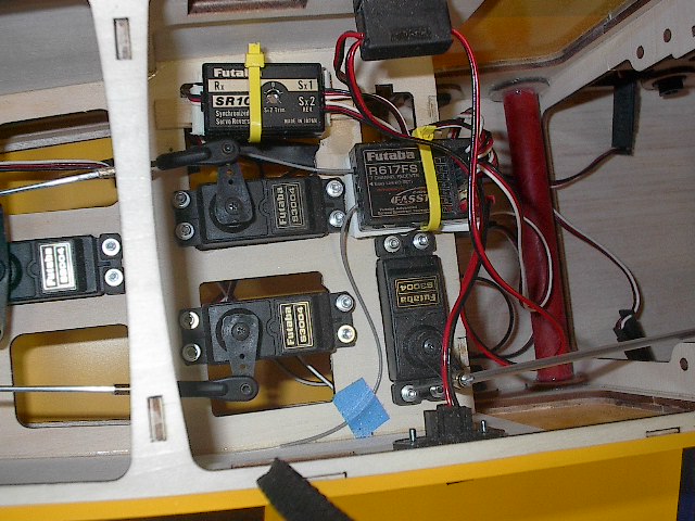

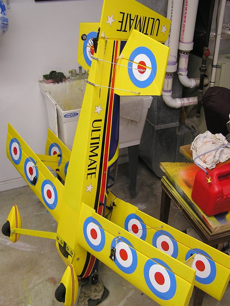

I am almost done building this model and I have run into one problem that I can't seem to solve easily. I used the 3 X 40mm screws for the elevator posts instead of the reccomended 3 X 30mm screws because they lined up much better with the fuse exit holes and did not bend the control rod all to hell and burn up the servos. Now I am left with no 3 X 40mm screws for the ailerons. I bought some 3 X 40 mm screws at the local hobby store and when I got home I realized the threads did not run the length of the screw so I could not tighten them on the control surface so they turned out to be useless. Wow, what a nightmare. I e-mailed Seagull models and, no surprise, I got not response. I googled 3 X 40mm screws and got nothing. Anyone know where I can get 2 lousy 3 X 40mm screws!!! Thanks in advance
Old 03-05-2009, 05:34 PM
  #60
Sierra11861
Sierra11861's Avatar
Join Date: Aug 2007
Location: Frederick MD
Posts: 125
Default RE: Seagull Ultimate
I just put regular controll horns on the elevator and moved the 40mm screws to the ailerons. I am close to finishing, will post pics when I am done

Does anyone know how many oz. the stock fuel tank for this kit holds? I am flying it and getting only 10 minutes of flight time with a YS 140. I know the 140 drinks fuel like coolaid but...still, 10 minutes until dead stick?.....I have to set the timer at 9 minutes, that is a little too short of a flight time for me. I was thinking of upgrading the tank to 20OZ. thinking that the existing was a 16 OZ, but I am not sure since there is no info in the manual or anywhere on what size the stock tank is!?
Old 04-08-2009, 06:58 PM
  #62
RonMcCormick
RonMcCormick's Avatar
Join Date: Feb 2008
Location: Joliet, IL
Posts: 330
I thought it was 14oz, I'm sure if it looked like 16oz I would have replaced it with 14oz which is plenty for my OS 120. I have not flown mine yet (other projects). How do you like it? Pics? You could just fill it and pump it out to a marked container to know for sure how much you burn.

Ron, I drained the stock fuel tank into a 16oz dubro tank and pictured below is the result...looks like the stock tank is approx. 15oz.

Plane looks good, so what size tank will you go to? 20oz?
