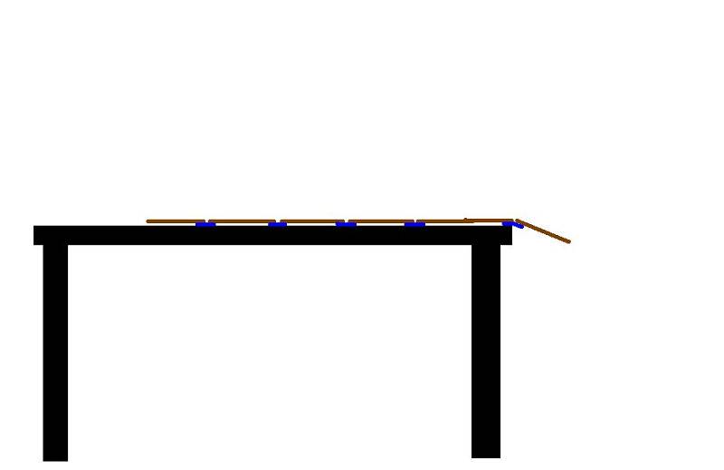

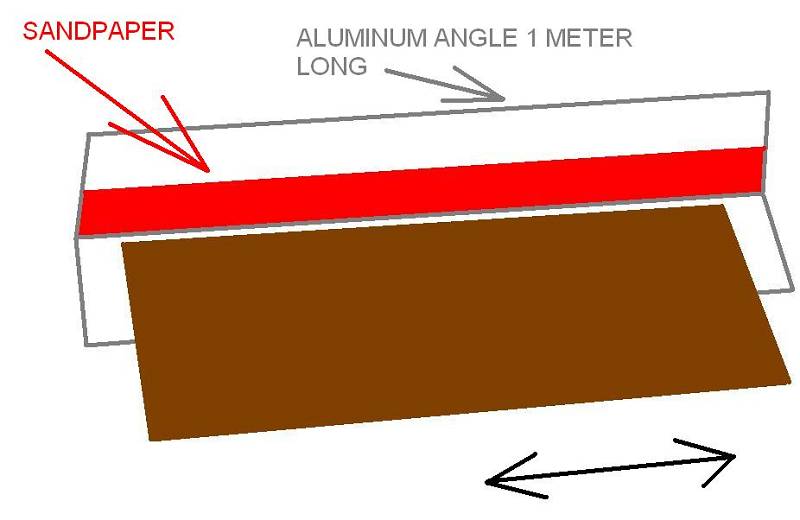

When sheeting a foam wing, you need to sand the mating edges of all the balsa sheets. This will assure that all the edges are perfectly straight. Then, when you glue the edges together--you are gluing a straight edge to another straight edge. Trying to glue balsa skins together without sanding them will lead to wrinkles and then bumps and warps in the finished product.
I got a piece of 3" aluminum angle at least 1 meter long. Secure it to the workbench and use sandpaper with adhesvie back along the vertical edge. Now, you lay the balsa sheet flat and slowly and carefully sand it back and forth a few strokes untill the entire edge is perfectly straight. Do this on BOTH side of EVERY sheet.

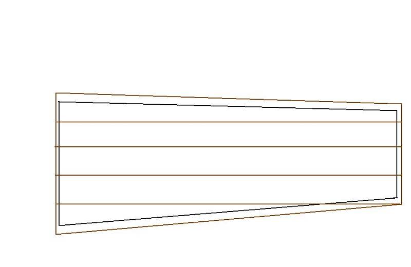

I like to pre-fab all my skins. It usually takes 4 or 5 pieces of balsa for each side of each wing panel. So, get 5 sheets and lay them out flat on the bench. Place them on top of wax paper. Push each piece up to the next piece and assure that the mating surfaces are going to line up perfectly without any wrinkles or warps.

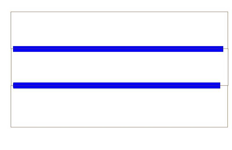

Now use masking tape to secure all the sheets together. Just use a piece of masking tape along the glue joint between all the sheets of balsa. If your using 5 sheets of balsa, then you'll have 4 joints to tape. Run a strip of tape down each joint and tape all the sheets together to make 1 large skin.
Now pick it up and flip it over. Tape on the bottom.
Now you just slide the sheets over to the edge of the table and let the joint flex open a little bit. Run a bead of glue into each joint. You can do 2 joints and then spin the sheet around and do the other 2 joints.
I like to use regular carpenters wood glue for glueing the edges together. After you put glue on all the joints, slide the skin back on the bench and allow any excess glue to squeeze out. Wipe it off with a wet paper towel. Allow the glue joints to dry for several hours.

Another important note: The balsa strips must be prepared as a sheet as several describe above. I don't think spray adhesive would work for individual sheet application as there is no repositioning once contact is made.
For this reason, sanding should be done prior to the glue up of the strips. Fit them together with masking tape on the back side, place on flat surface and sand. Then flex open the joints and using a very small brush, lay 15% thinned titebond on the edges, press flat and wipe excess glue away with slightly dampened rag. Weight down to dry. As others have said, making the sheets up, sanding should be done prior to gluing joints as the hard joints will not sand even to the surrounding balsa.
A word of caution... I used 3M many times on foam core wings many years ago. It would be wise to ensure that any spray adhesive chosen doesn't attack foam.
To keep the sheet and core seperated while locating the sheet... some strips are needed. I may have mis spelled "venition blinds", I refer to window shades that open and close. Years ago they were metal and now are almost allways plastic. The strips from a discarded window shade work very well as standoff strips keeping the core and sheeting seperated until contact is desired.
A really nice result of using spray adhesive is the speed factor. Once the sheets are prepared, the four skins can be glued onto the cores in a matter of a few minutes and immediately be ready to trim and apply leading and trailing edges and tips. I've often done that with spray adhesive as well.
