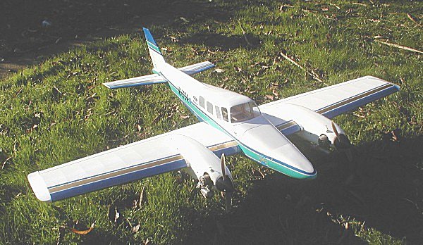

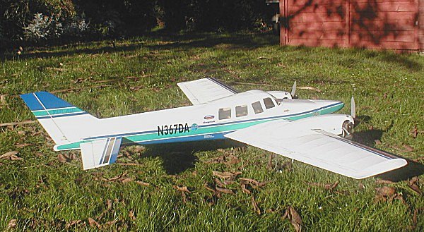

Guy:

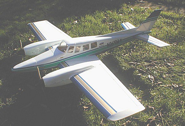

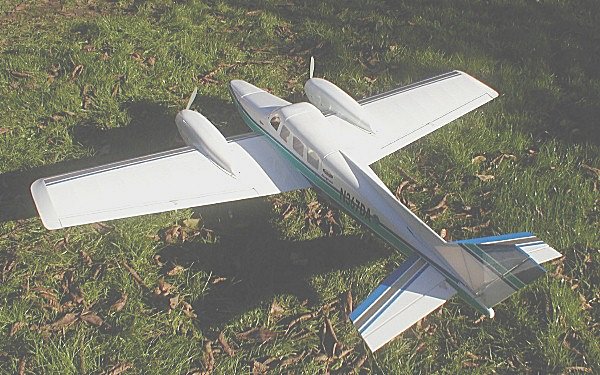

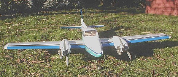

A little bother to get to your club site, but I managed it. Then I had to find the plane. For those who go in, it's listed under "Projects."
To save others the effort here are the pictures, cleaned up a bit of course.
Bill.
Bill.

That is good looking aircraft. I wonder why someone who is trying to sell a model does not include good quality pics. When I first saw the pics on the seller's site, I passed it off as "goofy" looking, but the pics added to the thread show it is much better looking.
I noticed the website mentions "channels-6", & "servos-7". Does this mean that it has flaps and retracts?

Bill, thanks for capturing and posting the pictures! That is a handsome airplane. I definitely see it in my future now. Just need to get one stateside.

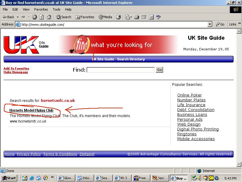

Sorry, I missed a couple steps to get into Guy's site. Just went in gain, and made screen shots along the way.
1) Click on the link in Guyglo's post.
2) Cut and paste the club name into the search box, and click "GO."
3) Even though this looks like you've been sent back home, click on the club name.
4) Now click on "Projects (etc)."
5) Select the "Seagull Twin,"
6) And there you are.
Sorry for the error.
Bill.

Hello again from the UK.
Sorry some are having trouble getting to the Hornets web site for my Dual Ace pics. If you type in www.hornetsmfc.co.uk into your browser it works fine. It is only the link from this site.
Anyway thanks for putting them on to this forum.

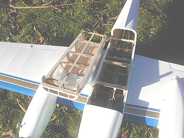

There are three servos in the fus, rudder and 2 elevator, in the wing there are 2 throttle and 2 aileron. No flaps and retracts.
The wing halves slide on to a substantial alloy tube and are fixed in place with 2 large nylon (?) screws each from inside the fus. Canopy in held in place by 4 set screws. Throttle and aileron servos have to be connected up once the wings are in place. All pretty quick really.
No spinners are supplied in the box
Just for those who may be interested she fits fully assembled into the back of my Chevy Lumina APV - but only just!

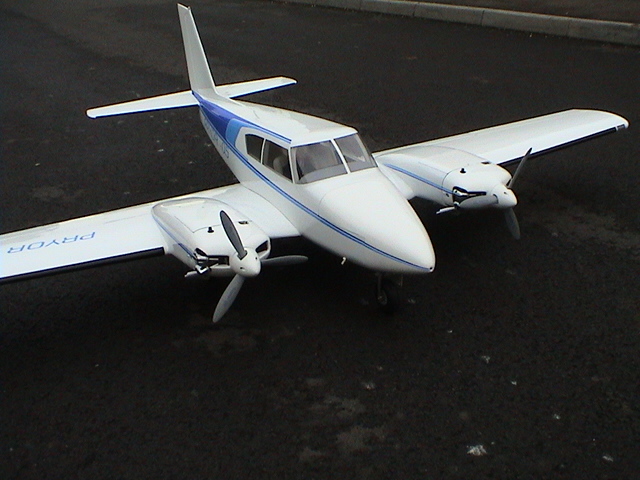

hi all here is my config, have got it last nov and madien.. since done 2 flight.. flies really well though
Servo JR 539
Engines: 2xSaito 72
Prop: 2x12/6 Mas
here is the link to the video
http://www.daddyhobby.com/forum/showthread.php?t=11306
