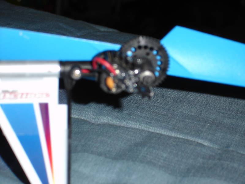

I came up with a simple upgrade that will fix a common problem with these helecopters,
the tail motor gets hot and burns out and none really makes a heatsink that fits,
i made a tail heat sink by cuting a gws heat sink, it could be cut another way but i made it work this way,
It is held in place with hot glue,

I have one also. I agree with the requirment for a heat sink on the tail motor (also on the main motor). I have found that the heat sinks for the Blade CP/Esky models fit well and without modification.
The Eagle flies well and does, in my opinion, fly better than the Blade CP (I have not flown the Blade CP with the Bell-Hiller upgrade yet.

Just a fast note-when installing the heat sink put some transistor heat sink compound on the motor first, the heat sink will draw much more heat away and the motor will last longer.(you can get it a radio shack or any electric supply store for two bucks)

The Blade cp flies alot better with the bell hiller upgrade,
its worth every penny,
the blade/honey bee cp heatsink would have worked on the eagle 50,
but I did not want to take the pinion off of the tail motor,
the biggest problem I am having with the eagle 50 is the location of the idle up switch,
i have problems finding it,
