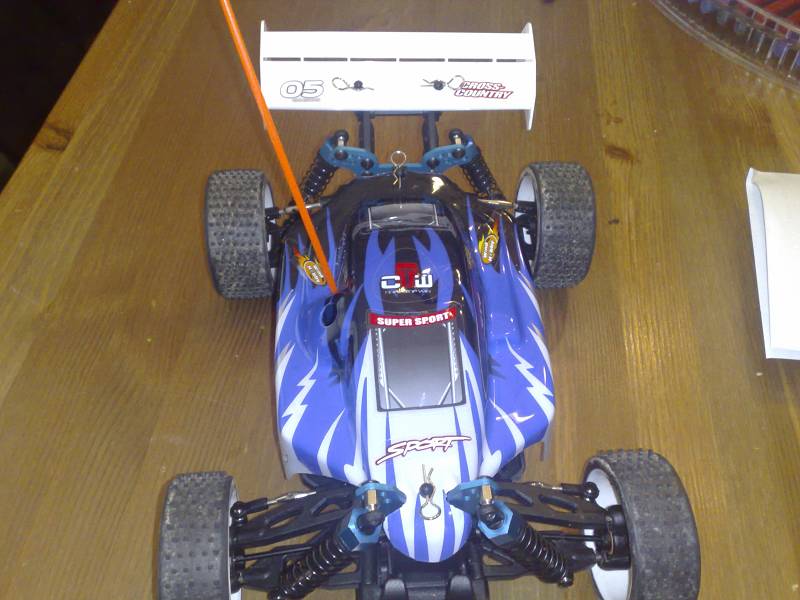

Old 01-10-2008 | 12:05 PM
Joined: Jan 2008
Posts: 39
From: Bayside, NY
Default RE: Wind Hobby Ferret 1/16th Electric Buggy
Here are some pics of mine all stock.

I was wrong looks nothing like a KMI with the body off. How does it handle and are there any weak spots on the buggy?
Old 01-10-2008 | 12:46 PM
Joined: Jan 2008
Posts: 39
From: Bayside, NY
Well when you rebuild the shocks with 30 wt because thats what i used it handles very well on and off road it takes jumps well also, nice and balanced, iam sure as this thread grows we will find all the weak spots on this buggy, me personally i haven't broken anything yet, but one thing i want to upgrade is the diff and get threaded shocks. O one otherthig that surprises me is that the ESC can handle anything down to a 13 turn motor witch is very good for the price of this buggy, but knowing me i might put the esc thats in my rs4 micro but would hate to lose the reverse.
