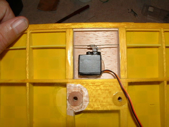

I have 4/40 metal pushrods in a 1/2A model for rudder and elevator. I believe I cut significant weight by using something else.
What type pushrod do you recommend that 's light but still strong?

I use the Sullivan 503. They are a twisted .032 steel cable inside of a plastic sheath. I'll attach a couple of pictures of an aileron installation to show how they might be used. They are very light and bullet proof if used properly. Good Luck.... Jeff

Here's a picture of the aileron horn end.

GT, you are right, you can save some weight by changing those pushrods. I have successfully used the cable mentioned by Jeff many times.
You could also drop to 2-56 size pushrods and clevises and save some weight.

I concur with Jeff -- the .032 Sullivan cable works very nicely. Since the cable is flexible, you need to be careful about long unsupported lengths extending beyond the outer tubing -- I will usually saturate the cable with solder in this area to stiffen it up. The cable also is execellent to use as throttle cable in larger models. I am amazed at the heavyweight linkage most builders use for throttles -- unless it binds, there is hardly any load and the lighter cable is sufficient.
I buy the .032 in a bulk pack (Sullivan S522), 30' plus 8 thru hole threaded couplers in 2-56. The couplers can be purchased separately (Sullivan S512). I prefer these to the standard couplers. These couplers are a heavy wall tubing that has been threaded - with the hole passing all the way thru, I will usually cut the unthreaded portion off and use only the threaded section. Sometimes, I will shorten the threaded section, especially when it is used at the throttle end.
